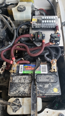

Did BIg 3. Getting less power.
Dom8706
Used 2 gauge AWG wire, 2 gauge AWG pure copper terminals and brass battery termianls
I did a replacement not an addition. Starter to positive, alternator to 100AMP breaker to positive, left white/tan wire to fuse box alone and just added it to positive as is. For the negative i did engine ground to negative and chassis to negative.
I have a little device that plugs into my cig lighter outlet that tells me the temp and the volts. Before hand i would stay around 13.8-14.0 most of the time and it was consistent while driving. When i first started it up after i installed everything it was at 14.0-14.1. I was happy and went on with my weekend. Now that ive actually drove it its dropped down to 13.8 and when i am at a stop it will drop to 13.5, maybe 13.4 if i have my blinker on.
Whats going on here? Does anyone have any ideas? I thought i did everything right. I also hooked up a additional fuse block for my accessories.

You know, it might be normal. You may have improved the alt/battery connection to the degree that it actually takes less voltage at the battery for the alt to think it is fully charged. Ignore that silly device for this purpose and take your readings directly at the battery with a real voltmeter before you go fixing what ain't broke.
Also check your Alt-S fuse and the condition of the wires at the oval plug on the alt., especially the white one.

Battery looks like the smaller size. Seeing the original battery clamp hanging there looks odd.
