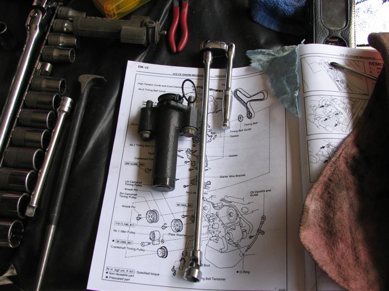

You don't have to touch the a/c bracket unless you really want to. Use a 1/4 ratchet and extensions topped with a wobble socket and you're golden.
I knew you were the original poster of that tool, but thanks for saying it. I was going to suggest the wobble socket if you didnt.
