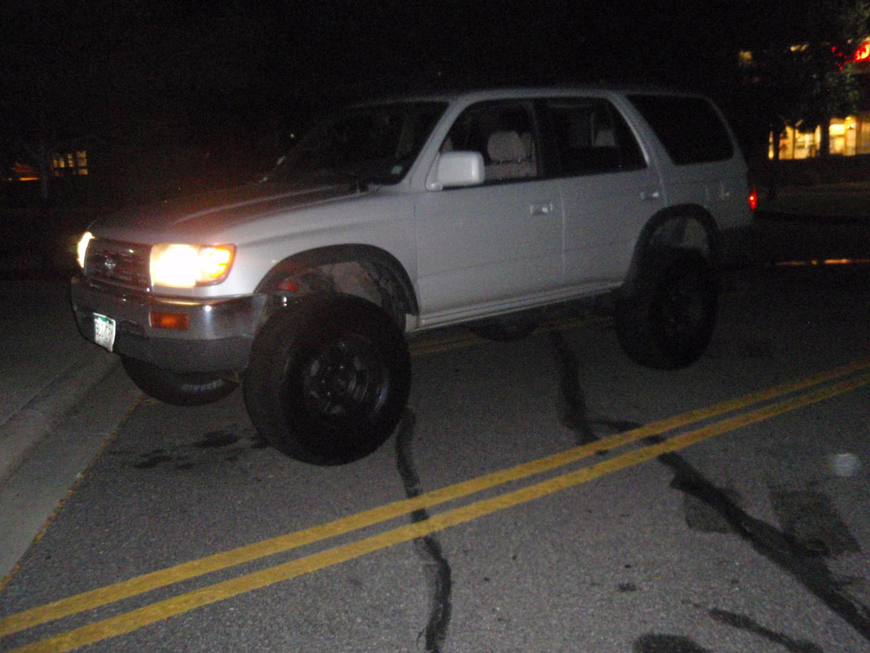

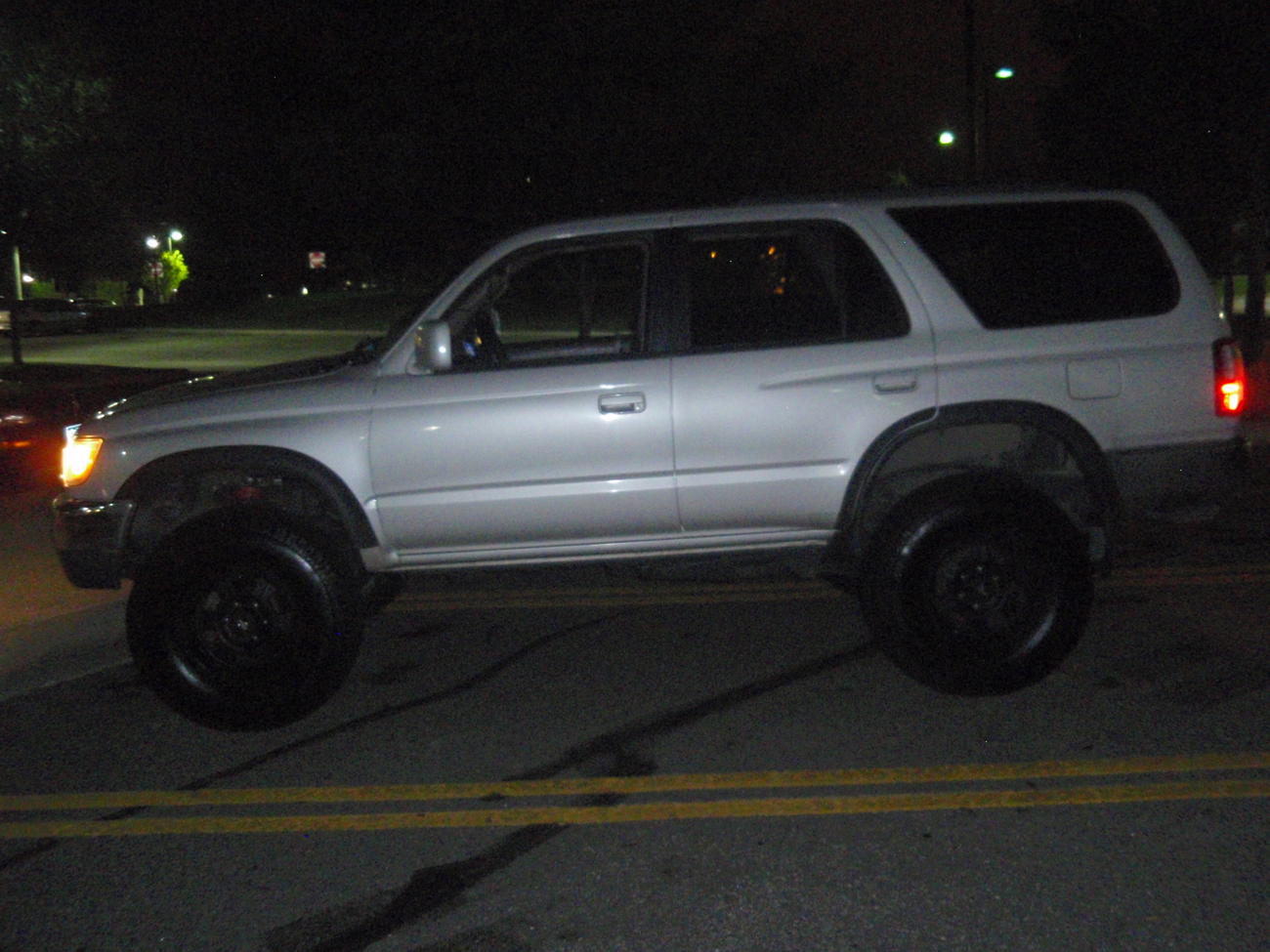

Well, got the LC Coils on just in time for vacation.
Long day, but it looks awesome! Once I get my Toytec Coilovers, Ill put the front up a bit higher, but I like the rake...

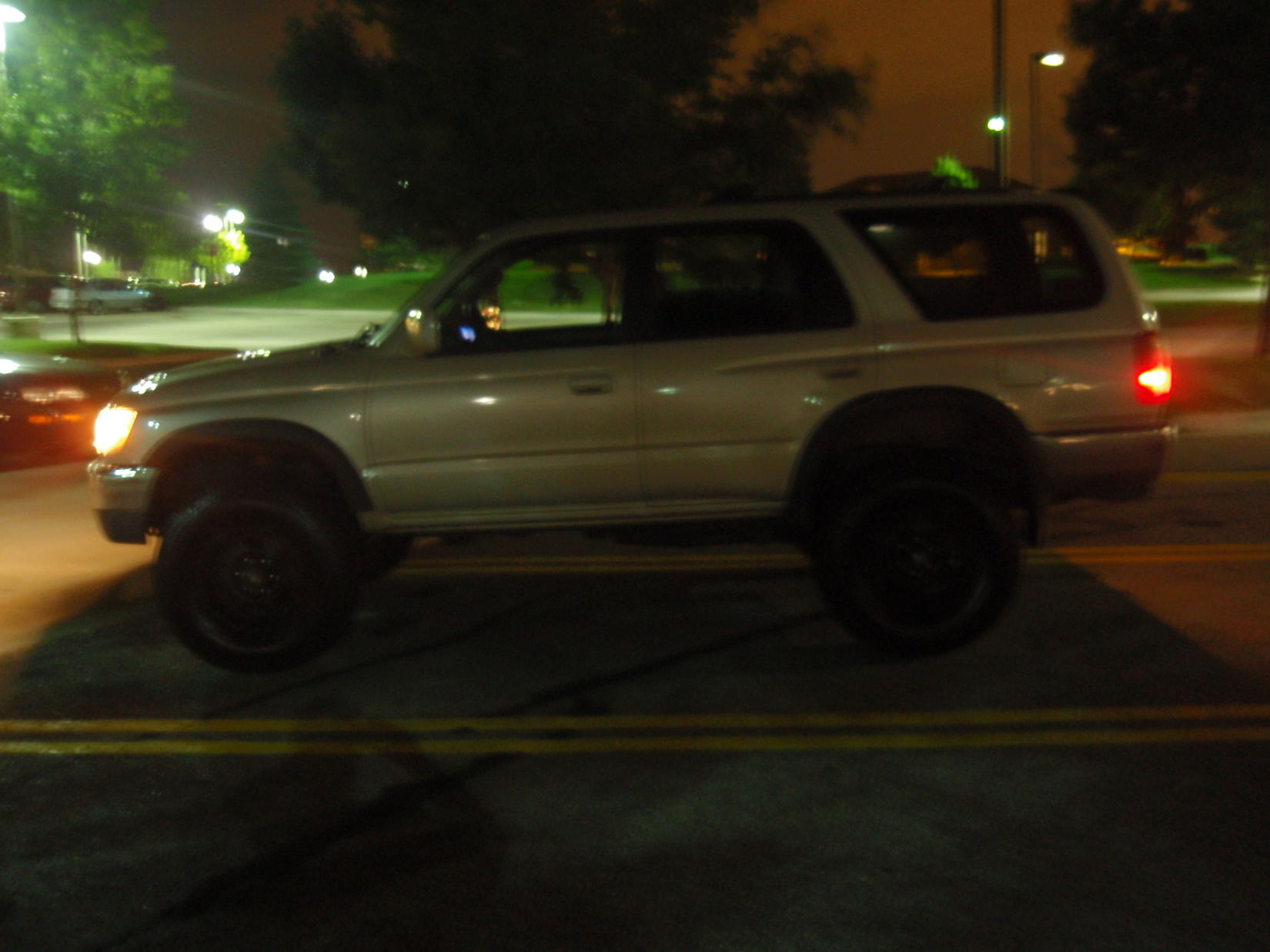

ok, here are a few more pics...
Im horrible at this photography thing...
one of them is a little blurry, I used the night scene function on my camera and I think it looks cool

i would leave the front the way it is...that's the PERFECT amount of rake
Im thinking maybe a half inch or so up in the front...

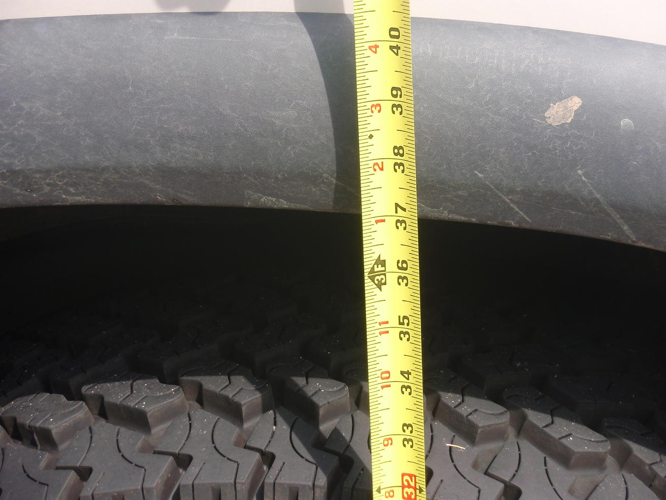

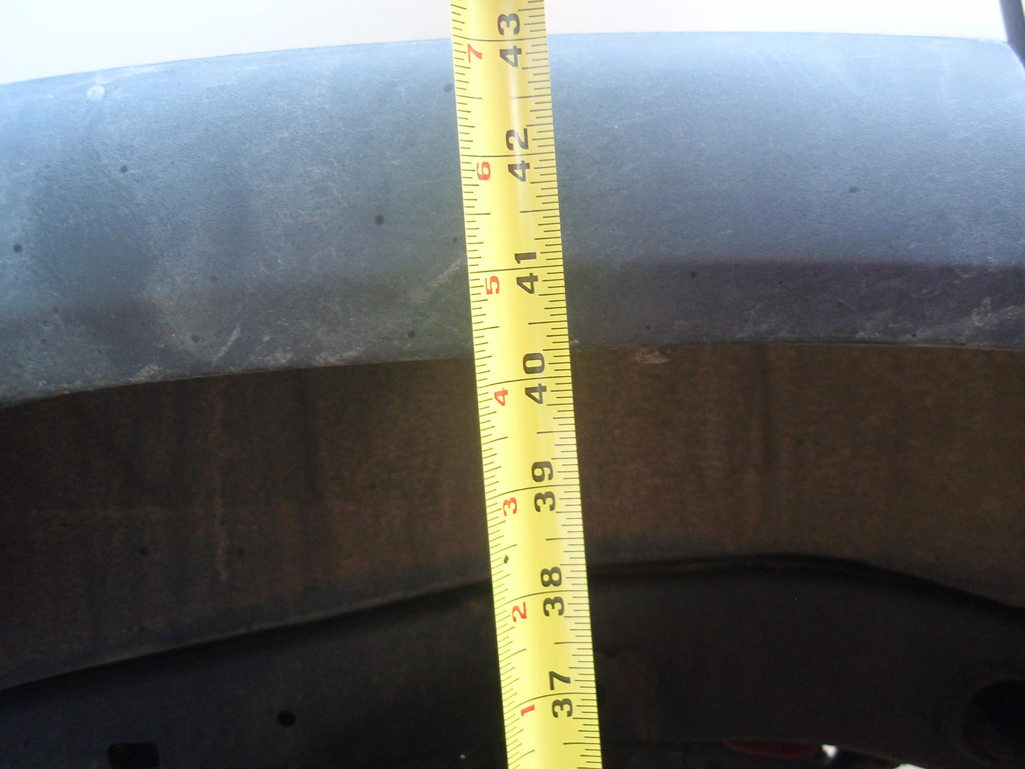

what were the stock heights to the wheel well?
the front came up about 3/4 inch after I replaced the back coils... the factory coils I had were that low...
think about it... the LC coils were about an 1/8 of an inch taller than the factory coils on top of the skyjacker spacers... yet my coils, (which I found out were put in at 80k and im at 186k now) packed in so much that when I put the new ones in I get ANOTHER 3 inches!! now that will settle a bit, but still... thats crazy

For the night shot, you need a tripod or at least something to rest the camera on.
as far as the truck, i'll bet that would be about perfect w/ some gear loaded in it. A bit more rake than i would probably want on a regular basis though. Oh and don't forget to adjust your headlights up a bit to compensate for the rake that way you can still see at night.
Wow. That is a lot of rake. I don't like it, but it's your 4runner.
it has settled just a tad since the pic, but I think my angle was bad on that one, made it look like more rake than it is

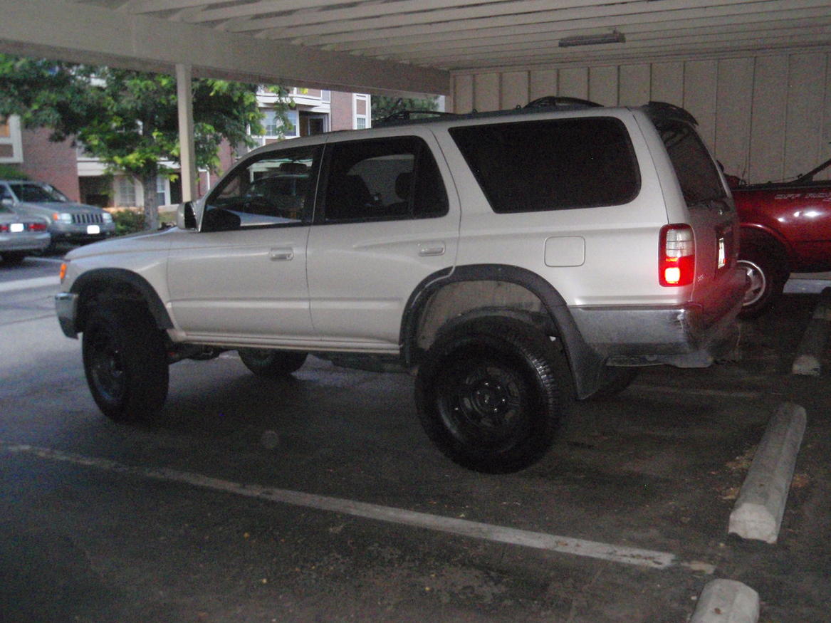

Yeah, I like it! I do want to bring the front up a teeny bit once I get my coilovers,
its settled a bit since those pics but still really sharp, ill get some more pics once I get the Toytec coilovers Installed...
