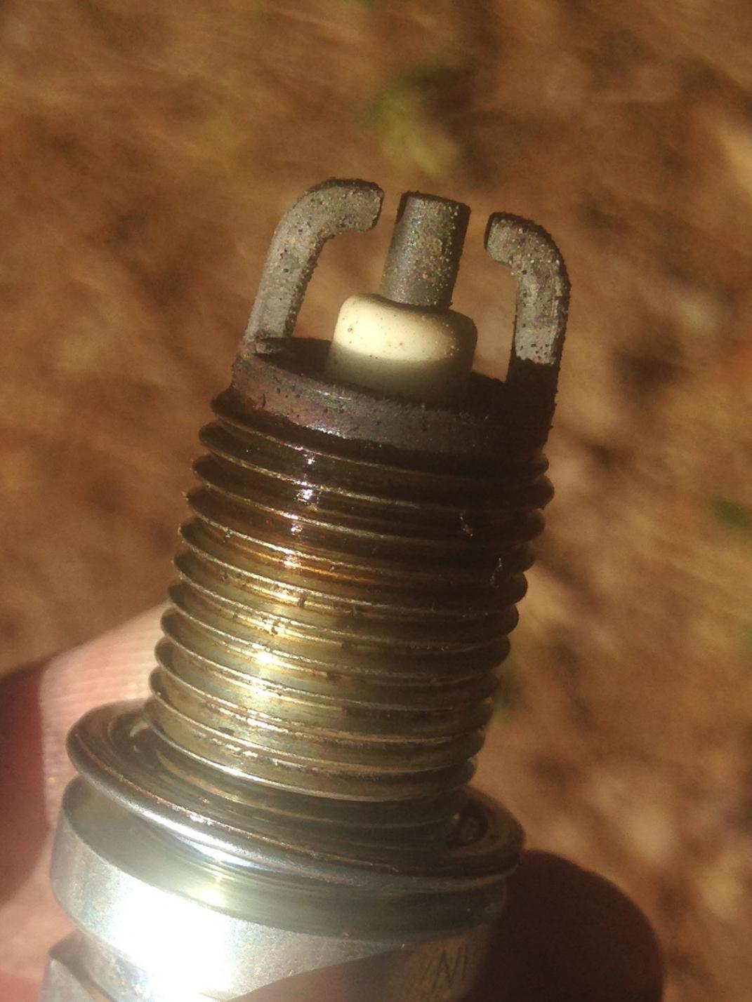

OK so I hand-turned the engine for a while today trying to figure out where it's coming from. I took the AC belt off, nothing changed. I stopped the PS pulley and cooling fan pulley, nothing changed. Didn't stop the alternator, I know it wasn't coming from that. It sounded like it was coming from down near the crank pulley. I think inside the engine. It's hard to tell. I put the spark plugs in and tried to crank it again. Same thing, just a loud wining noise from the unresponsive engine and starter, except this time there was no smoke! Hopefully that's a good thing. I took a video but i can't figure out how to upload it.

Not really. They're pretty grimy.
Im not an expert on head gaskets yet (luckily :pray: ) But the rust coloring around the base of the plugs is slightly concerning, as well as the gritty debris. You don't have classic white ash colored tips though that would be indicative of head gasket failure.
This might be a dumb question but did you clean the spark plugs? You can use a wire brush, they are not that delicate. You might just not be getting enough spark to get it turned over. Of course a compression test would also be a good idea I think most auto parts stores will lend you a compression gauge for free.

I have no idea why those spark plugs have debris on them but I can't imagine a healthy engine ever doing that.
Grinding/clicking on the crankshaft is never a good thing either... I'm out of suggestions on how to get it fired up again, if it's even possible.
