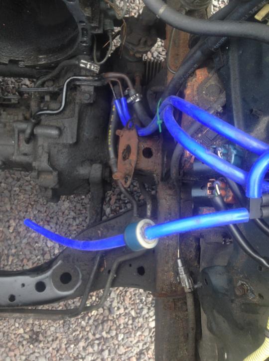

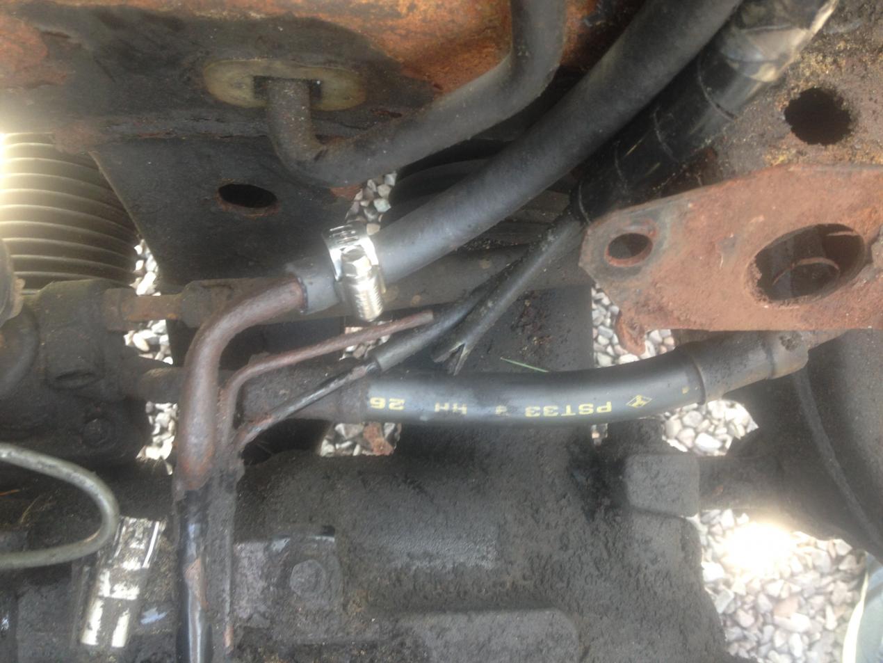

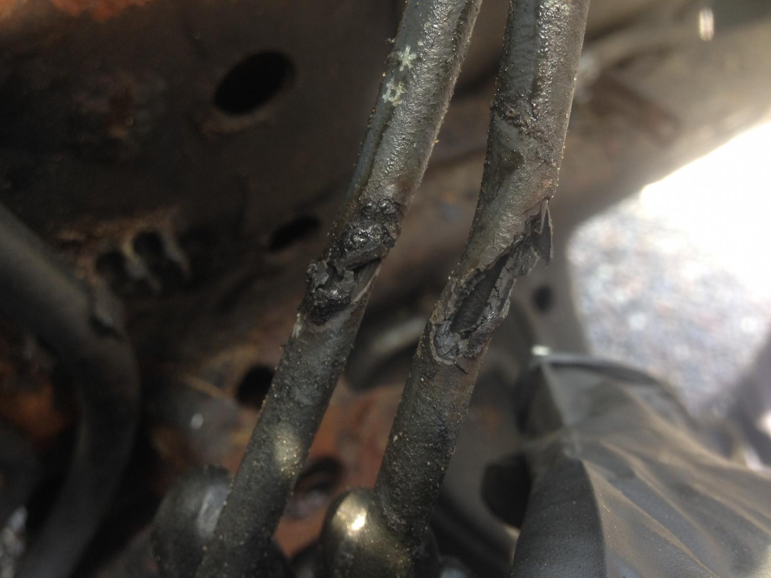

Also while i was extending/replacing the front diff breather, I figured out why my 4wd isn't working! I was a little depressed last time i went wheeling and realized the front wheels weren't turning. :cry2: Make sure these vacuum lines aren't touching the header or they will melt!!!
Ahh, much better. I'm wondering why I didn't replace these before. 20 year old vacuum hose is fragile.
