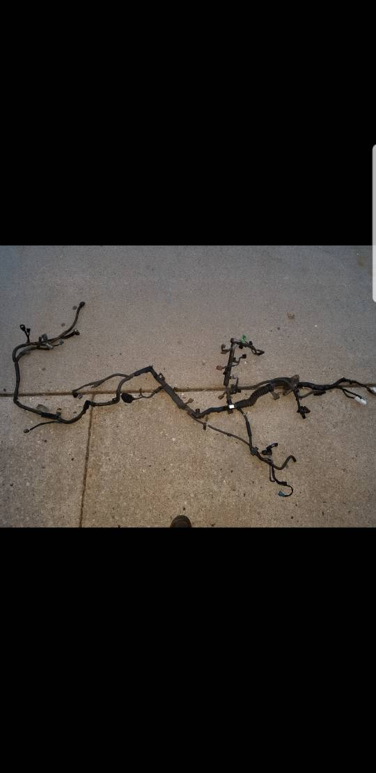

Yo fellas sorry to leave you hanging. I decided to attempt an engine replacement since the old engine is most likely hydrolocked. I had to work for a while to save up enough money and time and now i'm taking a week off work to complete it. I got an engine from a wrecked auto '00 4runner with 115k miles for $1100. Found it at a salvage yard that has really exceptional google reviews. I've already got the engine out and replaced the rear main seal, oil cooler hoses and pilot bearing. I'm also going to replace the oil cooler O ring and engine mounts. The valve cover gaskets aren't leaking at all so thats good. I'm just not very confident about the wiring since the new engine is from an auto and I have a manual. I know a lot of people have done 5 speed swaps so if any of you have any pointers it would be awesome because i'm pretty clueless. Will I have to put all the wiring from the manual onto the auto? or can I modify the wiring harnesses somehow?
You are going to use the wiring harness from your manual. Whatever harness that came with the auto you'll need to completely disconnect and set aside, they are not the same so not interchangable. You'll also want to keep any parts that are different off your old engine, such as the throttle body and move them over to the donor engine. I can't think of any other differences off the top of my head but there might be more than that.
It's worth fitting up the entire engine harness before putting the new engine in just to make sure it all fits and matches. Then you just feed the engine harness through your firewall and hook it up to your ECU. Toyota was smart and if the connector doesn't fit, the part is not compatible with that harness.
Pretty much what gamefreak said.
You'll just need to take the engine harness off your bad engine and swap it over to your new engine (plus the throttle body). Every connector on the engine side should be identical.
I swapped a 99 engine into my 97 so I've been down this road before. Granted it was an auto to auto swap but that shouldn't matter other than the throttle body (auto has a kick down cable for the tranny). It took maybe an hour to swap the harness over and wasn't difficult at all.
So the whole harness includes the transmission plugs and diagnostics port right? Will i have to take the intake manifold off? i don't see how i can get the whole harness off without taking it off
Yes, the entire engine harness must come off, it goes through the firewall on the passenger side. I would unbolt the ECM first and unplug all of the connectors, especially if you are not sure which ones are for the engine harness. Then remove the two bolts that hold the engine harness grommet to the firewall. You can then gently pull the harness out through the firewall. Once that is done, you can start removing all of the plugs/connectors on the engine.
You'll need to remove the upper/lower intake manifolds to get the harness off. Just be careful that you have everything unplugged before you go yanking on it and break something. Trust me, it's not nearly as bad as it looks.
I had both engines on stands so it was super easy.
It will look like this when it's out.
