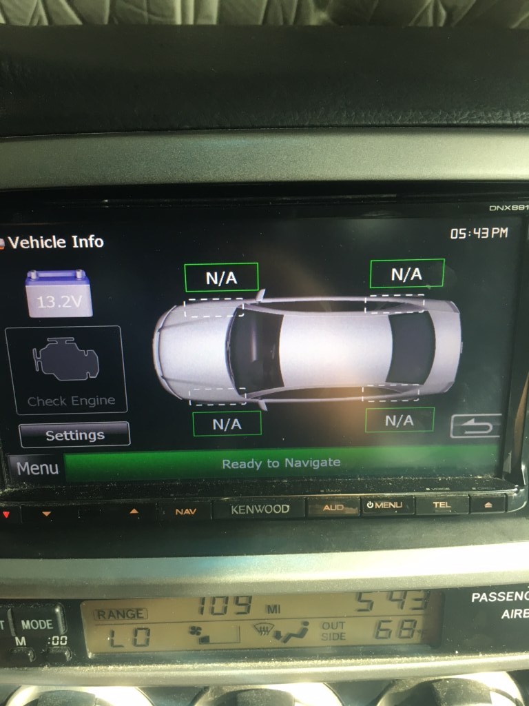

I have a 2005 Sport that needs a TPMS control module/receiver update. I have found a control module on ebay for $53 but need the receiver as well. I need a unit that is 2006-2009. My current unit only sends a "tire psi good or tire psi bad" signal information to the Maestro RR because that is how it was built in the early years. Once TPMS was standardized, the units now send tire pressure psi, and tire temp info to the computer. I've looked at the TPMS disable thread and it looks like it has the same connection from 2004-2009. I know I'll have to have the tires reset and paired with the new unit. I bought all new OEM sensors last year. Thanks for any help.

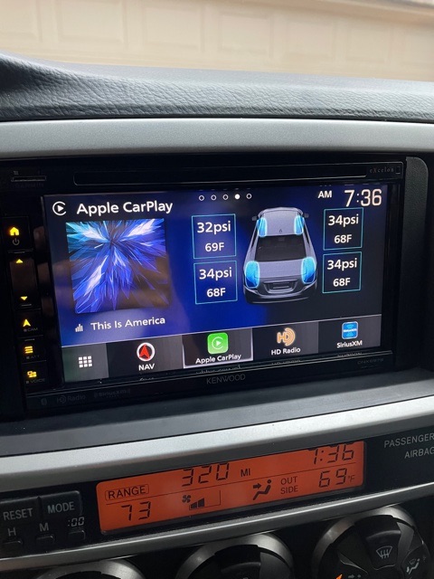

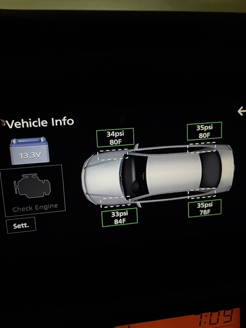

One issue I had when I switched out the unit was my steering control buttons would not work. I looked up the 697S on the Maestro website and it was not compatible with my Maestro. So, I had to buy a new Maestro RR module. Once I bought the updated Maestro unit(which has 2xCAN), flashed it with my HU and installed it, I immediately got TPMS readings which show the actual pressure and temp of the tire. I'm very happy with the new unit.

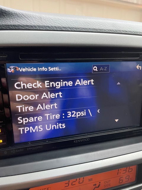

[MENTION=149207]AuSeeker[/MENTION] The Maestro displays the spare tire psi in a menu that is a tucked away. The Maestro unit that I had was a 2014 module. Luckily, all I had to do was unplug the old unit and plug the new unit in. I had a shop wire it up when I had the 1st Kenwood HU installed. If you have TPMS in your 2004, it should be able to work with an updated Maestro RR unit. The one I got has a manufacture date of 9/17/2019. The old unit was produced in 2014. I think the mean difference is that the new unit has 2xCAN bus. Hope this helps. I've included some more pictures because I like seeing pictures on posts:)

When I talked to Maestro tech support about the issue. They told me it was the tech that was sending the message to the Maestro unit. From my original post, you can see that the tires have a green square but no number. The maestro tech told me that back in the early days of TPMS, the unit would only send a single of 'green=good' red= bad"or...under the 28 or 29psi threshold.
