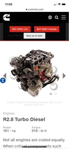

What about the crate cummins “ they put the sh** in everything”

The cummins option might be expensive but having a brand new motor with US support would be worth a lot. If you are serious about doing a diesel swap that is the direction I would suggest.

That cummins was put in quite a few rigs in the off-road mags. If there isn’t an adapter plate to put it infront of a 340f I’m pretty sure there are plates to use the AX15 or AW4 from a cherokee.
