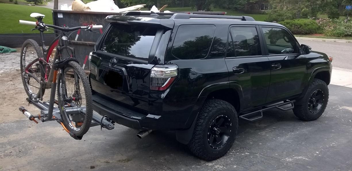

This week was 3M vinyl wrap on the roof rack. First time doing any wrapping and was pretty straight forward....just need patience. Turned out a bit better than I expected.
Next up is the lift or front/rear bumper covers. We'll see.

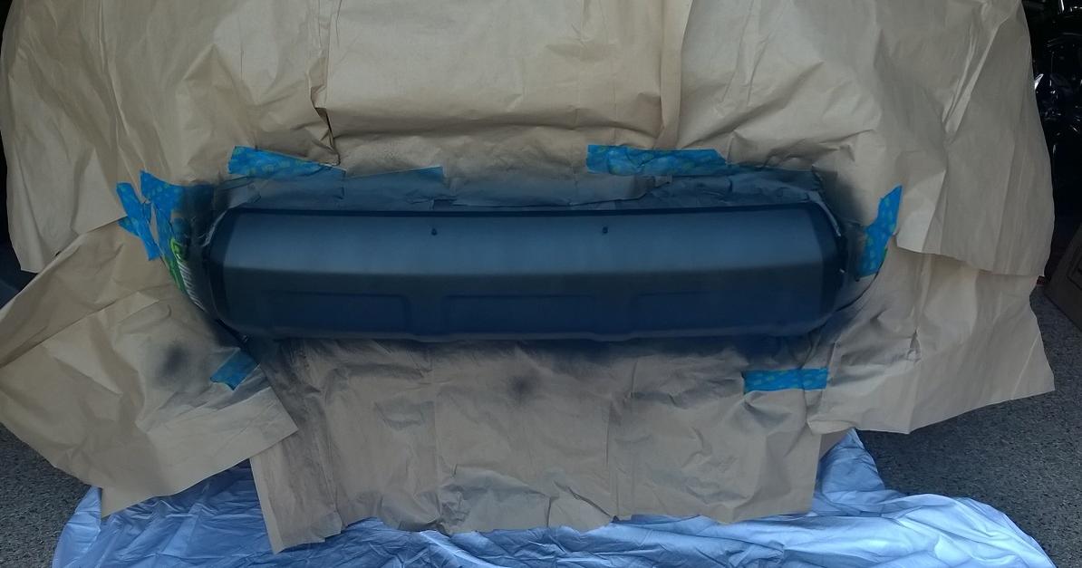

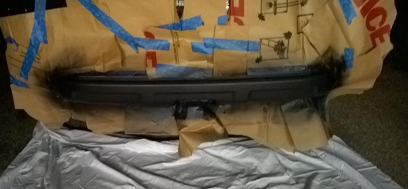

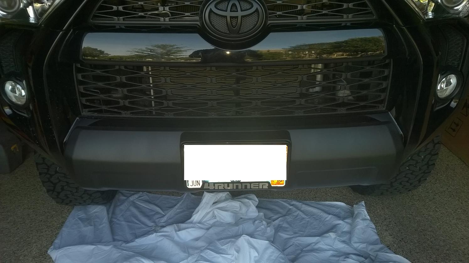

For the front valance panel and rear bumper covers, I ordered the black parts from TRD Pro Shop and they arrived quickly. That's when I went back and searched the threads on how to take off the silver pieces. While I'll tackle nearly any mechanical project, I thought it was a bit overkill for aesthetic reasons. Hats off to the guys who have done it...and got it back on straight, yet decided to take my first stab at PlastiDipping. I also didn't want to drive back/forth to the dealer for any broken clips.
So...here's the work. Turned out MUCH better than I thought. That afternoon, a lil old lady nubbed my rear bumper. No problem, I just gave it another spray.
The unexpected benefits of PlastiDipping the front/rear is easy/simple patch up work when an ass dings your bumper!
Sent the TRD Pro parts back today and saved myself $400.

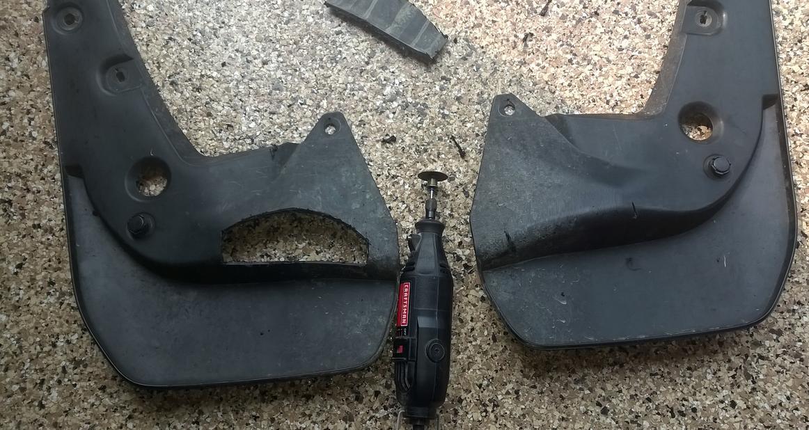

Wanted to keep using the mudflaps. Drove around for a few days to see where the tires were rubbing, then dremeled away. I need to take a bit more off the "upper" side.
I'll then find some sort of material (Gortex?) to cover up the hole while still fitting snug.
The first choice was to take the heat gun and re-shape, yet was too concerned about melting them. Might try to find a used pair on eBay and give my heat gun skillz some work though.
Anybody know of an aftermarket mudflap for the 4Runner?

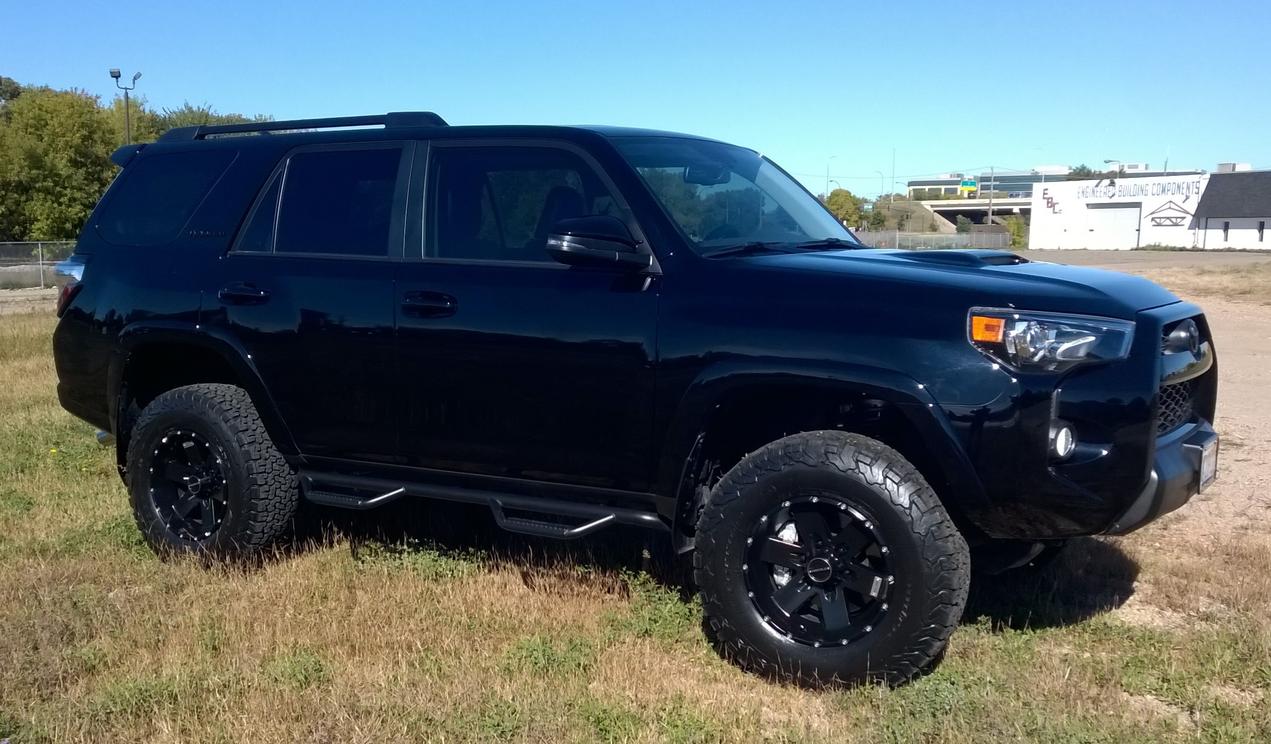

Here it is these days..
