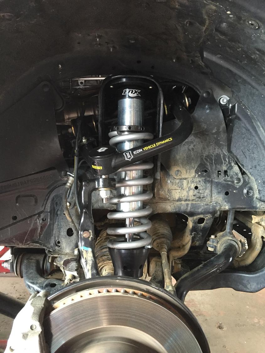

I have Fox 2.5 in the front and 2.0s in the rear with Icon tube UCAs in front. No Resi. I like the ride. Alot firmer than stock obviously but I can go faster over all of the things you mentioned: speed bumps, washboard, fire roads etc. I got mine from Auto Anything because they were offering 20% off their Fox Shocks which is why I went away from the Icon Shocks as well, couldn't get a good discount at the time I was looking to purchase, although if you shop around I'm sure you can find a great deal from anywhere. I've enjoyed every penny I've spent on my T4R 5th gen, I think the upgrades are definitely worth it. I've also put on SCS Ray10s and General Grabber AT2 285/70/17s. I lifted mine 3" front and 2" rear. Hope I've answered all your questions!

With that much thread I am surprised you only have 3" of lift
