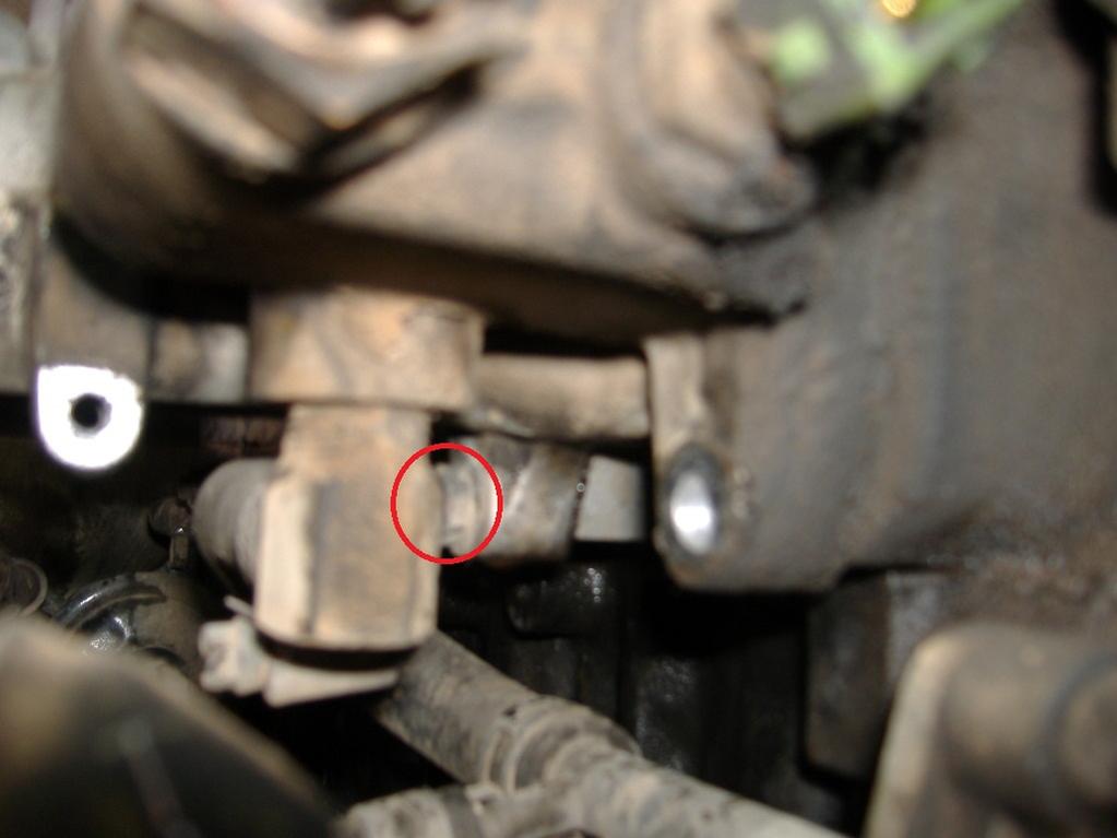

DSCF0038_zpscaedfc94.jpg~original
Which bolt am I missing? Don't tell me it's underneath at the firewall, or I'm going to go punch a nun in the face.

The last bolt you're missing is in your last pic. It's a pain to get to but it's right behind that 90* elbow that the coolant line goes to. You can see the head of the bolt in your last pic.
Whatinthhell is it doing right there? That's like a 1/2inch from the other one, what flippin' good is that doing besides driving me up a fricking wall???
Ok, thanks. Off to go wrestle another damned coolant line. Grr.

In addition to the one SV pointed out, it turns out there IS another one in the back, under the plenum. There's no way to get a socket on it. It took one of my neato little flexy-head ratcheting box ends to get to it - those things have got to be the best $40 I've ever spent on tools. No nun-punching required.
A trick I learned a while ago and forgot to use is to go buy a gasket, or find a picture of one on line. All the little holes tell you exactly where the bolts are. I spaced that until just now.
Okay, now what? It's still not loose. This damned thing needs to do what I tell it to do when I tell it to do it. :rant:
DSCF0042_zpsdd887212.jpg~original
ETA - Oh, the chain cover bolt. Dammit.
