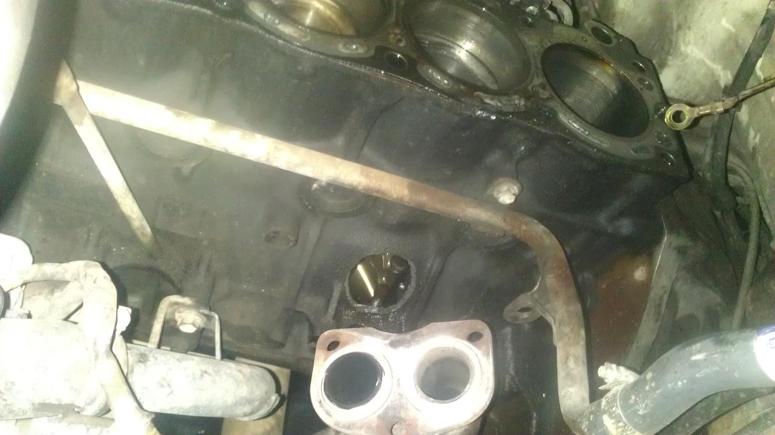

So, guess what I found.
IMAG0471_zps2e81d256.jpg~original
How did this not lead to me dumping oil all over the road?

3 is dry, with loose debris all over the surface of the piston. 4 has what looks and feels like coolant, and is filthy to boot, with caked-on muck.
At this point, coolant in your pistons will be normal. You have coolant routing through your block and head. When you pulled the head, some of the coolant will fall into the pistons. But that hole in your block... that's another story. Time for the motor swap :)
sorry to see that but that is what i was worried about. Window in the block is no bueno. But on the bright side now you can really do a swap and have more power. :flamethrwoer2:
