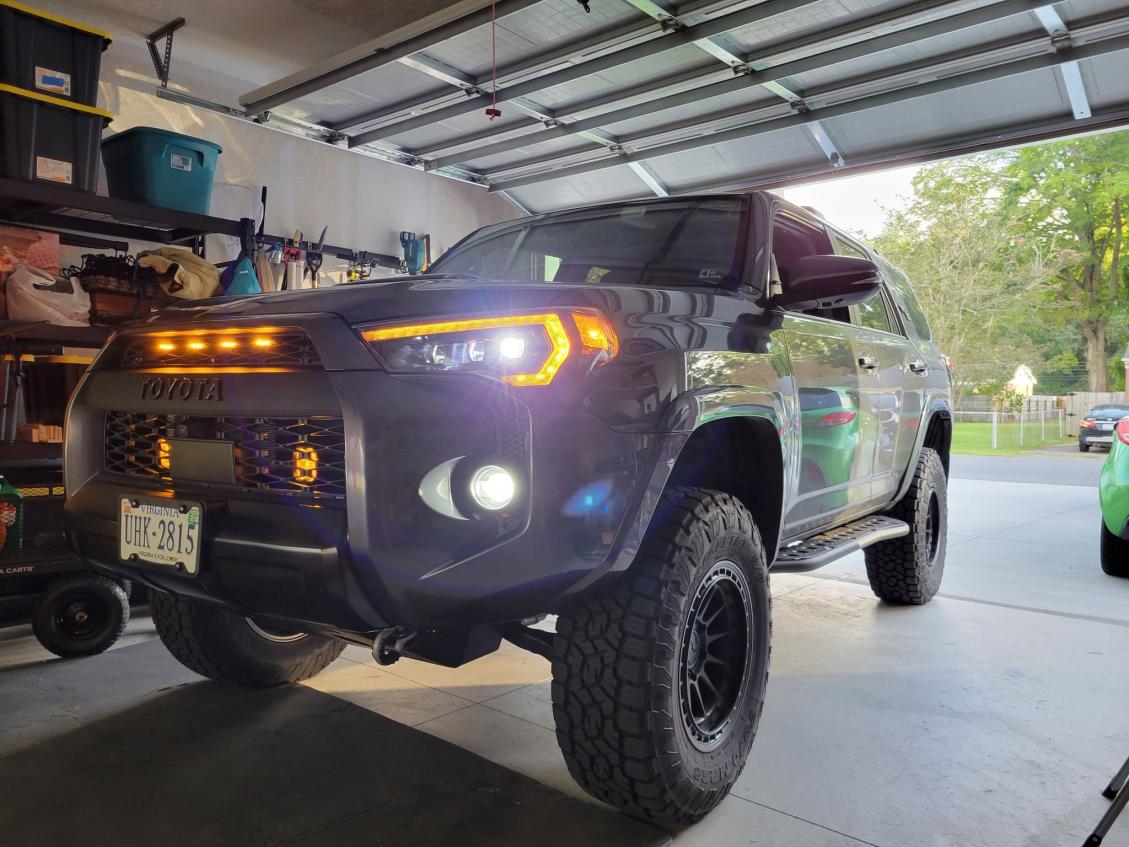

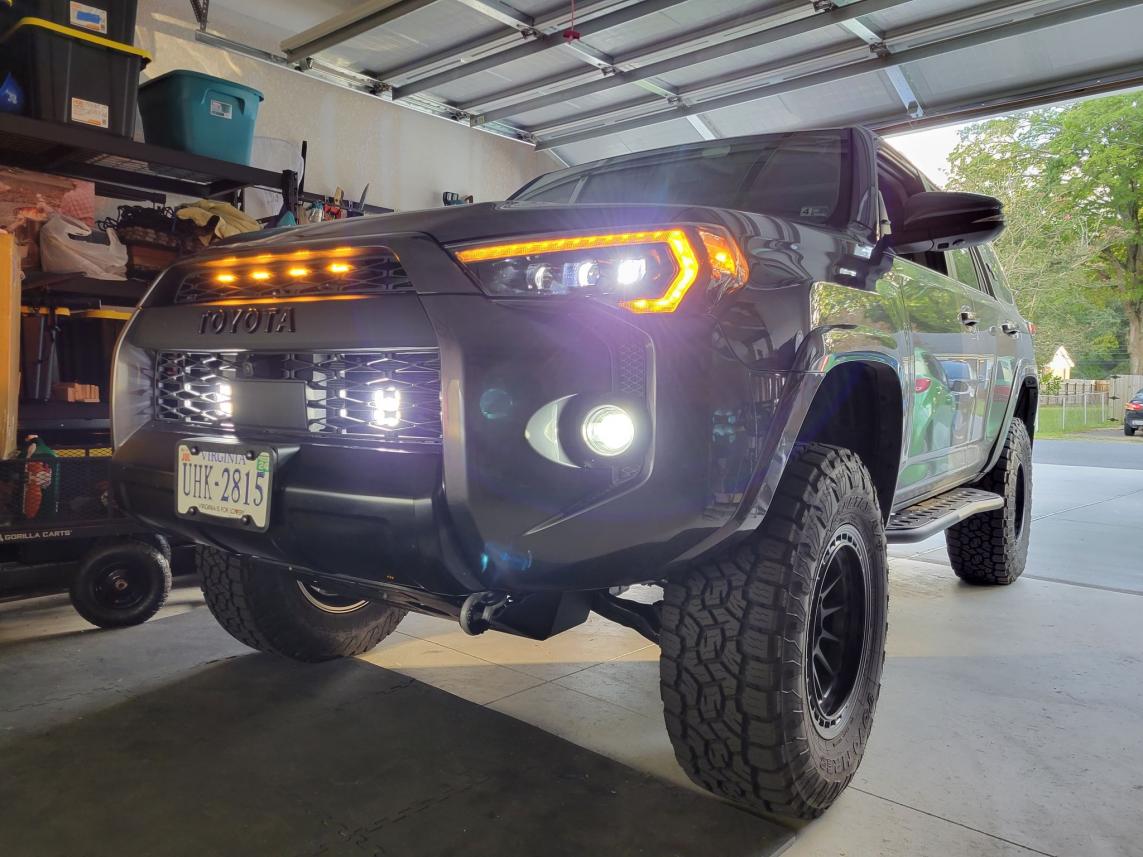

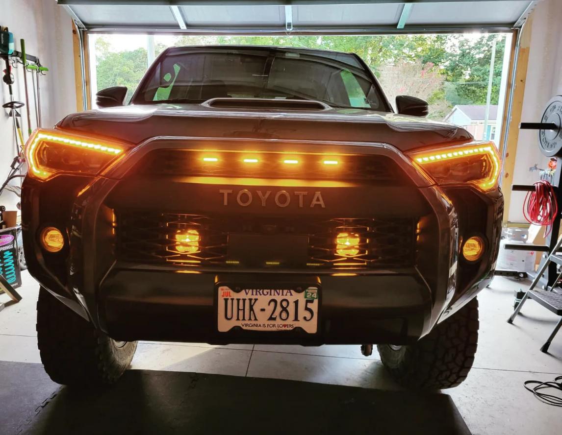

I had to do a bunch of research when I was installing my diodedynamics elite series fog lights with amber backlighting. I decided to buy SS3 pros to put behind my grille with a 3 way switch in the cabin. Tapped into the SS3 with the elite series foglights so I can control both with a flip of a switch.

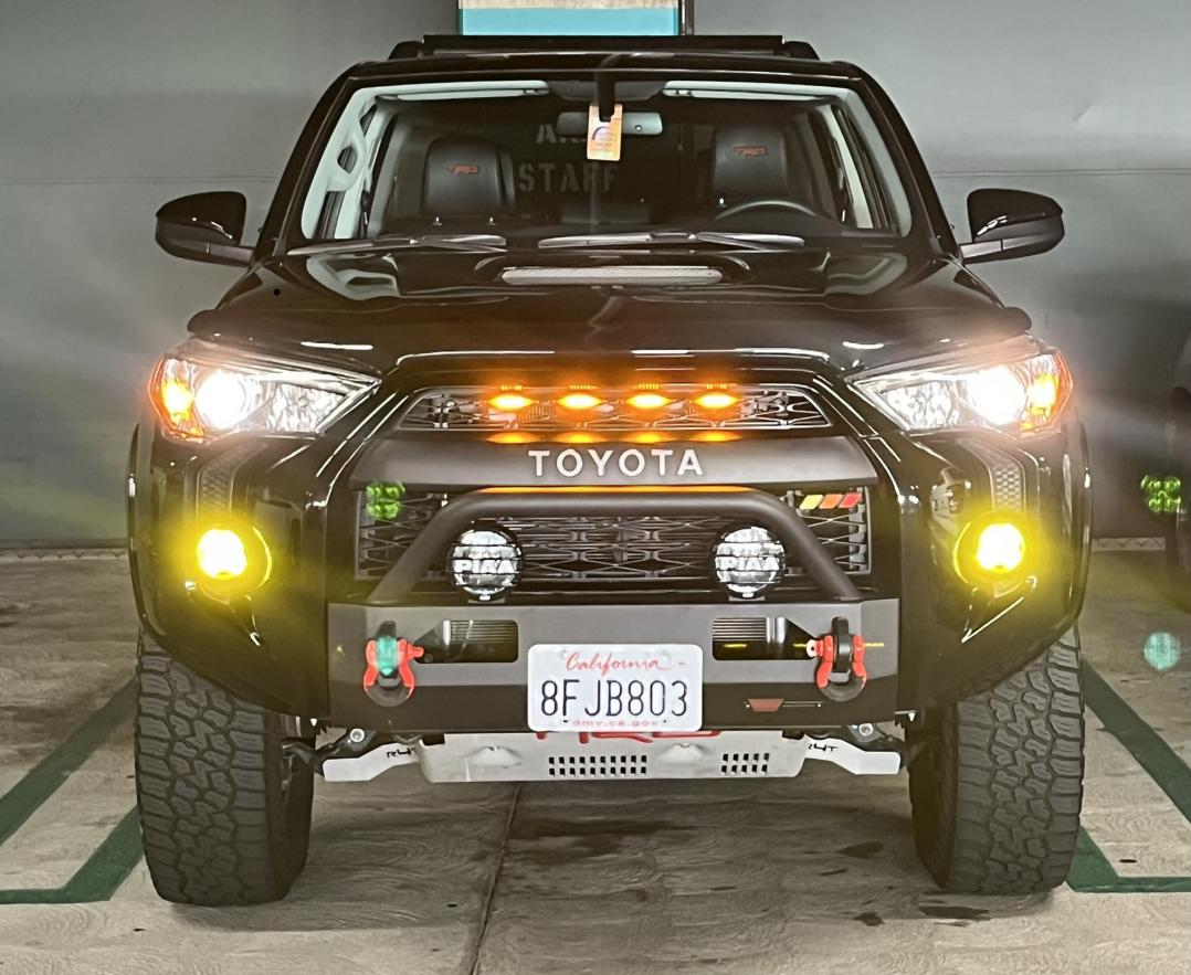

Got my DD SS3 Sports (no backlight) installed over a week ago, along with the 4raptor lights. They are hooked up to the auto headlight function, so they both come on automatically in low light and night conditions. Aimed properly, not getting flashed and they make a very nice difference at night. Very pleased. Thanks for your input.
