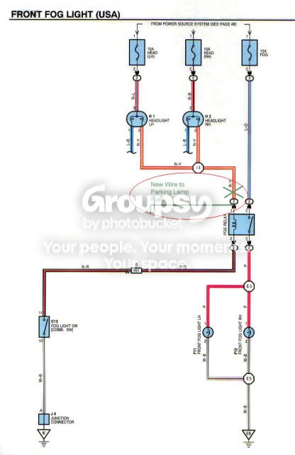

I finally did the fog light modification; I’ve wanted to do this for a while and I finally found the time. I have my Rigid Industries Dually D2’s wired to the factory fog light harness. As you all know the factory fog lights only work when the low beam headlights are on, they will not work with the running lights or the brights. I bought the amber colored D2’s for the extreme snowy conditions I live in (they also work great in dusty conditions), the amber color does not have the glare back that normal colored lights do. I wanted the option of running the D2’s with just the running lights, that way I don’t have the headlights creating glare back in white out conditions.
I saw Ripcord’s write up in his build thread, and I found a couple other write-ups on Yotatech.
http://www.toyota-4runner.org/3rd-g...unner-build-photo-timeline-23.html#post951268
Yotatech Article
2002 Toyota 4Runner: Fog Light Mod - YotaTech Forums
It seemed like a simple project, so I didn’t bother taking my camera to the shop. Once I tore into it I realized that the wiring was different, along with the fuse locations. For my 99’ Limited I had to cut the red wire w/ yellow tracer that goes to the fog light relay and soldier the relay side of that wire to the black tail light wire. It was still a simple project, but if I had my camera I would have snapped a couple pictures for you guys.
fog99schematic.jpg~original
More info can be found here, but instead of the jumper wire I hard wired it inside the fuse box like the above links.
Factory Fog Lamp Re-Wire Mod - 3rd Gen 4Runner - YotaTech Forums

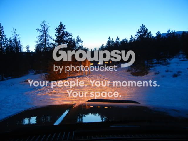

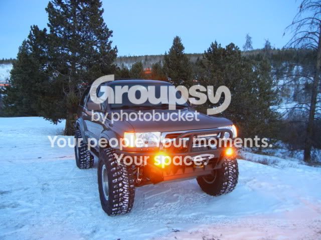

And here is the mandatory picture of the fog lights working independently of the low beams. I’ve been waiting to post pictures of all the lights in action until I got this project wrapped up, so I hope to have pictures and video of all the lights in action soon.

Awesome Dirtco! I've been waiting to see some output shots of the amber D2's. I am really interested to hear how they perform in the snowy weather.
Thanks! I plan on taking some better pictures and video of all the lights in action when I get some time. It's been a pretty lame winter, but I'll try to take some pictures, or video of the amber D2's compared to the headlights in the snow.
