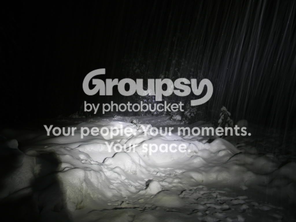

I would love to see some night shots in the snow with the blue filters. I went with the amber D2 lights in a driving light pattern mainly for snowy conditions, I aimed them low and use them when conditions get real bad.
I found these pictures a long time ago on Pirate (not my pictures), it's a comparison of white vs amber Rigid's in the snow. Notice in the first picture there is a bunch of glare back from the light, and with the amber color that pretty much goes away. I've found the same to be true in real world conditions, but I would like to see how blue compares.

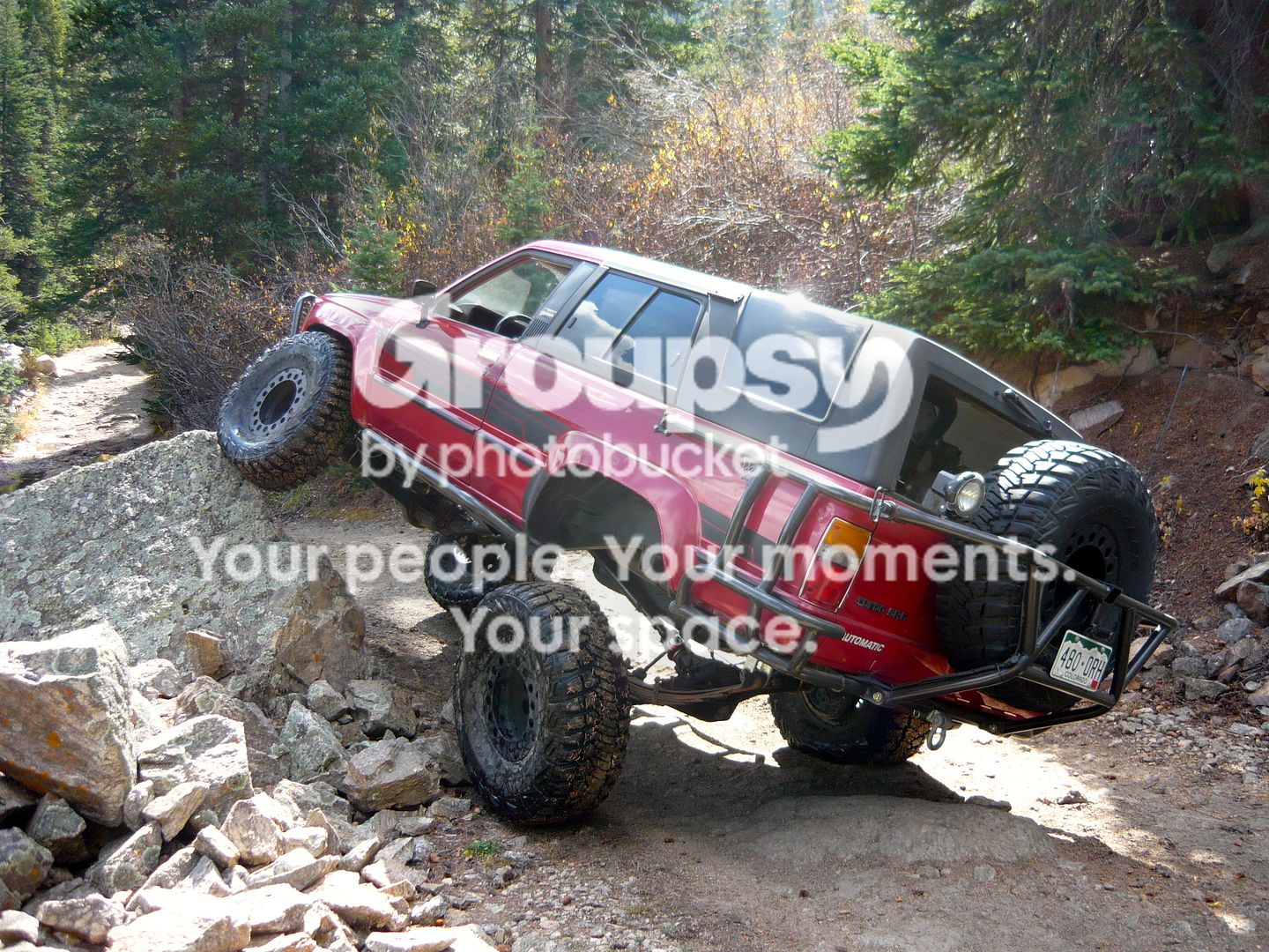

The number one priority of this project; is it’s got to be easy to get in the back of the 4Runner, period! I built a swing down carrier for the back of the Turbo 4Runner, and while it was stout, protective, and cool looking, it was also a nightmare to get in the back. Once or twice a day wasn’t bad, but multiple times on a long trip became frustrating.
Here is a picture of what I’m talking about.

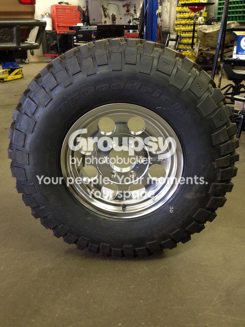

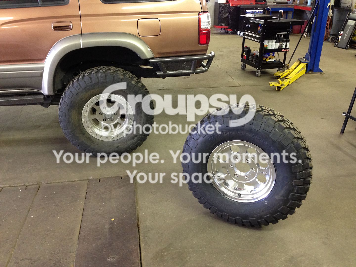

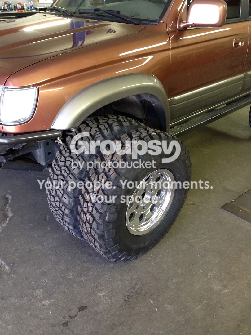

With that in mind I decided to not run a full 35x12.50; it’s heavy and hangs out past the 4Runner too much for something that I doubt I’ll ever use. So I looked around for “pizza cutters” and finally went with a 255/85R16 BFG Mud Terrain on a Mickey Thompson Classic III 16x7 wheel with around 3.5 backspacing.
At 60psi it’s a close match to the half worn BFG’s on the 4Runner (at 25 psi). In all reality no spare is going to be perfect match (unless you rotate), and I’ll adjust air pressure to compensate if necessary.

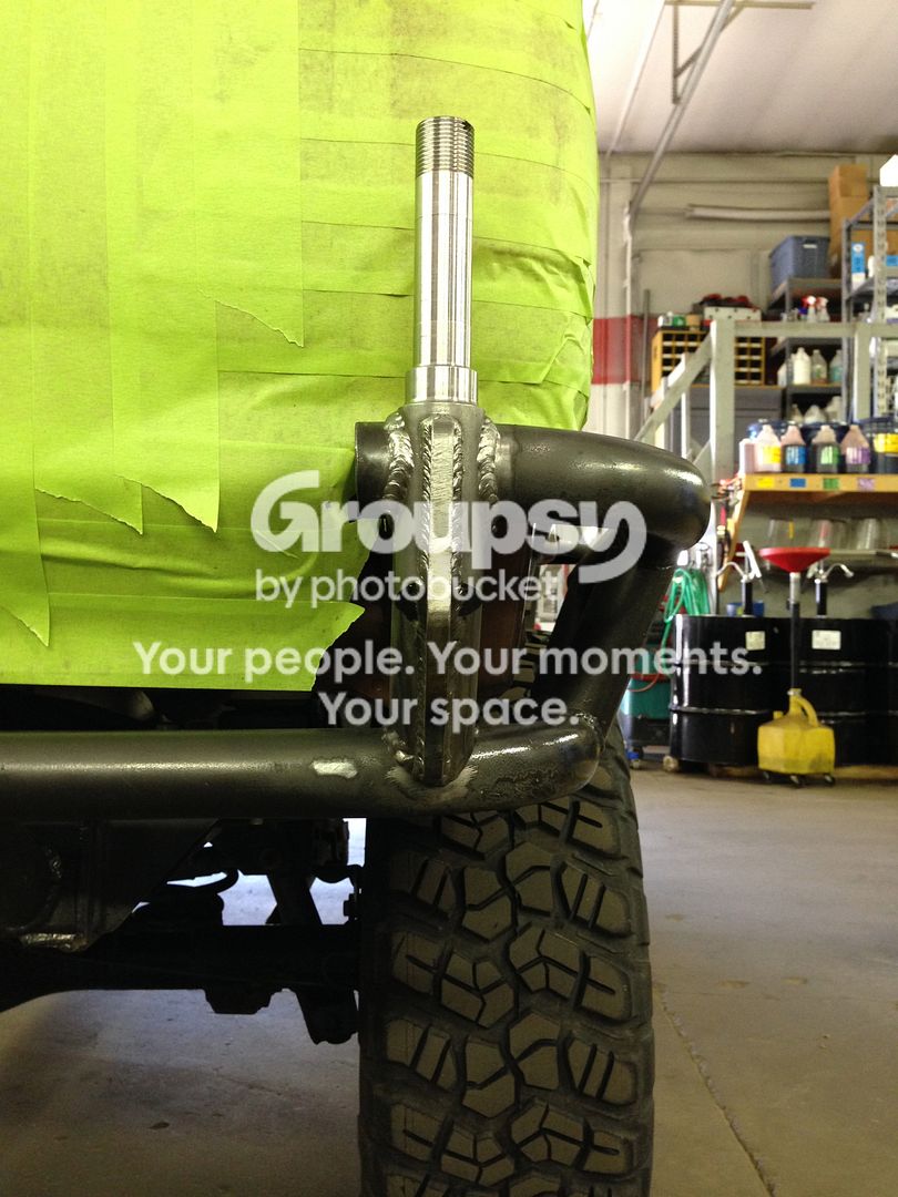

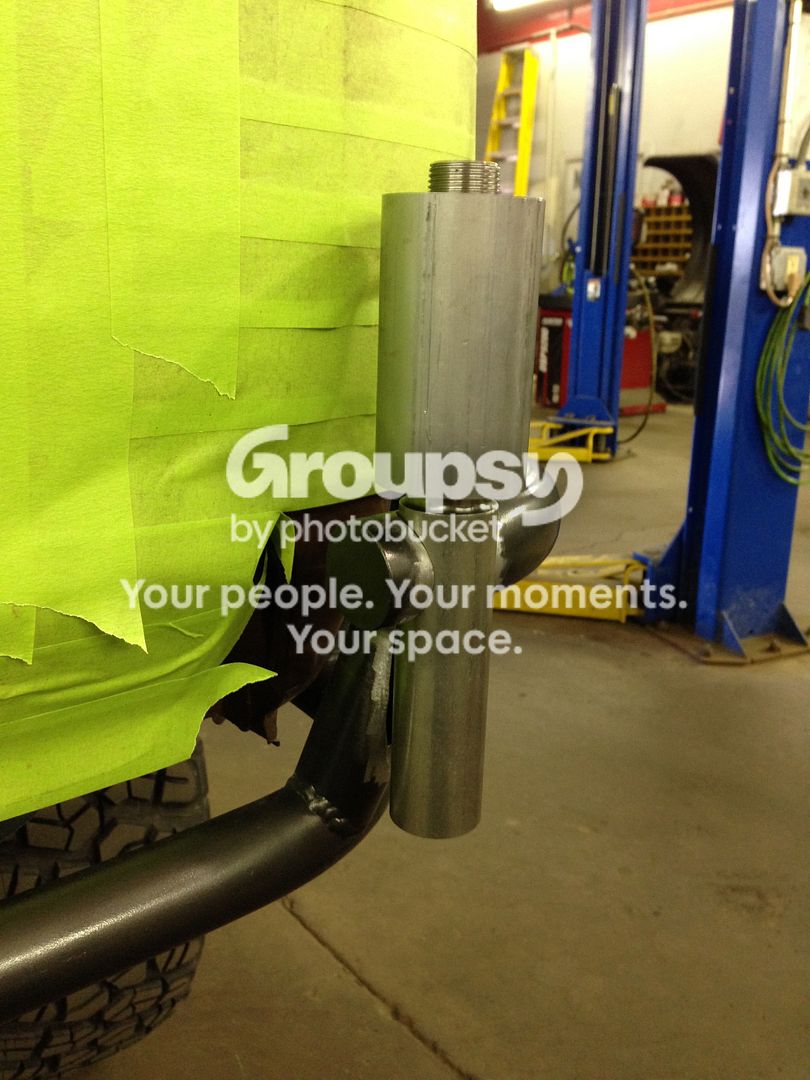

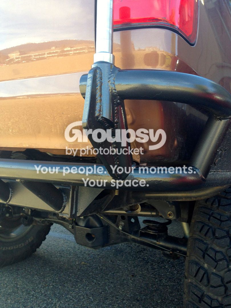

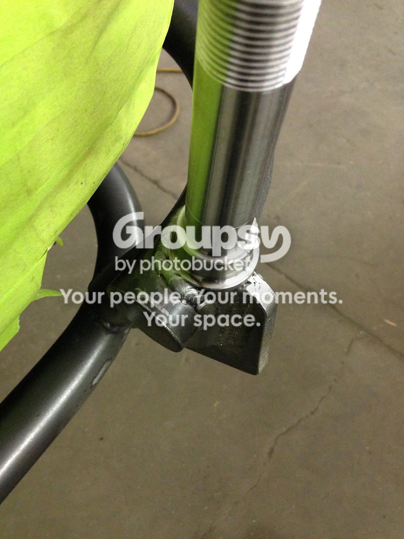

After a TON of time looking at different hinge options I went with a single sheer, trailer style spindle set up. Double sheer, and even hiem joints were considered, but it would have been complicated to make it work with my existing bumper and not kill my departure angle.

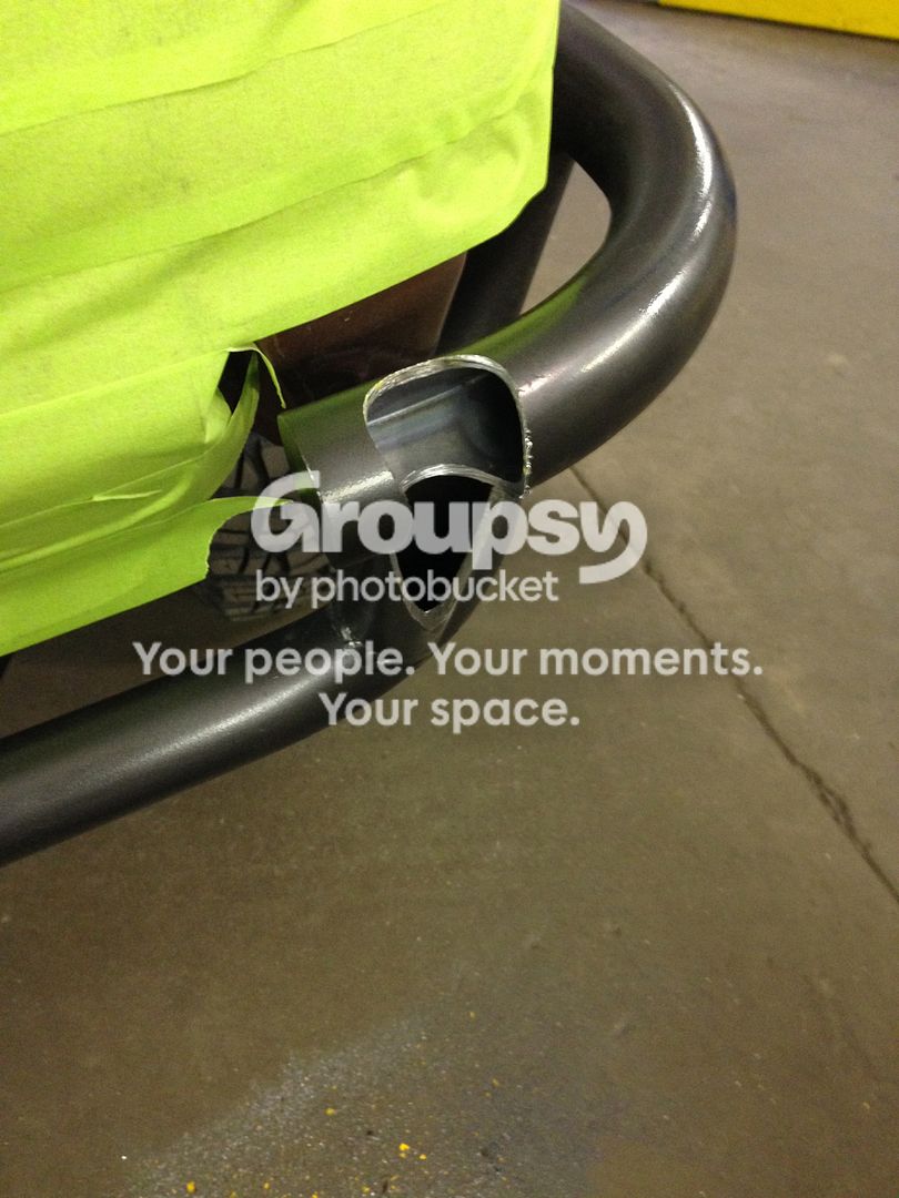

I used a 1.5” hole saw, and a cut off wheel to notch out the bumper.
Then I chopped the lower section down, and cut out a gusset from 3/8” plate (an old piece of my Marlin skid plate that was on the green 4Runner).

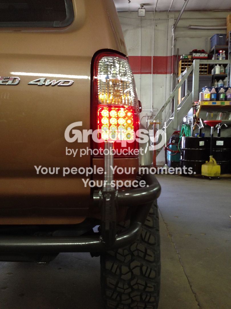

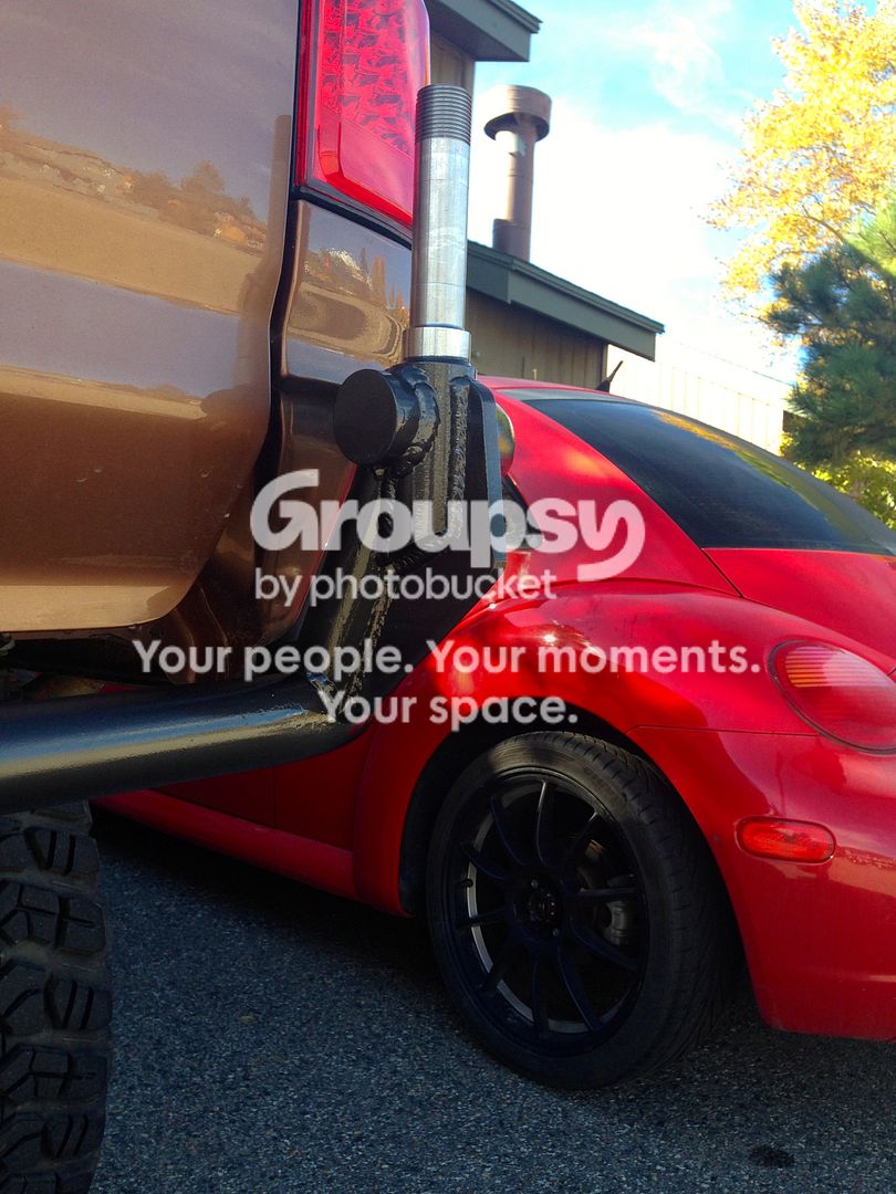

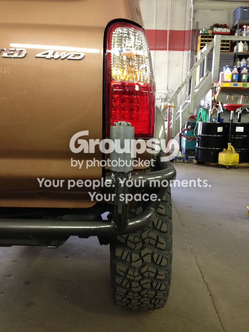

Tail light clearance; it only blocks the reflector and not the light. The dust cap might set just a little bit higher but I don’t see it blocking the light much.

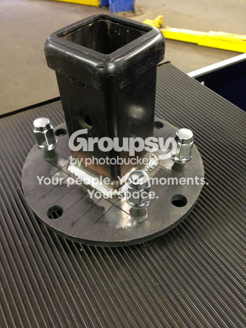

I bought a pre-fabbed wheel plate, but it came with multiple holes for other patterns and didn't look very good. So I filled all the holes except for the ones I would be using, and the holes for 8 lug wheels (you can't see them behind the wheel, and who know's if I'll go to one tons some day down the road). I also welded up a two inch receiver that I can use for multiple different things; I plan on having a mount for a 3 gallon Rotopax, possible snowboard carrier, and possible cargo carrier. The possibilities are really endless!
