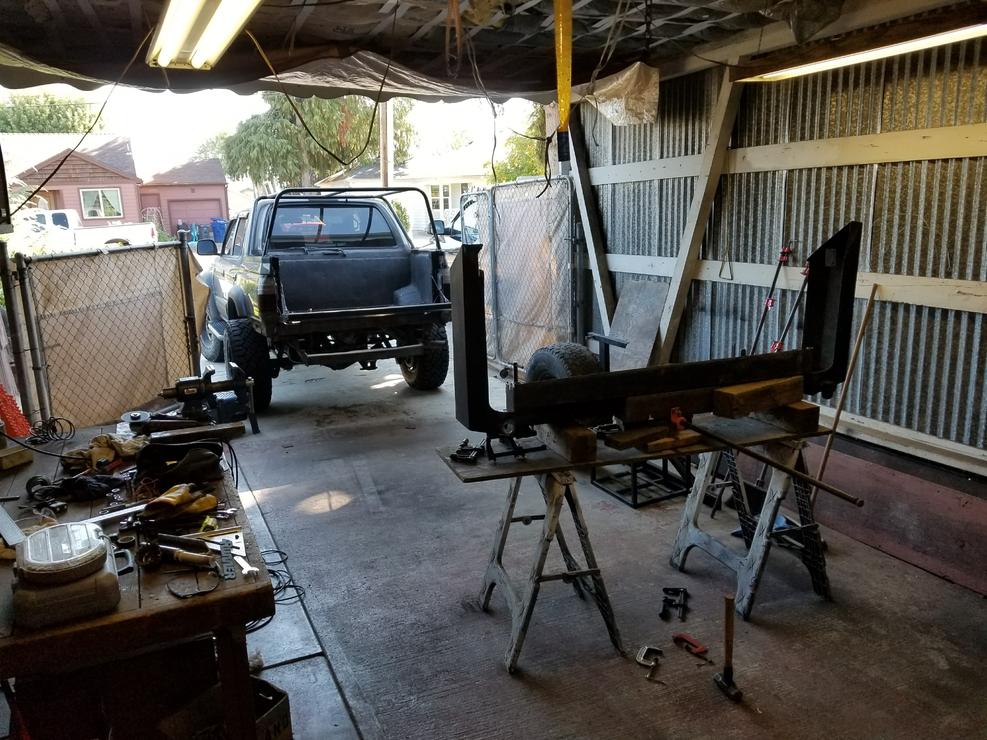

I drove for a while, taking in the scenery and the snow. I got out to take some more pictures and to my absolute disbelief the spare tire was missing, along with the carrier!!!
I never heard a thing, and it never touched or hit the rear hatch. I removed the interior rear view mirror a while back, so I couldn’t see the spare unless I totally turned around in my seat. I ended up driving almost a mile back up the trail to find it!

Whats left of the spindle that holds my spare tire carrier!
<a data-flickr-embed="true" href="https://www.flickr.com/photos/156493849@N03/37353641822/in/dateposted-public/" title="image1"><img src="https://farm5.staticflickr.com/4499/37353641822_67793d8b54_b.jpg" width="768" height="1024" alt="image1"></a><script async src="//embedr.flickr.com/assets/client-code.js" charset="utf-8"></script>
I could be wrong, but just judging by that picture, and that rust, it appears that the spindle might have suffered a crack some time ago and had been corroding with just that last little bit holding the line till it too failed. That sucks, what a PITA.
But hey... WAY better to happen on a trail than on the highway. Imagine what a CF that might have created. :faint2:
I can't believe I am already seeing snow pics, but, Winter is coming!
I agree it looks like there had been a crack there for awhile and it finally gave out. Looking back on your Moab trip video it looks like it was moving around a good deal so I wonder if it was cracked then. The only way I could see it cracking like that though is if you really tagged the rear tire coming down a rock face
The rust was from the snow on the drive home, it wasn't rusty when it broke. But I do agree with you, I think the smooth crack was a stress fracture and the rough break was from the carrier flexing back and forth afterwards (like bending a paper clip back and forth).
Yeah, there could have been far worse places to have it break!
It's always moved around a little bit, but that's mainly the rear frame flexing independently of the body (I really need to get some HD rear body mounts). I've never hit the carrier on a rock, so it would have to be some kind of a stress fracture. I was getting on it pretty good out at the sand dunes, so it's possible that started it? I guess at this point it really doesn't matter...
i wonder if adding the water jug, granted only about another 17 lbs was the proverbial straw.. glad you found it.
Looking forward to seeing what you come up with to fix it..something double shear?

Honestly, it was just a matter of time. When I built that spare tire carrier I had 35" tires, and a 255 spare on an aluminum wheel. Fast forward a couple years and I have a 36" Irok on a steel wheel that weights probably twice as much. Add a couple years of hard wheeling, the Rotopax, some sand dunes and boom!
Yes, I'm looking at a larger spindle and double shear. Unfortunately I'm going to have to rebuild the entire carrier too. I need the latch side to engage the bumper better and by the time I change both of those I'm better off starting from scratch.
