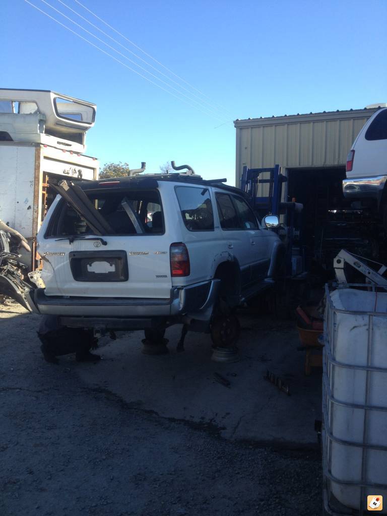

So today I went on a hunch to find a part. That hunch was dang right I tell you what!

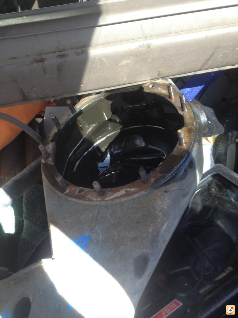

It was 4wd and elocked, don't mind if I do! Pulled this part off for very cheap
After I buy the differentials from an undisclosed source, I'll be a very happy wheeler.

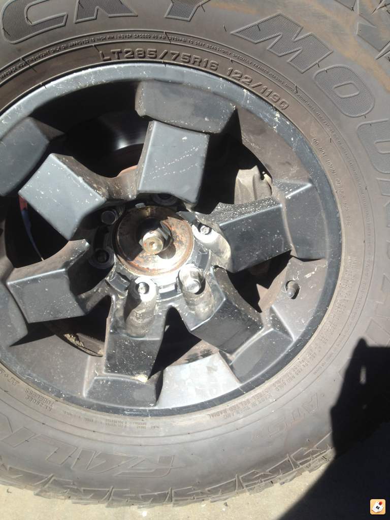

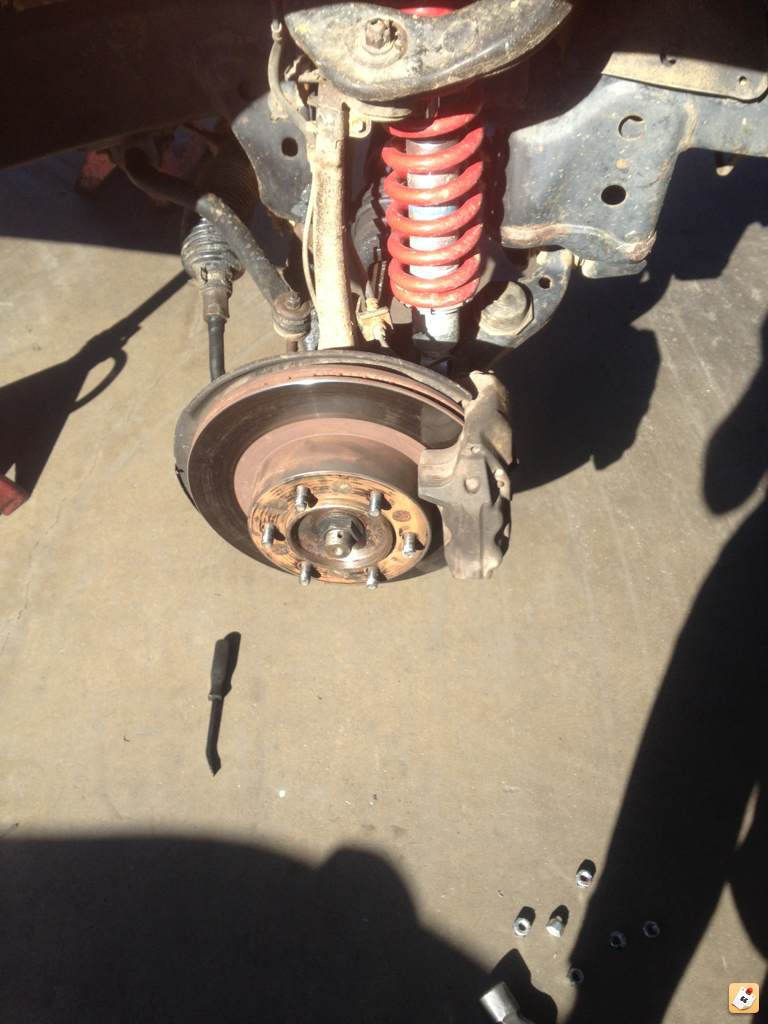

First what I did was take off the wheel of course
Took off the dust cover with the pry, and removed the cottor pin and whatever the thingie was that holds the nut. You're also going to need to take the four bolts out that holds the LBJ on.
After that I put the wheel back on along with some nuts and lowered the truck back down. To get the big nut off the wheel it is torqued down to some where in the 274ft-lbs area I'm pretty sure.
Like so.

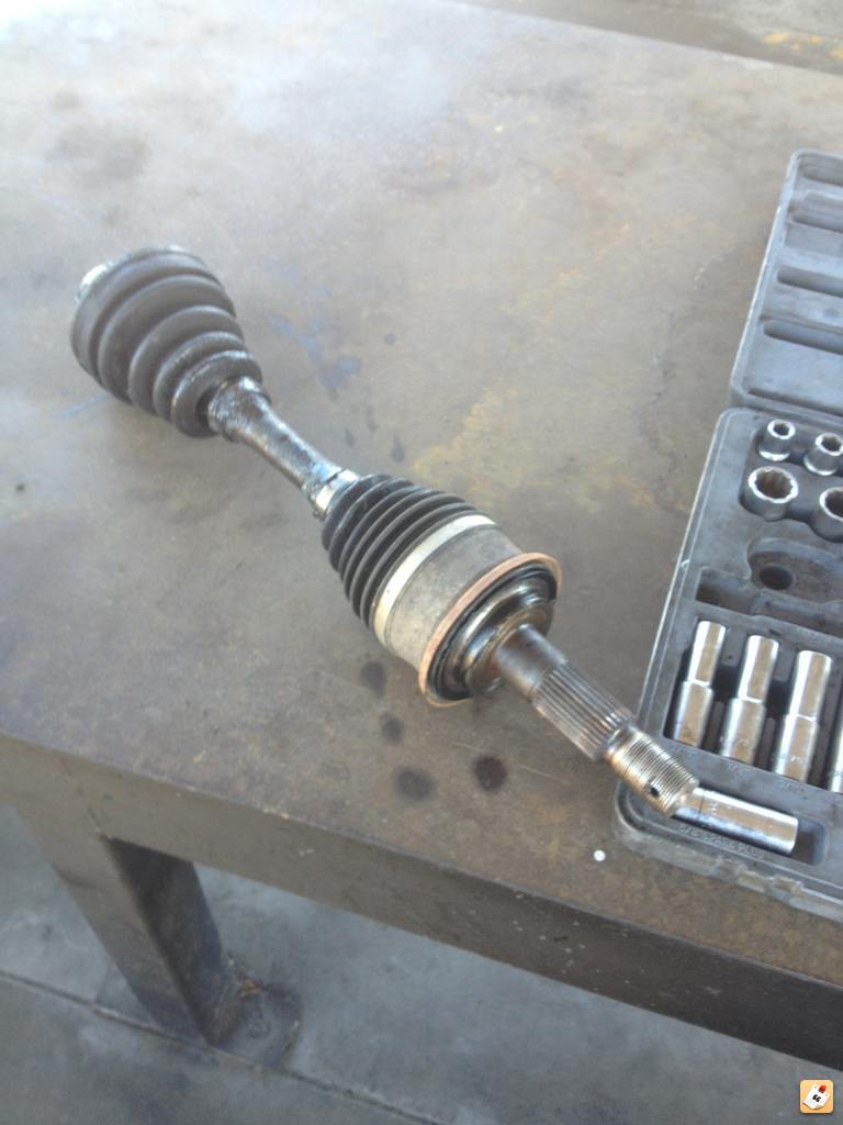

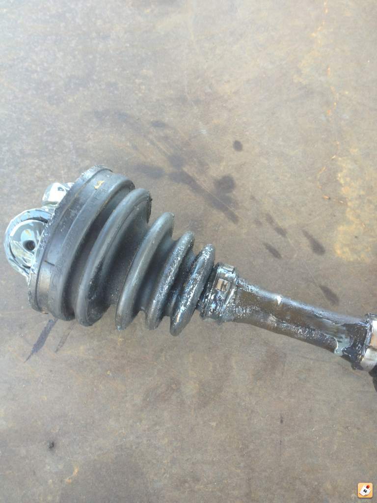

And I'm sure we all know the cv axle. Here is is with the split boot and leaky ends. It was time for some new boots anyways.

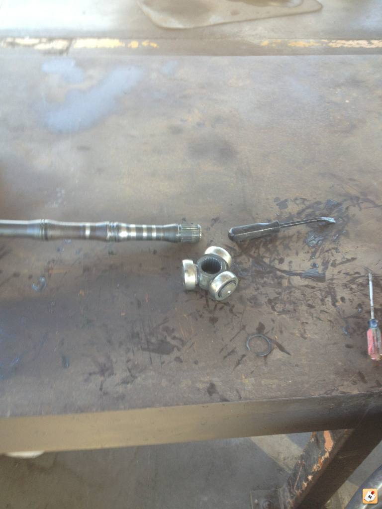

Now, the way you get the boots off with out cussing and throwing tools across the shop is this right here, some sort of retaining pin. Take this out with the flathead. Careful it will fly off and hopefully not hit you in the eye...
Here is is disassembled.

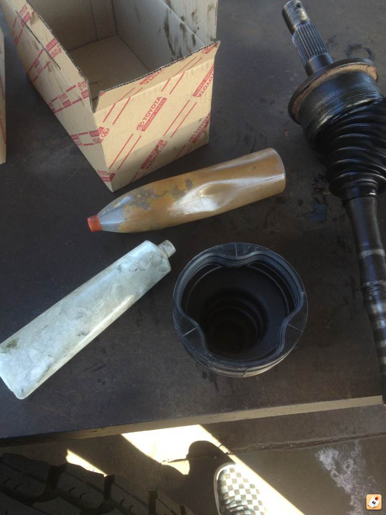

For those of you rebooting such as I did and went with the toyota boot kit, there's two tubes of grease, don't mix the two together! The lighter, or see through one goes into the outter boot, the darker grease or white tube goes into the inner boot.

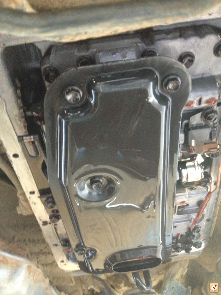

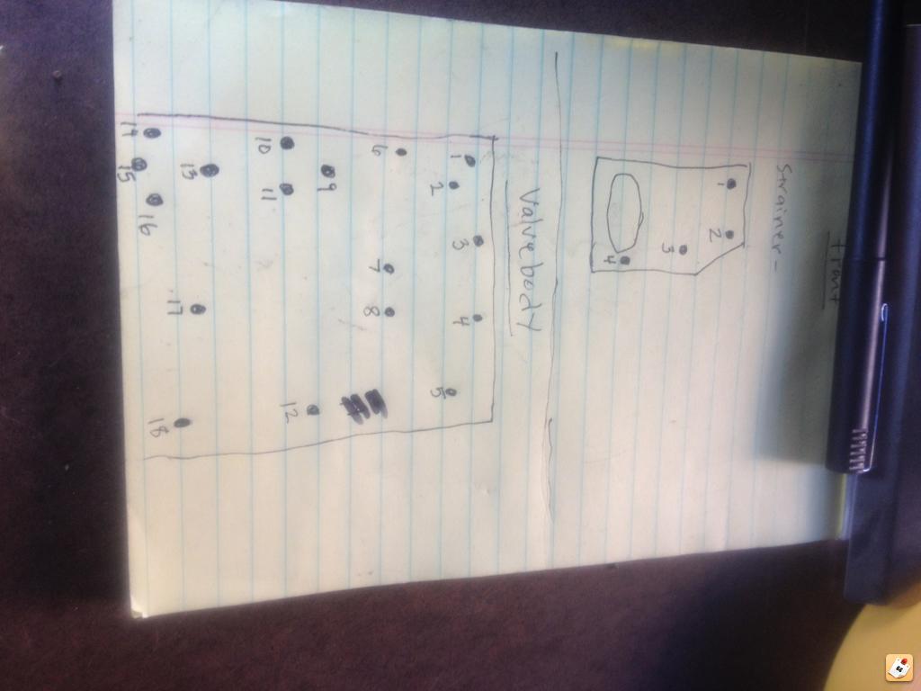

First things first taking off the trans sump, 19bolts later and a little bit of a surprise bump on the head it comes(falls) off! Then you have the strainer you take that off. MARK YOUR BOLTS OFF THE VALVES. The most important thing about this other then the ball valves is the bolts beings they are all different sizes.

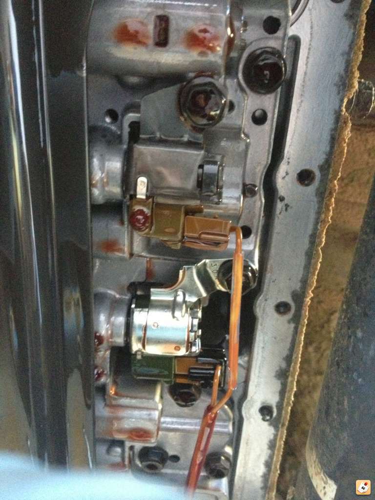

Depending on what year you have the solenoids are arranged differently here they here right there I ended up replacing them with new ones.

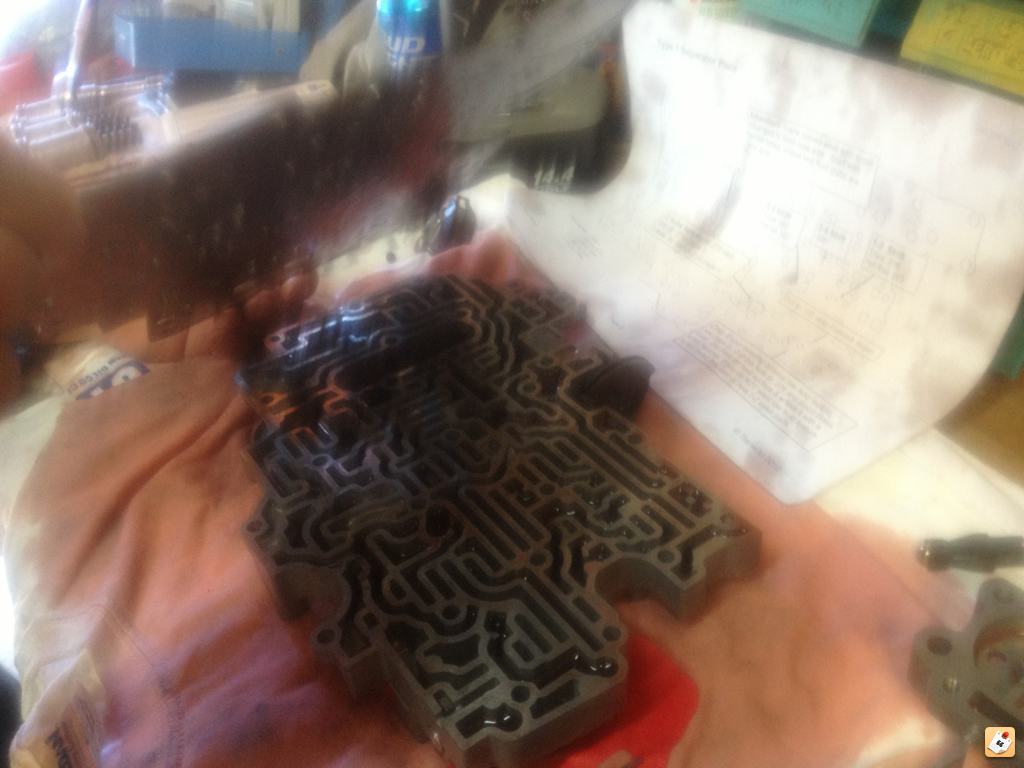

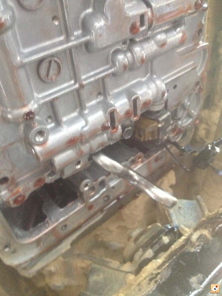

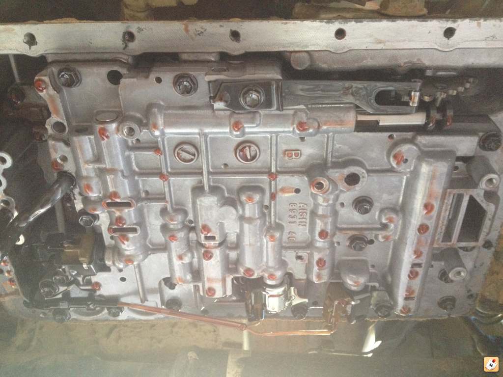

This is the valve body without the strainer.
There is a tube on my 98 that you end up pulling down, that's all you really have to do with this one.

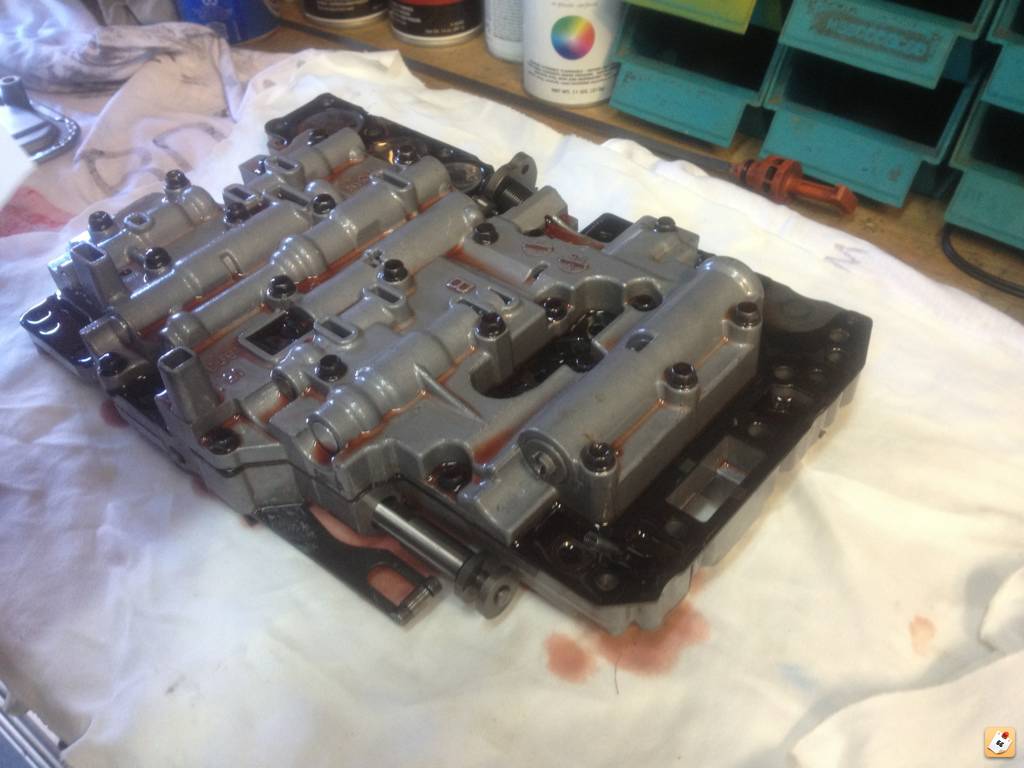

After that here is the valve body by it self out of the trans.

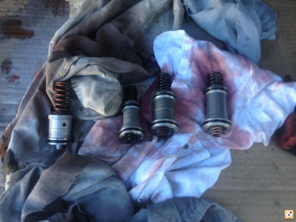

This is the order that the plungers go in from left to right being front to back.
This is how we labeled the bolts, made a diagram, then put the tape on the bolts in accordance with the diagram.

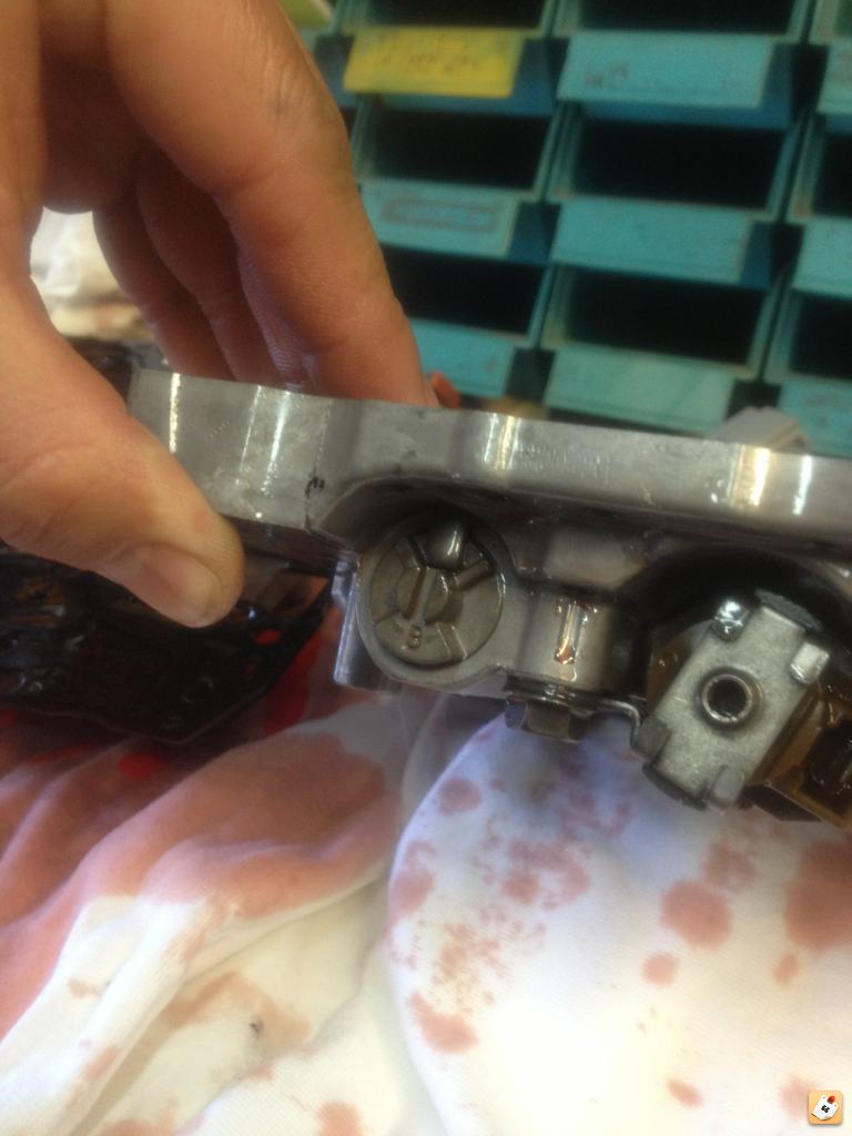

Sorry about the crappy celly pics, but this is the body getting separated. I'm not going to go into too much details because the instructions are actually very easy.

Did you guys both get a chance to ride in each others trucks? What is the difference between the hotrod shift kit and the truck shift kit?
shift difference
hope you don't mind dirty me chiming in for some info,
Dirty and i should make a video to post for y'all to see. I believe he's working on one soon. ill try to get around to it soon as well.
To me explaining it i would say his shifts at a 50% rate of tight firmer shift over stock "luxury shift" and mine is at about 80% and that rated at 100% being before it shifts so hard it barks second gear....lol.
