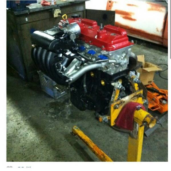

Well the runner is finally going into surgery for a heart transplant. Anybody looking for a good running complete 22re or 22re parts?
I know a guy that's looking for a header, how much do you want for it?
And I strongly object to you posting up that you're starting an engine swap and NOT telling us what you're swapping to. :mad:
Lc engineering 4x4 header street legal...its in really good shape as is the coating. 250$.....right around a year old with low miles.
I also have a 120 amp alternator and a complete 2 speed taurus fan and all the wiring, fuses and relays to make it work if that intrests anybody.
As far as the new motor goes i picked up a lc engineering 2rz fully built from a old customer. Lc everything as far as parts. Bored .20 over, extensive port and polish head work, all the fancy valve train goodies, balanced crank , lc cam, forged pistons , headers, intake and throttle body, stand alone fuel yada yada yada......saw her on the dyno about this time last year and she put down 255 hp to the wheels and just short of 300 in ft lbs. Im getting the motor for a stupid good deal so i cant say no. Since its all setup for boost ill eventually toss a low boost kit on there and let it rip. Nice light reliable motor thats gonna disappoint a lot of v8's and eat v6's for breakfast
That sounds like a SWEET motor and tons of power is always fun! Post pics!!
I hate to break it to you but that thing won't fit in your runner.
Save yourself the trouble and send it to me. I'll find something to put it in.
