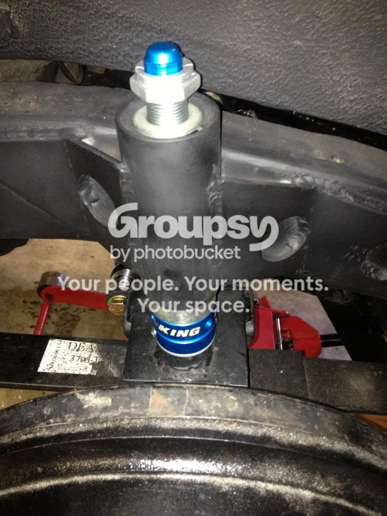

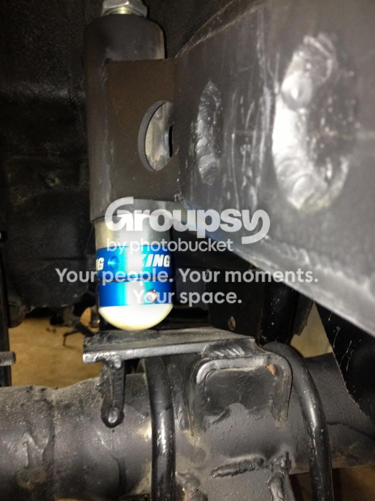

Yes I am bumping off the axle/off the original spring pad. I checked it, rechecked it and kept looking at it as I was building it, but as it goes through the arch, the bump is 90' to the axle pad in the last 2" of compression.
