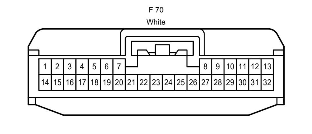

I have a friend with a trail edition 4runner and he spliced a toggle switch to his stabilizer control ECU.
I'm thinking about doing the same, but he recommended trying to do it as a plug and play solution instead of a slice by getting the matching plug for the control unit and making a harness.
He sent me this diagram (attached) of the plug and I have spent hours trying to Google and find it, but no luck.
The only relevant items I have found are the SCU part number...
2018 Toyota 4Runner REAR SUSPENSION Ride Control CONTROL MODULE - OEM Toyota Parts
... And some kind of diagnostic page.
Toyota 4Runner: Suspension Control ECU Communication Stop Mode - Can Communication System - Service Manual
Can anyone identify the plug itself or know where I can get one to make my own wire harness?

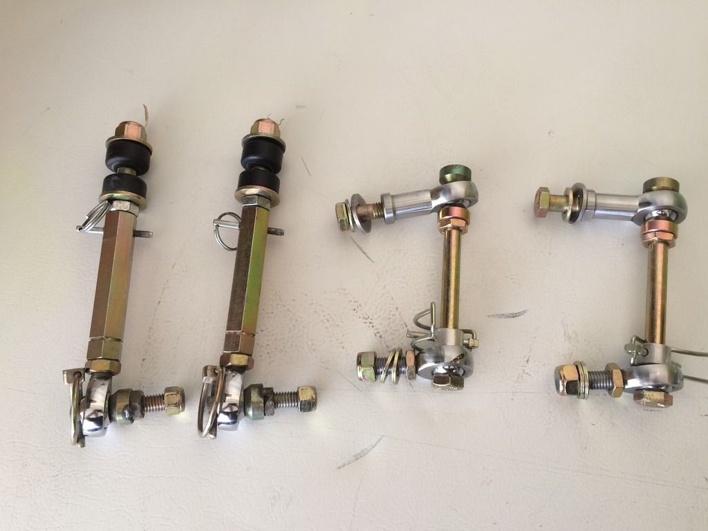

Negative ghostrider. Talking about where the sway bar is attached to the truck. Disconnects would allow you to get full articulation without being limited by the kdss system. Then when you want it back just hook em back up. Think certain jeeps come with electronic disconnects so you can just push a button. Old school way is literally something you unbolt or un pin.
Essentially you would negate the whole kdss LT issue (someone correct me if i'm wrong here). You would prob need the trac bar from sonoran steel and extended travel shocks to really take full advantage.
Would be something you could easily return to stock. However i don't think anyone has figured it out with kdss as the sway bars don't really have traditional endlinks.
Edit: I re read and realized your mostly talking about the high speed dirt road issue.... I'm game for an off button for that purpose. Disconnects like I'm talking about would be dope combo with the off button for whatever the road brings.

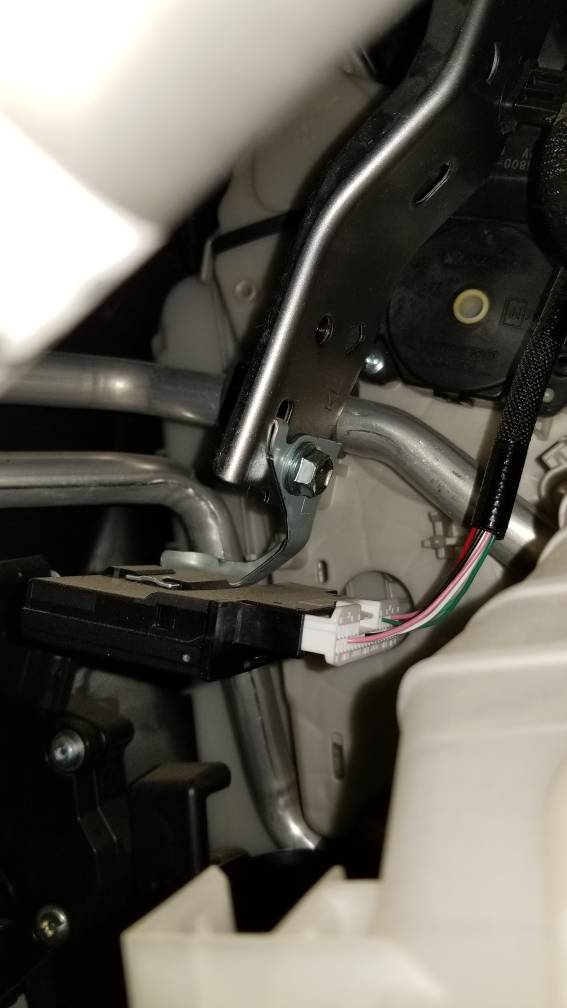

Where is the module located? I just got my 4Runner this weekend and haven’t looked for it yet. I’ll see what I can track down for the connector. I just spent some tome doing that for another project on it.
