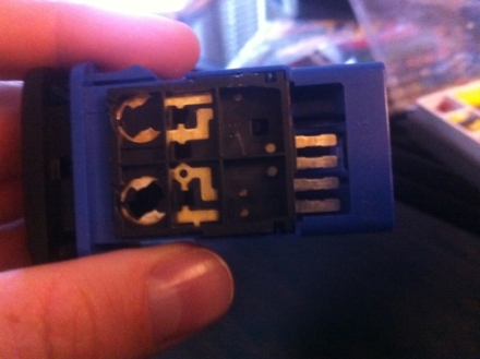

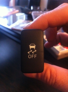

Hey guys, I am planing of doing this mod with the switch i am showing in the picture. Its the Toyota VSC Off switch i belive. Can anyone please tell me which to prongs i splice the wire i am cutting for the VSC mod, to which prong I splice in power to light the switch, and do i need to put anything to the 4th prong? Or tell me how to figure out whic prongs to use.
Thanks all!!

The middle two prongs are for the VCS, and the first two prongs are for the lights.
You have to modify the switch internally for it to work. I am still trying to figure that out.

I believe what you guys are trying to accomplish is the VSC mod using the stock VSC switch. In order for this to work you need to do the mod then mod the switch, as the stock switch is momentary and you need a switch that will stay on or off. The mod itself is pretty simple and well covered, but here is a link to mod the switch. Hope this helps.
