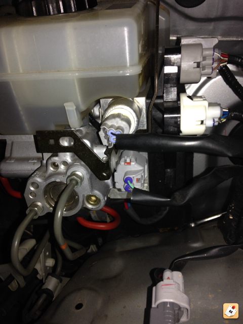

I am not 100% sure as I did not use a stock switch when I did this mod, but I believe once the switch is modded pushed in is on and system is engaged and working, popped out and the switch disconnects internally turning it off thus causing an interrupt in the system and thus enabling the mod. Once the mod is activated the only way to reset the system is to push the button in and power off and restart as this allows the system self test, find no faults and re-engages the system. The momentary TRAC OFF switch is used to turn TRAC OFF only up to a certain speed, approx. 23 mph I believe, this mod allows the system to stay off at any speed until you decide to turn it back on.

Can someone tell me what wire to splice. I thought it was the white black on the two prong but just double checking
I believe what you guys are trying to accomplish is the VSC mod using the stock VSC switch. In order for this to work you need to do the mod then mod the switch, as the stock switch is momentary and you need a switch that will stay on or off. The mod itself is pretty simple and well covered, but here is a link to mod the switch. Hope this helps.
