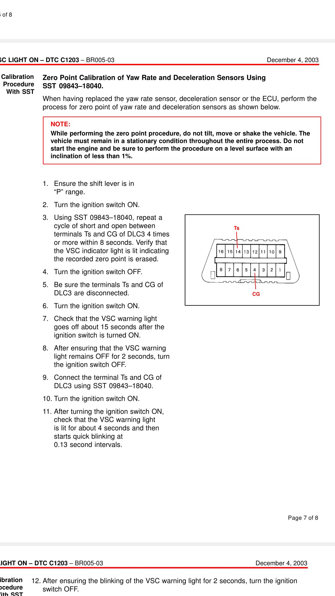

The TSB for the VSC, etc lights turning on includes programming the deceleration sensor. In the beginning of that process is the process to erase the previous "zero point" values. If you stop after erasing those values, your stability control and traction controI will be deactivated, leaving your ABS intact.

You don't use an OBD scanner, just 2 wires that you stick into the specific holes in the OBD plug and tap together when required by the TSB. This will leave the VSC and TC off until such a time as you complete the whole TSB and reprogram the deceleration sensor. Both wiping the values and reprogramming takes all of 30 seconds. When I can I'll make a video for you

Follow these steps up to step 4. Use 2 wires with the ends stripped, tap them together to short and apart to open the circuit. To undo it, follow the rest of the steps.

Here's the video. First up is a picture of the OBD port (dust cover moved to the side) and the ports where the wires need to go.

You don't need any special tools for this. Just a couple of lengths (equal length) of wire. Cut the wire to around 2-3 feet in length and strip both ends leaving about 1-2" of wire exposed. Insert one end of each wire into each of the ports, and use the other end as your "switch" (to tap together). Cheap 'n easy.

If i make this adapter i can do it faster and never have to worry if i got the right pins. Ordered the parts from amazon for $6

Step 9 has you apply a short. Is there a step 13 to remove the short properly to restore VSC? I want to be able to turn it back on. Looks like a great tip with no wire hacking. Ready to try it once the wheels are Plasti Dipped.
Take a look at the video, it explains how to reactivate VSC and Traction Control.
