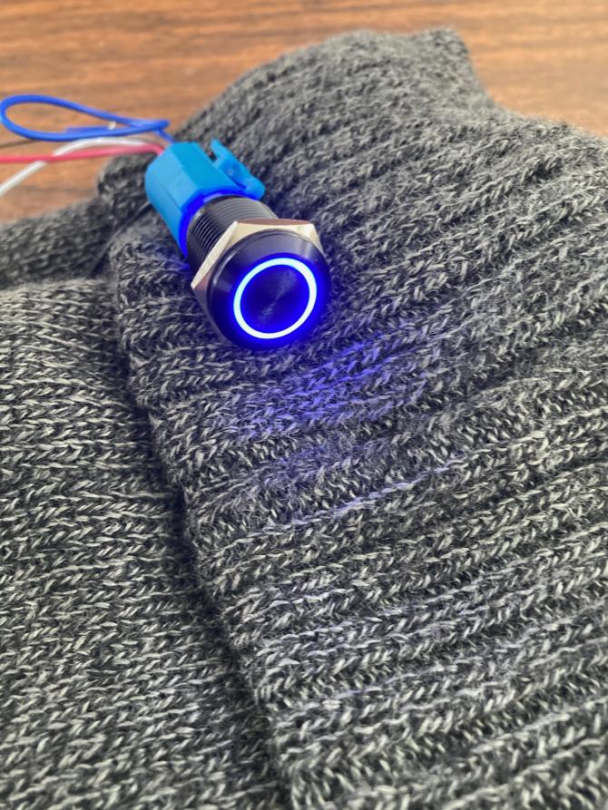

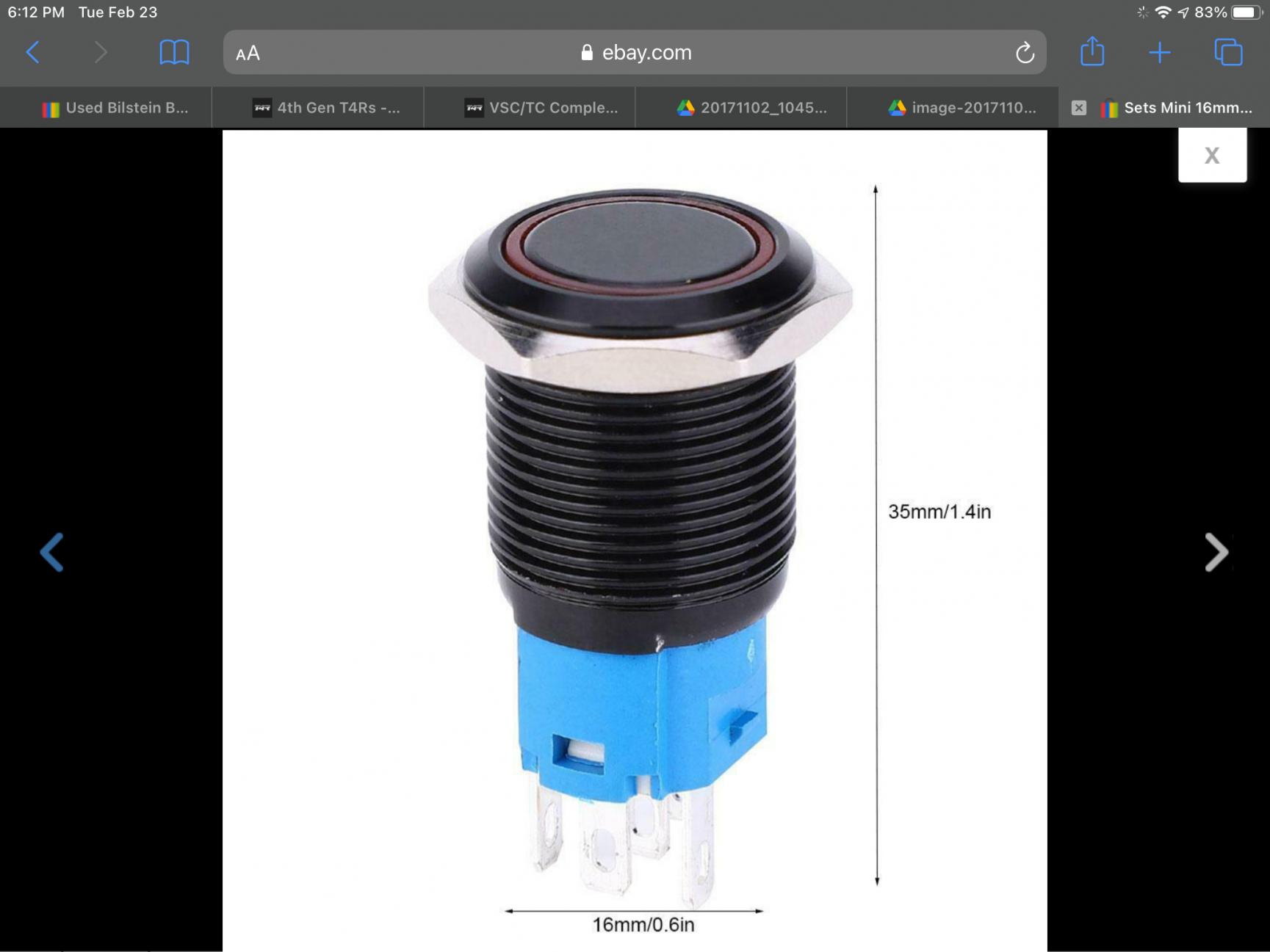

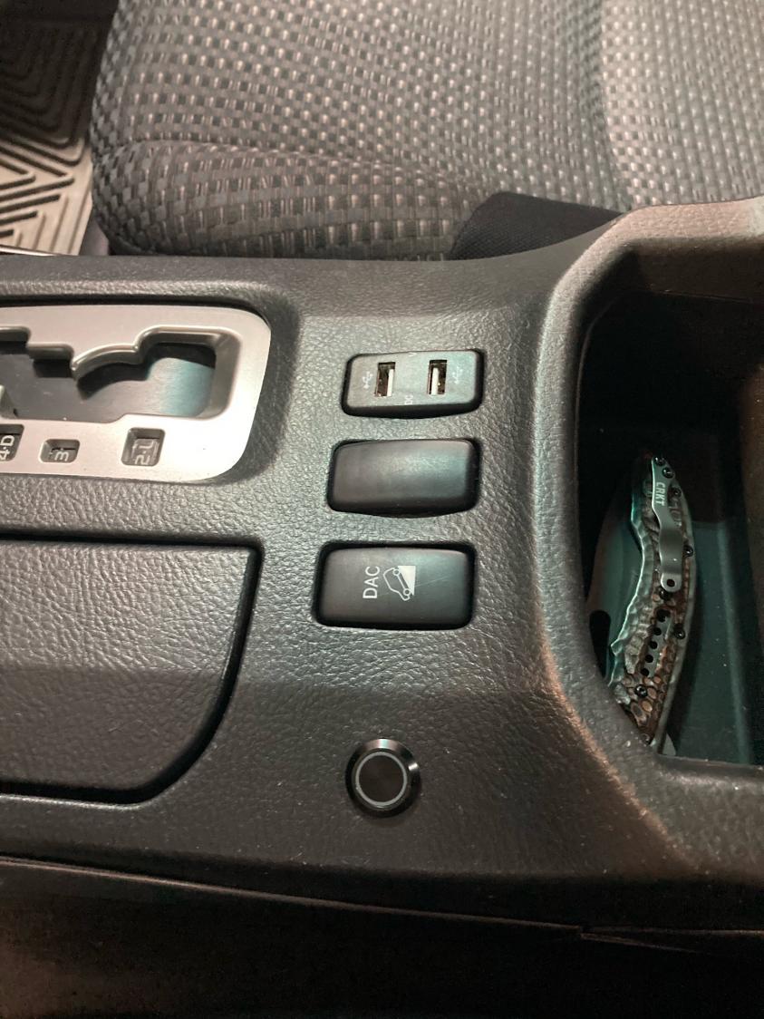

Great write up. I found a good switch for the task. It is a “momentary” switch that stays normally closed until I need to disable TRAC. Then press and hold the button until the dash lights up. It has an LED halo ring which will be lit continuously with accessory power, tapped from the wires supplying the USB charger. The button is flat so it doesnt get activated by accident and it’s black stainless so it is durable and blends with the console nicely. The hole size is 16mm or 5/8”.
2 Sets Mini 16mm Waterproof Momentary 1NO 1NC Push Button Round Switch | eBay

This is one of the best mods so far. Had to use it last weekend after the snow storm. Its great to go old school and have complete control of the truck without the nanny state over riding my inputs.
