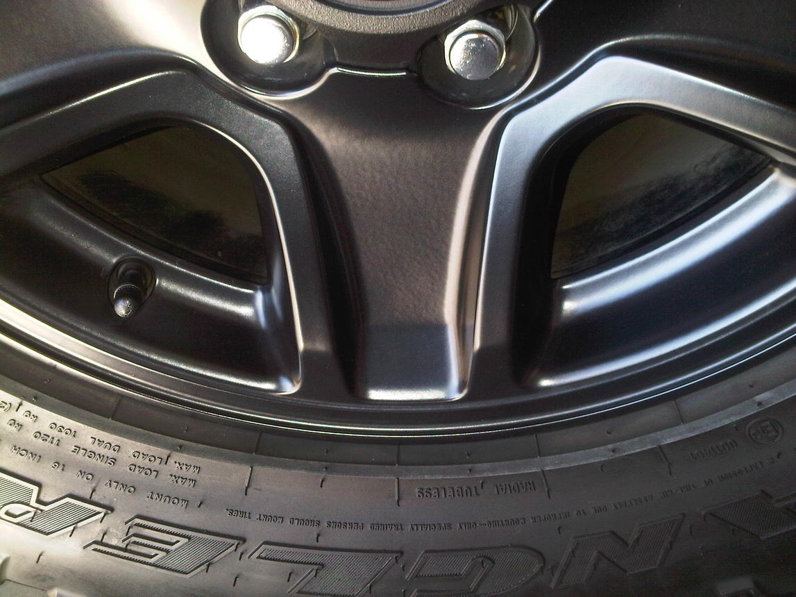

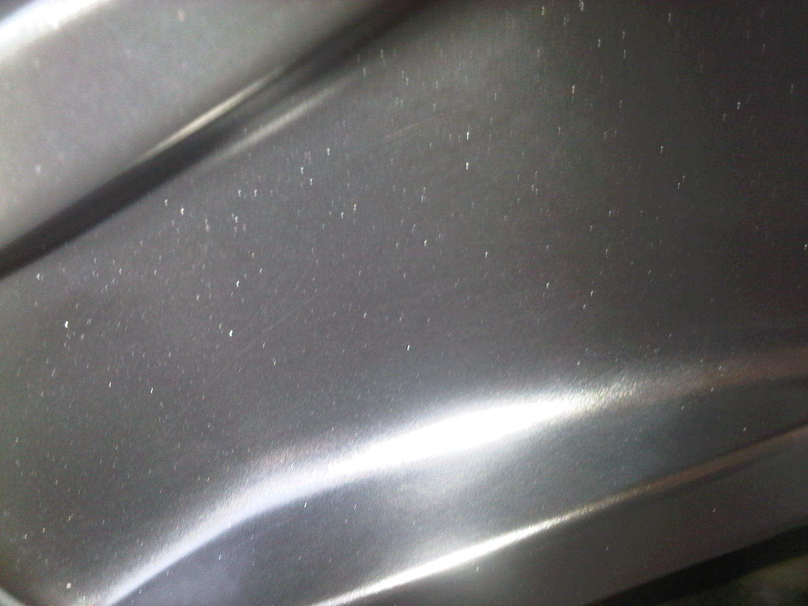

Ok, here are a few pics. These are close up (obviously) and the marks almost look like dust to the eye, but they are perfectly clean, I just wiped this one with a microfiber cloth, so they are perfectly clean.
Thoughts? Should I be pressing to have these re-done at this point, or is this the norm for places like Colorado with lots of gravel used on roads in the winter?

uhh yeah thats crappy sandblasting work! I use to work at a powder coating company!
if the sandblasting isnt done properly or the booth is dirty ie. not swept or cleaned after each job then the final product will look like sh*t and wont coat correctly! Powder coating is 'suppose' to be lifetime. The work should of been warrantied...atleast my shop warrantied it! If I was you I would be returning those to be re-done!

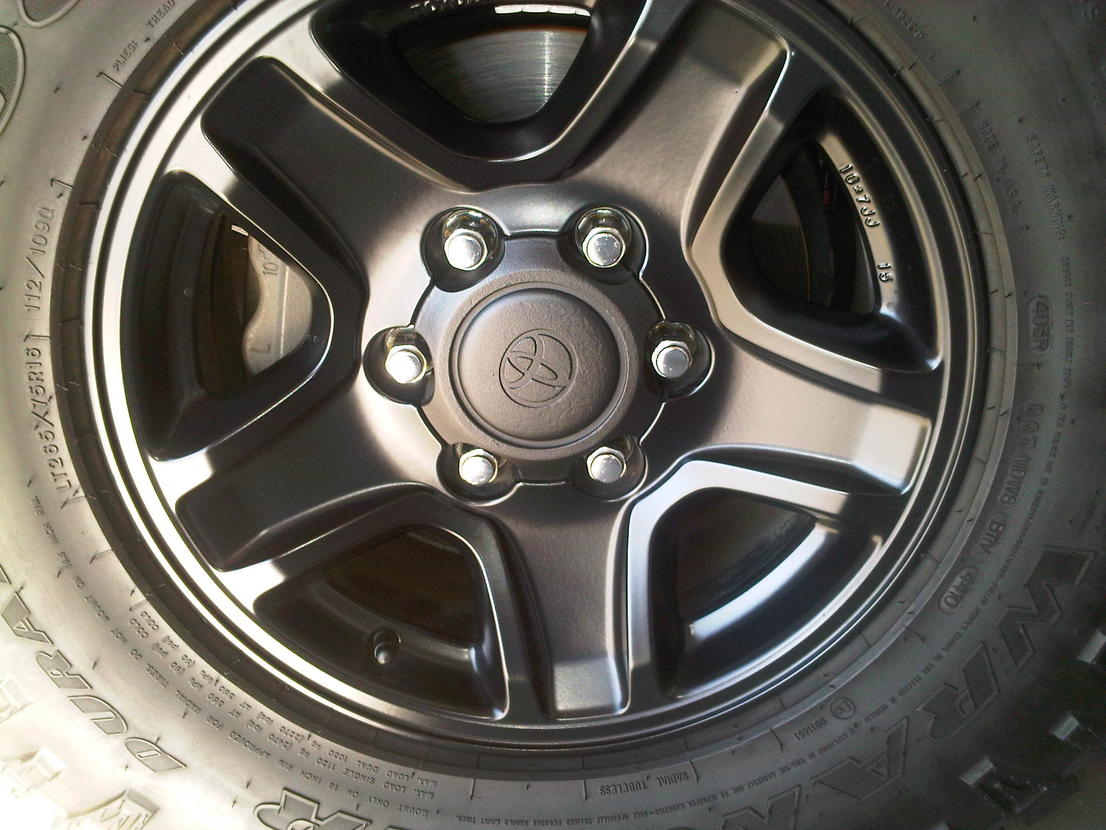

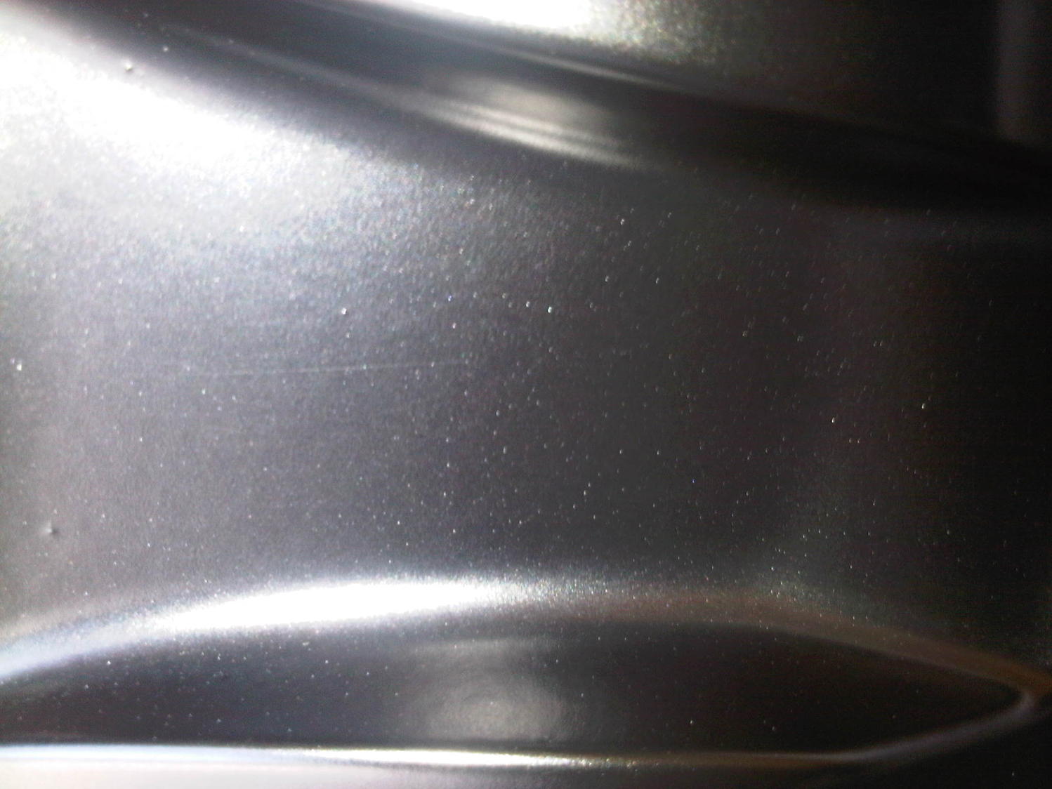

A couple more quick pics from not such a close distance. Can't really notice the specs in these, but I sure can when I wash the wheels or get close enough.
