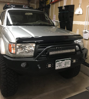

Auto Ventshade 23041 Smoke Colored Bugflector
Just my quick review.
On amazon for about $40.
The shape is perfect and I think looks the best of most I looked at. I don't like the ones that wrap all the way around the fenders.

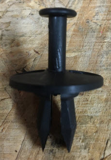

Mounting hardware is a joke so the two options are:
1) Sheet metal screws. If you go this route ensure you use ones that are small enough you don't poke through the top of your hood. Same if you attempt to drill any kind of pilot hole (make sure the drill bit is short and won't go too far.)
2) Use plastic pop rivets! I found some at ACE that worked perfect (with a little trimming). After installing with 4 of these I didn't even need to bother with the sheet metal screws!
