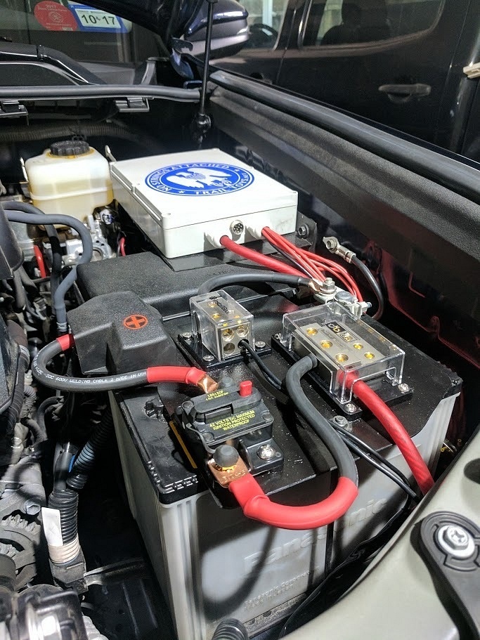

Distribution Box
Still waiting to install a Bussmman RTMR, is all wired I have just been to lazy to mount and install it. That is powered by a Bussmman Power Relay Module.
If I were to make a suggestion, I think you best approach to be to build a mount that is modular, basically a base mount adding a small template piece would attach you would attach. You could have templates or some form of universal template for a Bussmman RTMR :), or various Blue See Systems, a SPoD, or other. Even if it were a basic skeleton mount I would be happy to cut my own template in lexan/plexi :)
This would definitely give you a larger market as opposed to fab'ing a different mount for each system or one specific system.
I'm using a SwitchPro and Bussman box with a few circuit breakers
Nice :thumb: Clean work = like
Definitely will be universal but wanted to see what everyone was running so we can accommodate as many needs as possible.
If not mentioned, having the ability to mount in various places in the engine bay (behind fuse panel, rear passenger side,etcc) would be nice incorporated into the design
