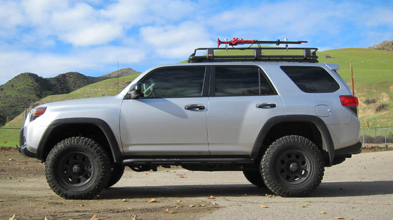

First picture is teh 4Runner in question. :)

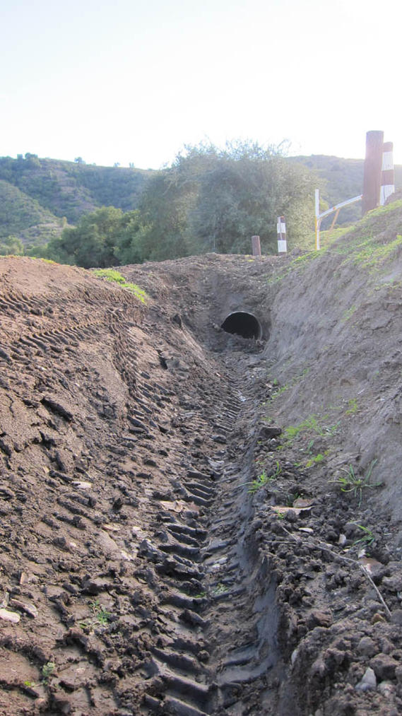

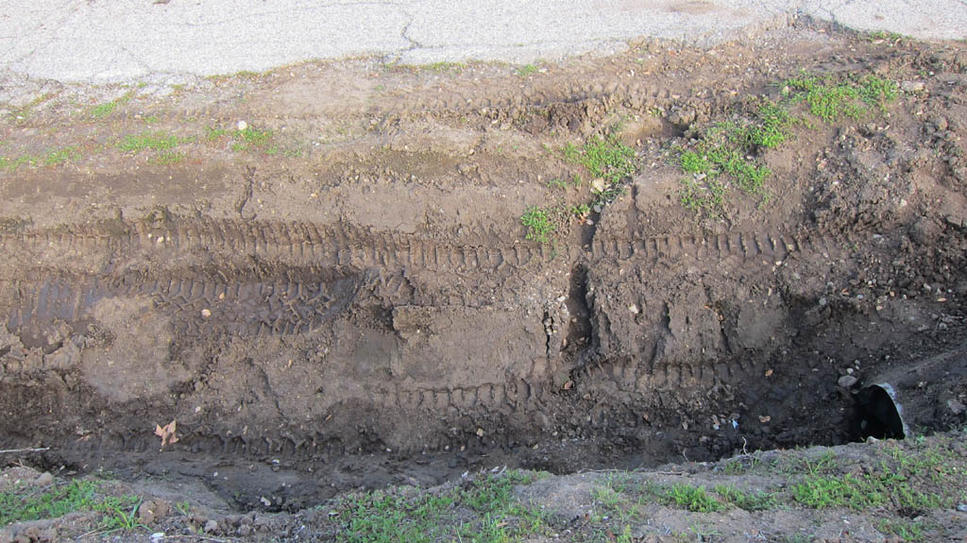

Second picture: Looking down the long axis of the ditch with the high-groud/driver side to the left, and low ground/dirt wall/passenger on the right. Front was pointed towards drain pipe; rear was where i'm taking picture from.
Final picture: Taken from up above on the dirt berm with the top of the picture being the road (high area) and the drain pipe/front of 4Runner being to the right. You can see the tire marks. Oye.
