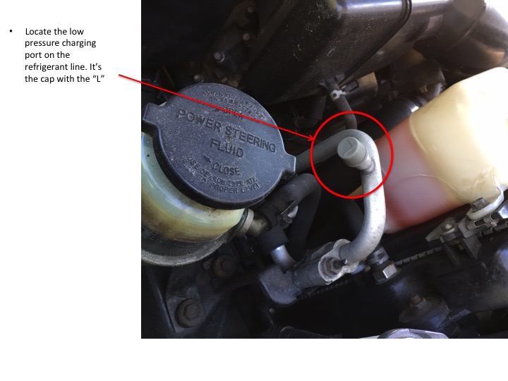

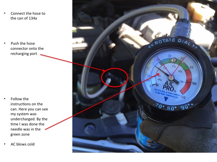

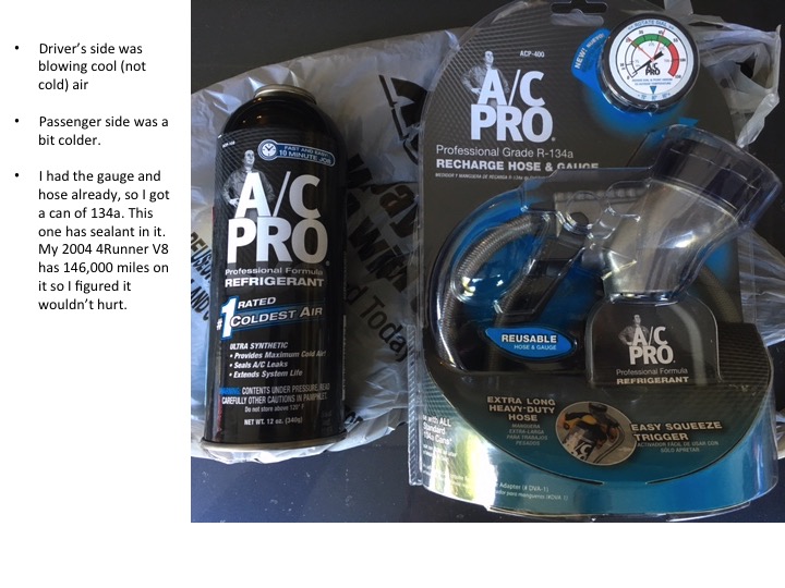

Happy 4th! It's going to be a hot one and my AC was blowing not-so-cold air. Here is a quick 20 minute DIY with pics.

Did the same thing with the same product 8 weeks ago for its first recharge in 7 years/160k miles. AC blows ice cold!
