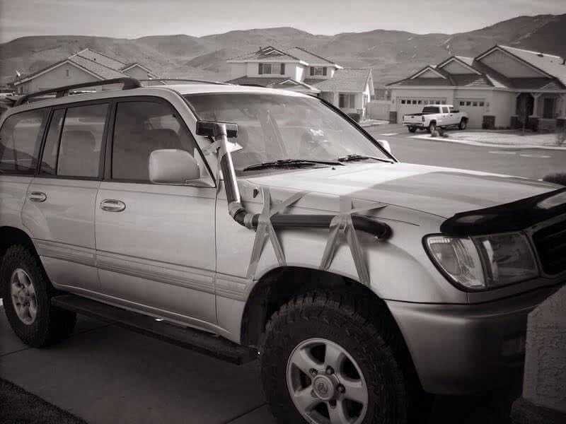

Load up your best snorkel picture.

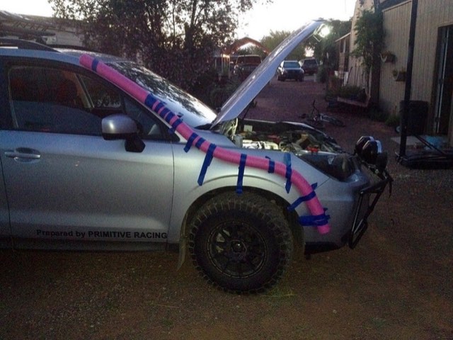

ImageUploadedByTapatalk1452732754.564846.jpgImageUploadedByTapatalk1452732765.972676.jpgImageUploadedByTapatalk1452732775.933661.jpg

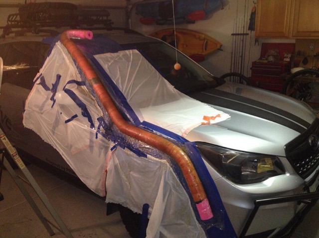

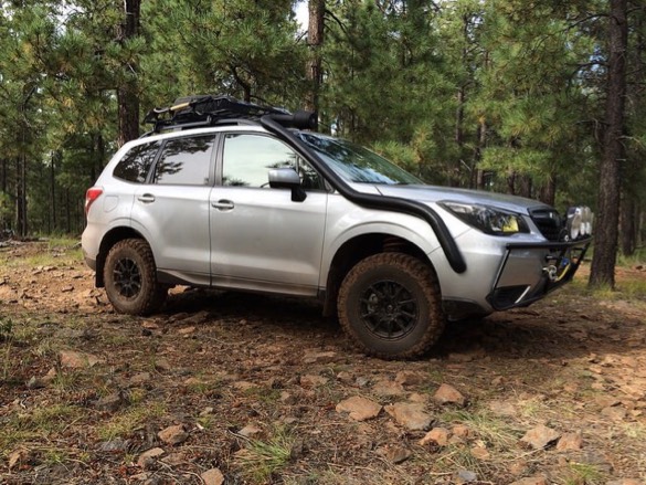

That second one was the same one just painted.
I wonder how much air velocity he got out of using a 3/4" air intake line.

The one I posted is a pool noodle that was fiberglassed over. the noodle was pulled out prior to completing.
That's a great idea for forming the fiberglass, when I was back in high school, I used plaster to fill the intake tube of my RX7 and then shaped it after cutting the tube off, then I used a boat repair kit to make a fiberglass intake tube(everything sourced at Wally World).
