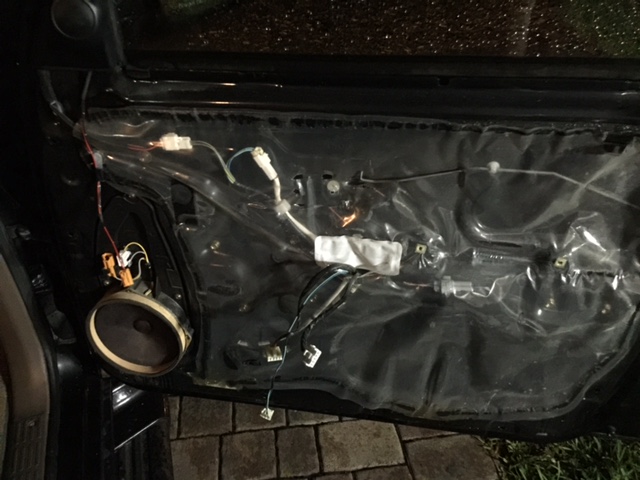

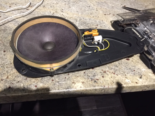

1 - There are a hundred videos about how to remove the door panel so I started with the door card removed (pic below). As you can see, the housing extends upwards halfway up the door and organizes the wiring. Remove the five screws and pull off entire housing. Unclip the wires from the head unit and the wires to the tweeter. There's a foam seal that you're essentially going to rip apart, which I assume prevents rattling. Since the residual stays on both sides, when you screw it back in, it should still have a similar effect. You can replace if you want. I didn't.

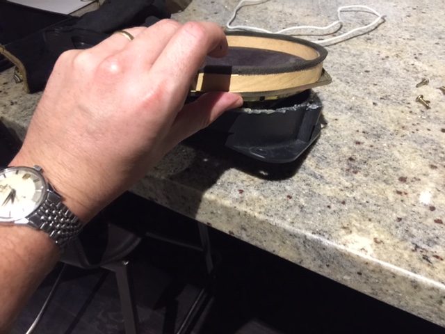

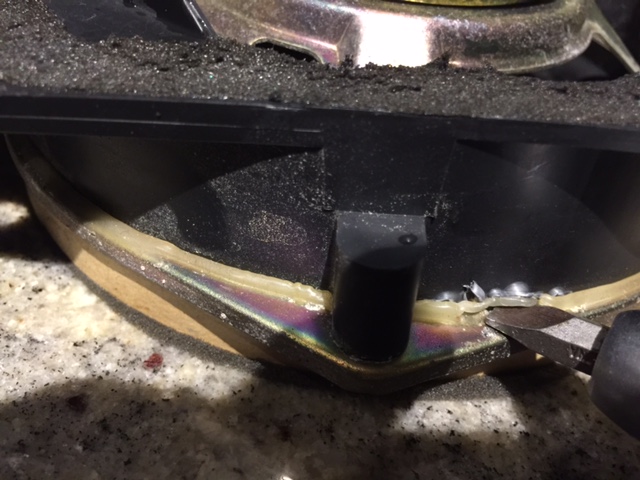

2 - After the housing is off, you remove the four screws in the gold speaker trim to separate it from the housing. Then I had to pry the speaker away from the housing. I could have used an exacto and taken my time, avoiding damage to the housing, but I just used a screwdriver and pulled it apart bit by bit. There are some minor dents in the housing now, but since you seal it all up anyway, it doesn't really matter.

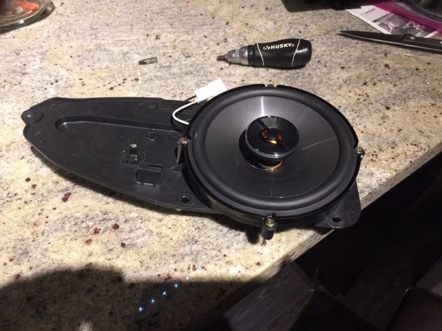

3 - Once it was all pried apart, I connected the adapter (you need an adapter for most speakers, 14 bucks at best buy) to the speaker and ran the wire out through a slight cutout in the housing (same place the former wires came out). The wires here were a little thicker so I used an exacto and dug the cutout slightly deeper. Most speakers come with an adapter to match up the screw holes. As luck would have it, this one more or less fit. I stuck a little foam ring between the housing and the metal edge of the speaker (instead of @&!#*@* glue!!). Here's the finished product.
