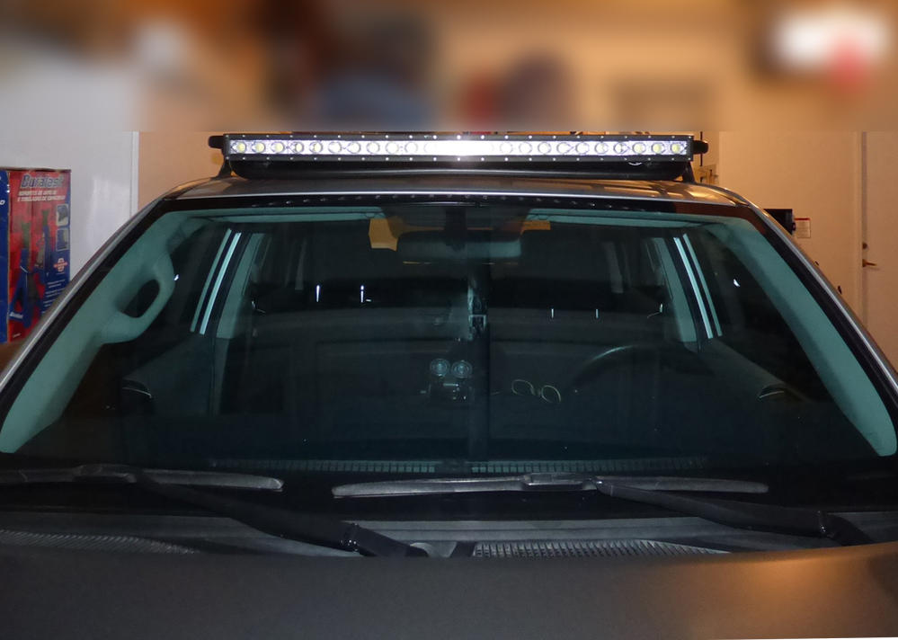

Has anyone found any good "theft prevention" techniques for mounting a light bar on these Gobi's?
Tamper proof torx button head bolts are probably the best in terms of a bolt. Other than that, buy the Chinese light bar. Or drill a hole in the cooling fins and run an aircraft cable through it and then to the rack.

I originally had the light mounted to the top of the rack where it is supposed to go, but it created too much drag and noise up there. So I moved it to the lower bolt holes of the fairing. Works better there but I do get more glare on the hood.
