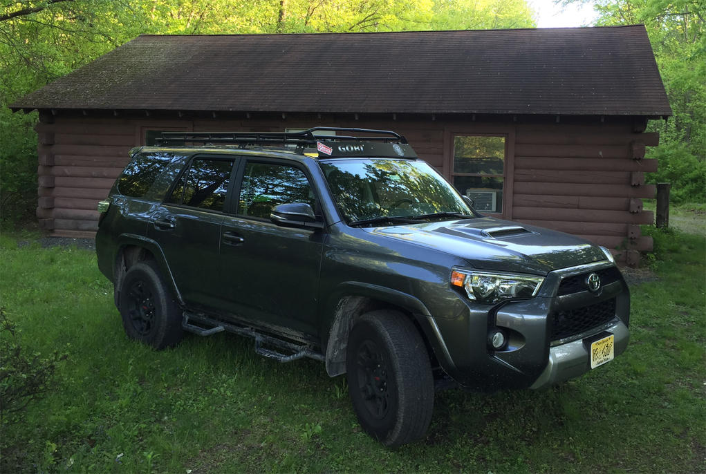

Thanks for the detailed instructions. Just mounted my Gobi over the weekend following the extra advice here.
OP, looks like you initially stuck the front most feet onto the roof of the truck & then ultimately moved them to the gutter/roof channel (more outward). Any reason for this? Thinking about ordering tomorrow... Also not sure if I should do the fixed or movable crossbars. I'm thinking adjustable crossbars will pretty much always be a better idea for flexibility/adaptability. THANK YOU for the write up.
