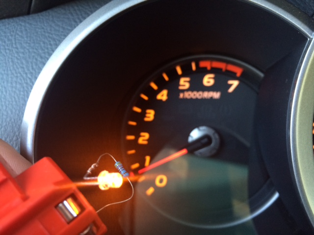

thanks for the picture. i think the disconnect is that i can't tell how you have the blue resistor connecting the + and - of the LED. it looks like there is just the brown resistor for + and blue for -.
is the brown resistor wrapped around the positive lead then hooked to red?
and then the blue resistor is wrapped around the negative lead, and then the brown resistor, and then hooked to black?
thanks again for your help, just trying to clarify!
i'm not shorting them. thats not the finished connected product.

this is how it goes. i think this maybe the clearest i can do it. in my crazy mind it sounds right LOL. please tell me if im nuts or not hahahaha
The above is correct. Please everyone use solder and heatshrink tubing and you will save yourself a lot of pain and hassle down the road. It would also be possible, after securing and insulating the resistors, to push/fold the wires together, twist, and wrap in electrical tape to make it one thin(ish) looking wire. Just don't bend the resistors more than once or twice or they will break off and preferable not next to the base. They are about 5% the strength of a paperclip.

thank you for taking the time to take this picture, it is much clearer! i was confused at the earlier pic with the blue resistor.
this will be my last clarification, other than that i will just make it work and stop bothering you.
big resistor is wrapped around + output. it is then wrapped onto positive input of led bulb. the small resistor is wrapped around the large resistor, but not the + input. the other end of the small resistor is wrapped around the negative output. the negative output is then wrapped around the led neg input. or are some of these connections soldered?
thank you, i swear this is my last question, sorry for being a bother and hopefully you don't now regret posting this mod.
I think this will help. Three things will tie together to the positive side. 1,the other end of the big resistor, 2 one end of the small resistor, 3 the positive end of the led bulb.
On the negative you also have 3 connections. 1, negative input wire (that's the black wire in the above pictures), 2, the other end of the small resistor, 3 the negative end of the led bulb.
Further clarification, the big resistor is basically in line with the positive feed.

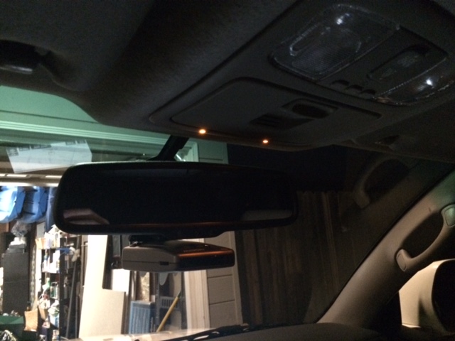

Wow I thought I was the only one crazy enough to want this. I got used to the awesome ambient glow in my previous BMWs and needed the added detail in my 4Runner.
I added two leds and tied into the dash illumination circuit so they only come on with the headlights and dim with the rest of the lights using the dimmer wheel.
I went with an amber color that matches the dash illumination:

Oh and you guys are waaaaaaaay overthinking the resistor situation. I saw pictures with multiple resistors/ shorted across the LED leads? Yikes. Watch out for excessive current draw and LOTS of heat if you wire them like that....
I used a single 510ohm resistor on the cathode (-) leg of each LED. I wired both LEDs in parallel to the 12-14v illumination circuit. Simple. No mysterious burning smells or fires.
