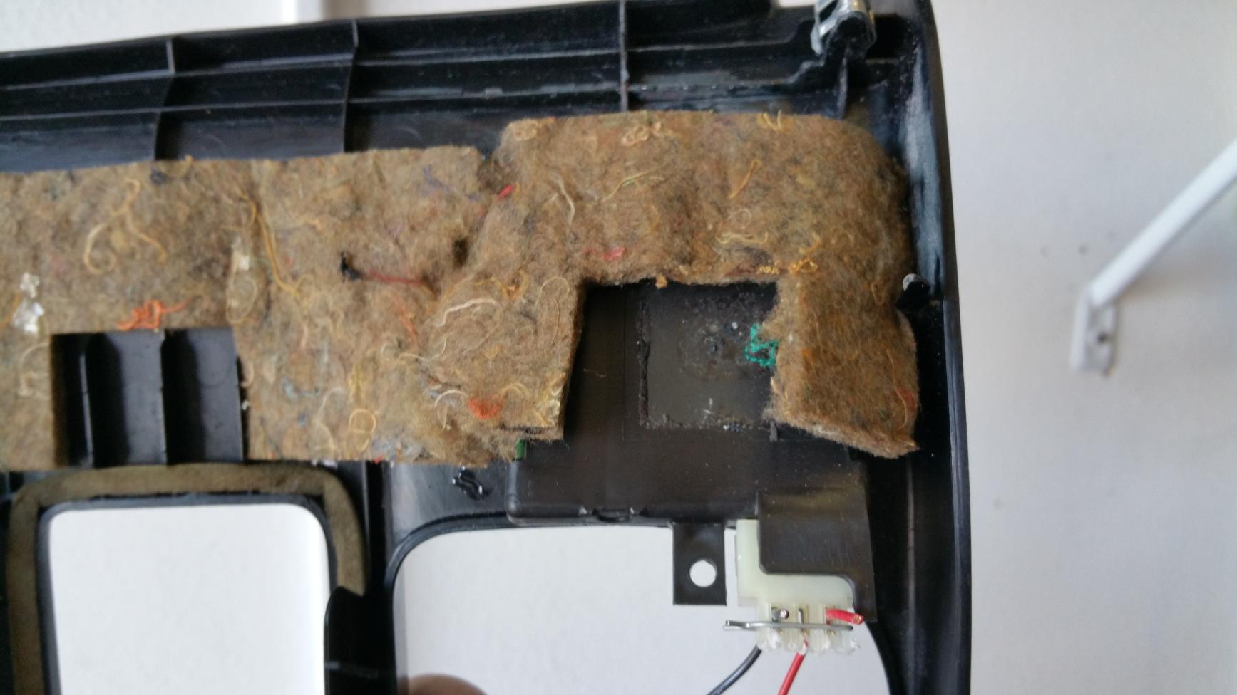

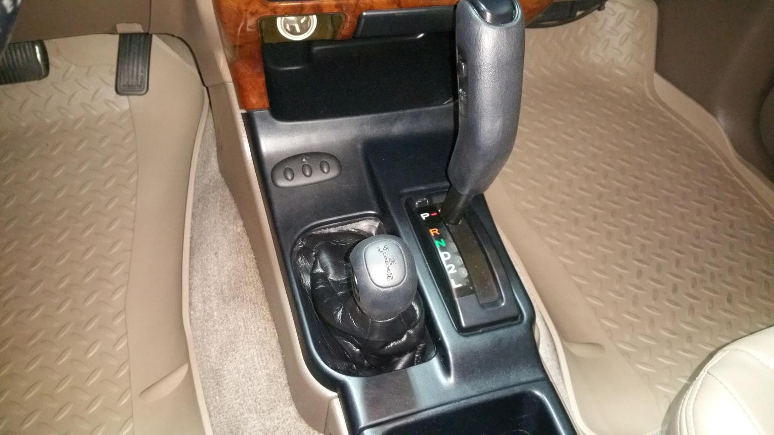

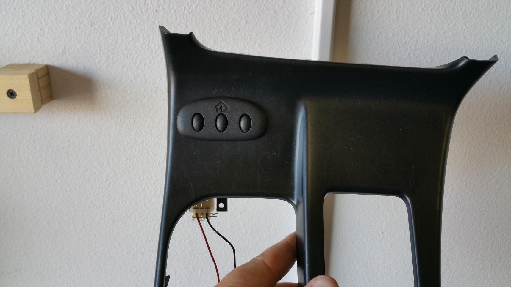

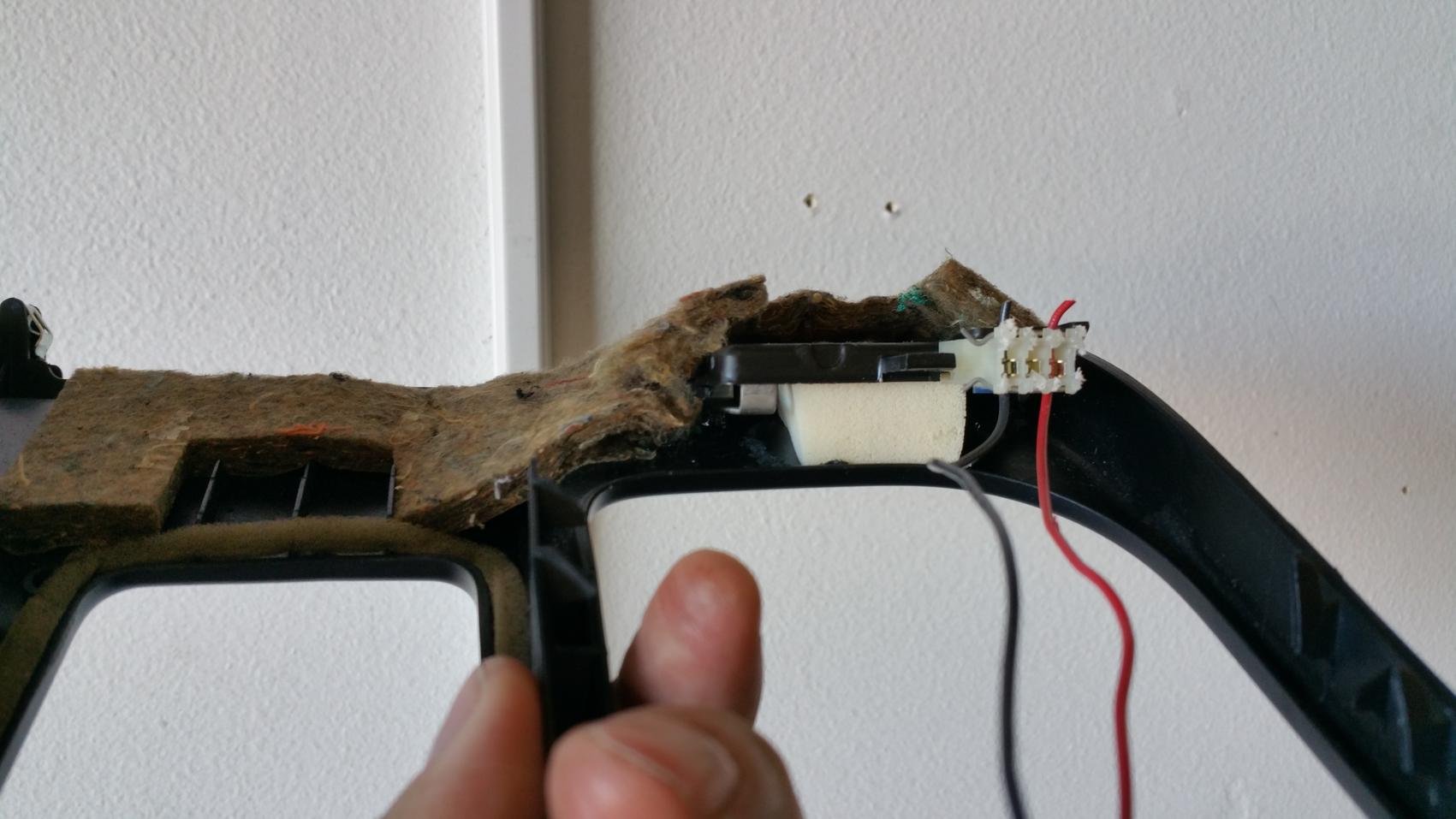

Hey guys, I've just purchased a 97 4runner and one of the first mods I did was add homelink. I got a ton of useful info off of these forums on how to do it, but I wanted to show you guys another location that works flawlessly and in my opinion it looks factory. ThIs location is if you don't wanna cut into your headliner. I found this console piece on ebay for $30, just in case I screwed it up, it's alot easier and cheaper than a new headliner, that was my thinking.
I installed my homelink on the center console above the 4wd shift lever, I wired it to the cigarette lighter for power (grey wire) and grounded it to a bolt under the console. Since the plastic is thicker, I also had to cut the homelink module casing just like the above install, and the hole in the console was also cut like he did above in his headliner. Also you have to install it exactly where I have it because there are large electrical connections just to the right where the module now sits under the console. Since the console piece starts to curve up more drastically the more forward you go, you need to keep it as far back as possible towards the 4x4 shifter, that way the homelink faceplate will sit flush. Also that curve creates a gap between the homelink module and the plastic console on the back side, so I "shimmed" that gap using foam, it's actually a triangle makeup sponge and it worked perfect. The other reason you need to have that gap is so the 4x4 boot can install in that gap between the console and module. Also you can see that the wire plug from the homelink hangs down into the 4x4 shift area, but there is plenty of room and nothing comes close to hitting each other. If for some reason you were worried about that, you could cut off the plug and solder the wires directly to the board, so it wouldn't go into the 4x4 shift area, but like I said, there is plenty of space. I test fit it multiple times by shifting into 4x4 low gear, and it doesn't even come close to touching. I didn't take photos of the module cut up, or the hole cut in the console, because it's exactly like above with his headliner install. The only thing I had to cut on the console besides the hole for the buttons, was there were a couple plastic "ribs" on the underside of the console that needed to be cut off. There is also some padding that I peeled back and the put it back over the module when it was installed. It was pretty easy and straightforward, thanks to all your guys help on here. Here are a few photos. If you guy have any questions, let me know. Thanks

Nice job. A lot of guys like me install a transmission temp gauge in that location. Make sure a spilled slurpee cant wet your circuit board.
That's a good idea about it not getting wet. I Never thought about that. My next mod is going to be the 99+ console with cupholders, so hopefully I wont be worrying about a drink looming over the homelink area...I'll have to check out the trans temp gauges you guys have installed. I absolutely love this forum, I've never been a member to any forum before, so I'm new to how all this forum stuff works. The information and experience that everyone has on here is great. Your write up really made my install easy, so thank you!!
