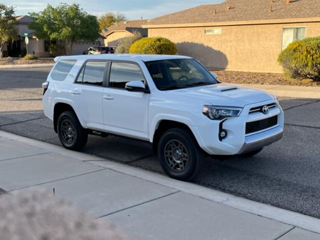

Great write up, I ordered and installed the roof rack delete kit. I want to also warn about using a screwdriver even with a rag I managed to put a small dent in the upper roof area below the cover, I used a plastic dent tool to pry the covers off after seeing what I had done. Good thing I bought the paint/dent insurance, they will remove that dent I knobheadingly put on my vehicle. Reason I removed the rack, it's silver, nothing on my truck is silver, and I will never have a need to use it, and as others have mentioned, it's a pain to wash/wax the roof with that rack in the way.
I want to either remove and paint or replace with a black factory rack, the rack on my 2012 SR5, or remove it completely and replace with a Gobi.
Anyway, your truck looks great and I also want to get rid of all the chrome.
