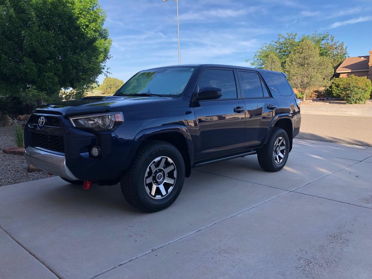

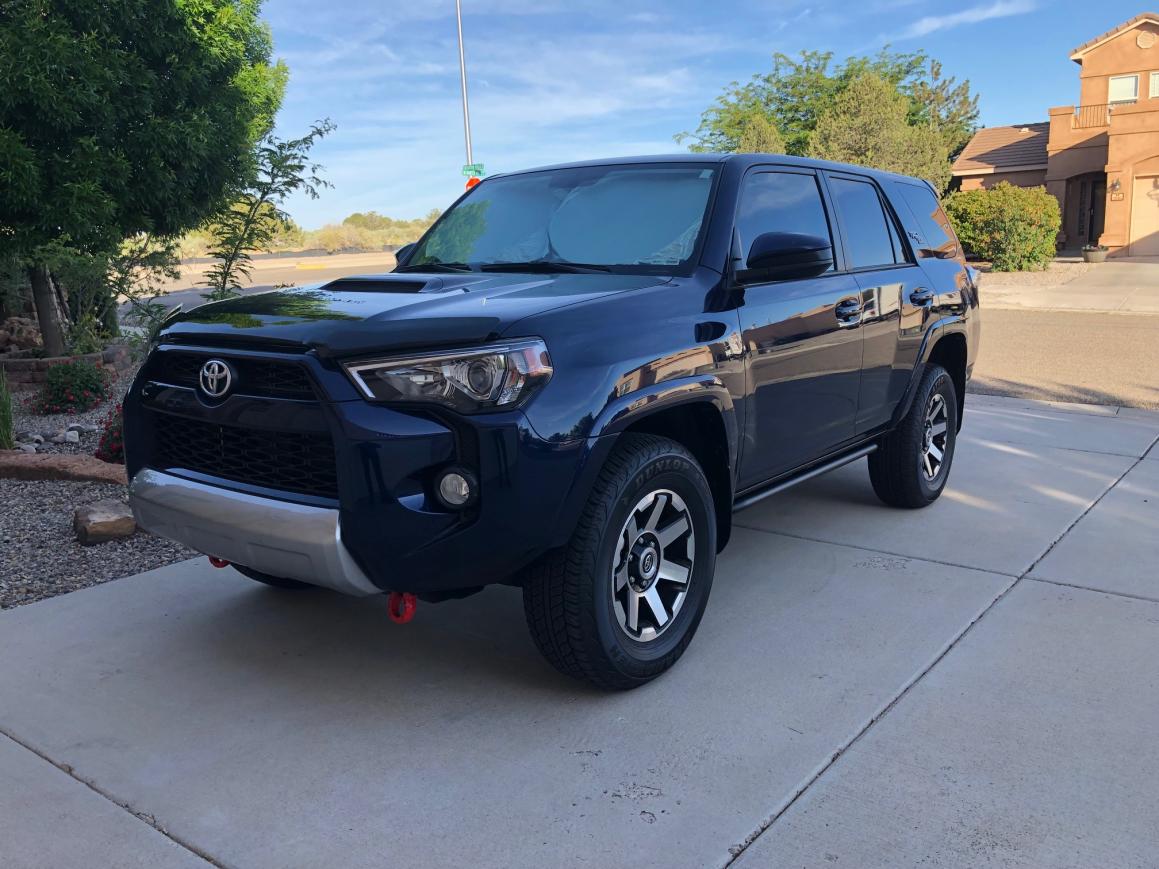

Removed the black roof rack from my '19 TRD OR. The ham fisted baboons at the dealership scratched the hell out of my roof when they installed the crossbars (done prior to purchase). I'll need to get the polishing compound out to see if I can smooth out their "custom" work...:mad2:
The 4Runner looks rather lean and mean without it... at least my 17 year old car nut thinks so...:rockon:
Sorry for the shaded and dirty pics...
