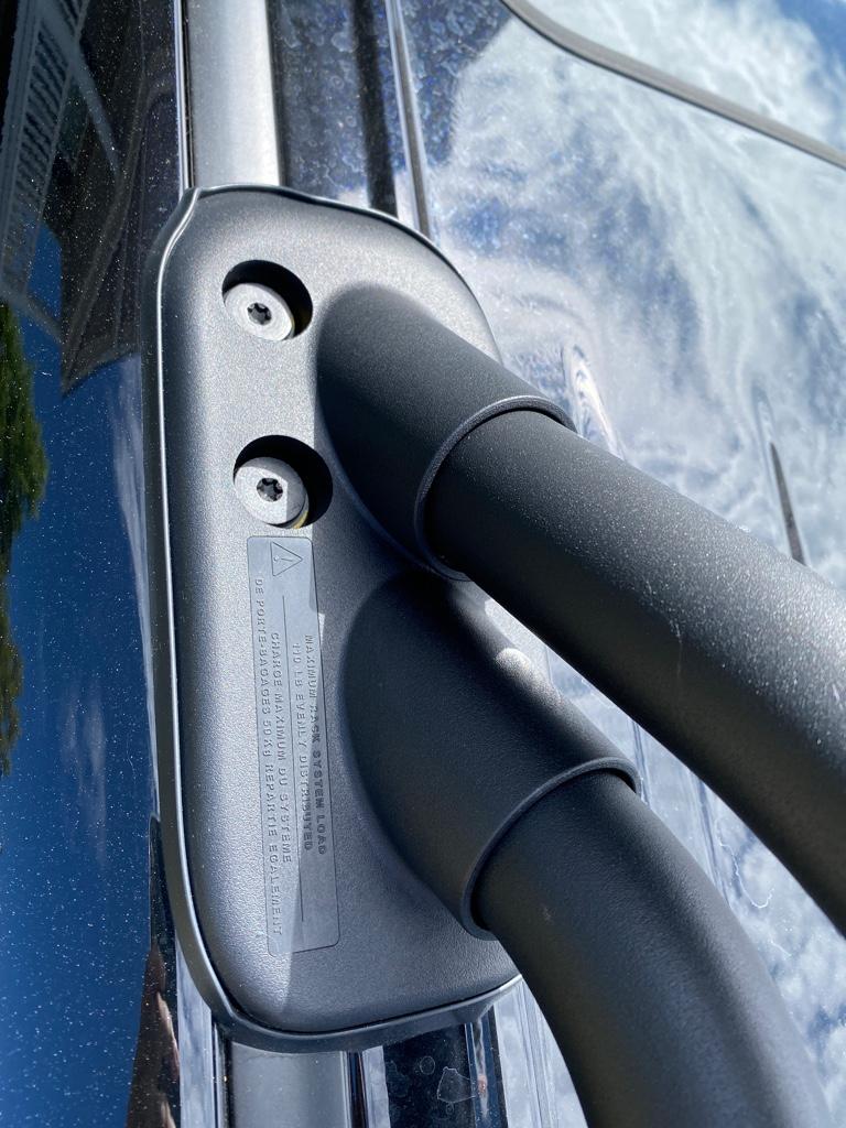

Looking at my TRD Pro (2020) mine is different when taking it off. Looks like two hex screws holding it in. Gotta do some research and see what the deal is. Not sure if these kits apply.

Don't skip the silicone. had the dealer do the delete, they didn't use silicone and I've got water getting into the interior now.
I'm surprised the OEM delete kit doesn't come with any mastic patches. When I removed my rack for the first time the mastic got messed up so I ended up buying new mastic tape when I put it back on.

Has anyone removed the plastic covers from the Delete kit? is there a right way to remove them? I did the Delete about two years ago and now I'm getting a leak, I did not use the silicone, so now I will remove the caps and redo the bolts with the tape and silicone. Any advice is appreciated
