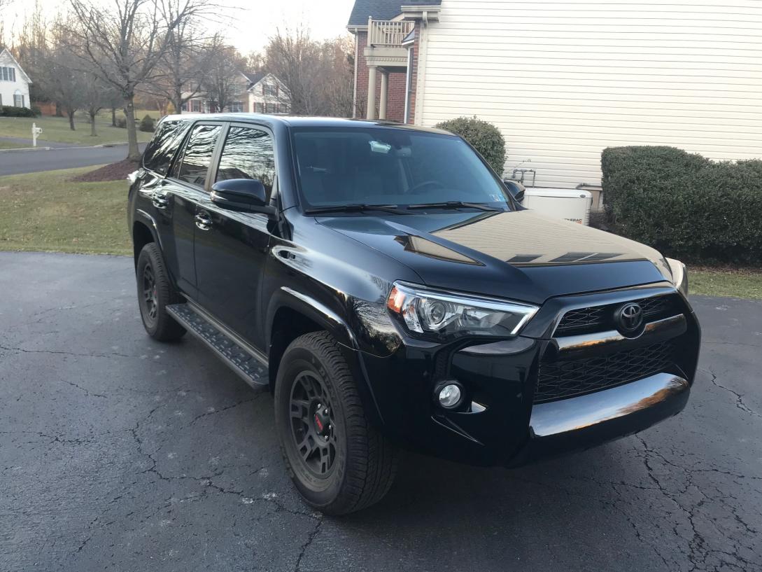

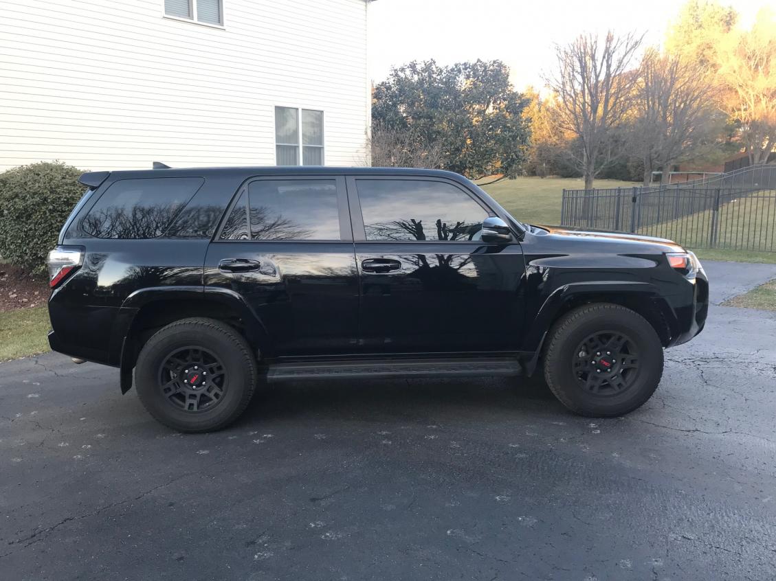

Great pics and DYI info. Did last weekend on 2018 SR5 Prem. Thank you!IMG_4521.jpgIMG_4523.jpg

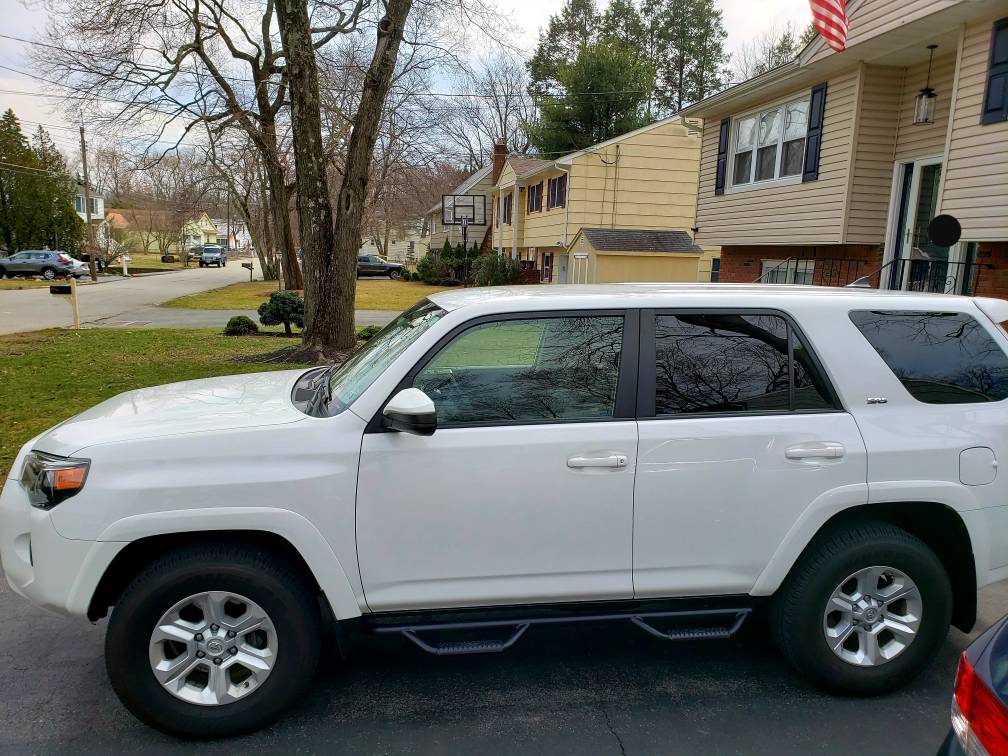

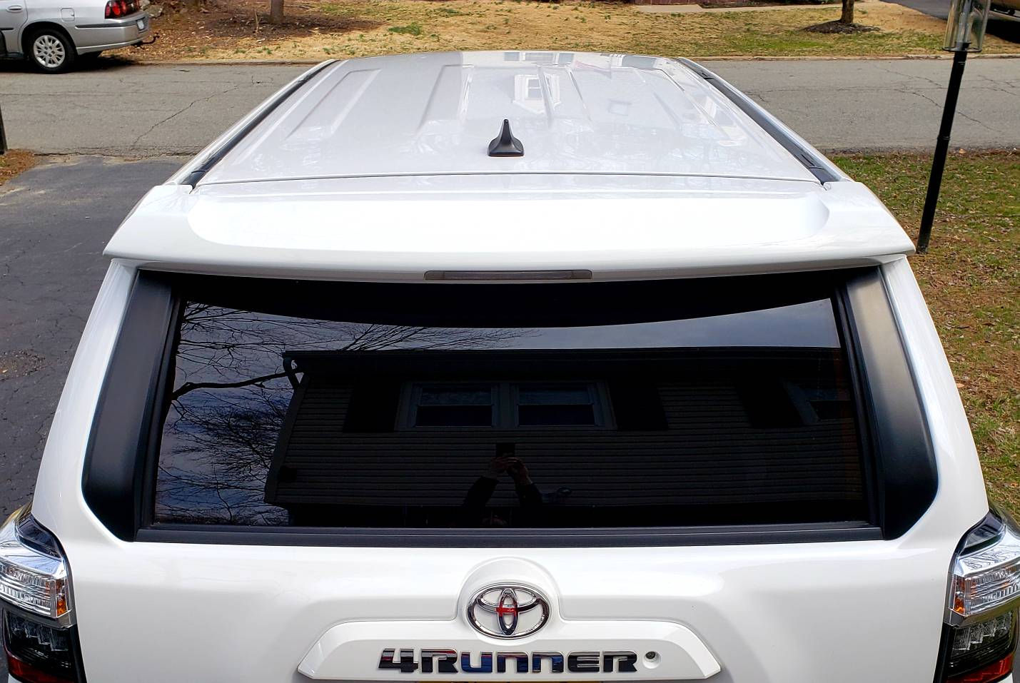

great write up OP. Just ordered a kit from amazon. Snow removal from the roof with the cross bars stinks.
