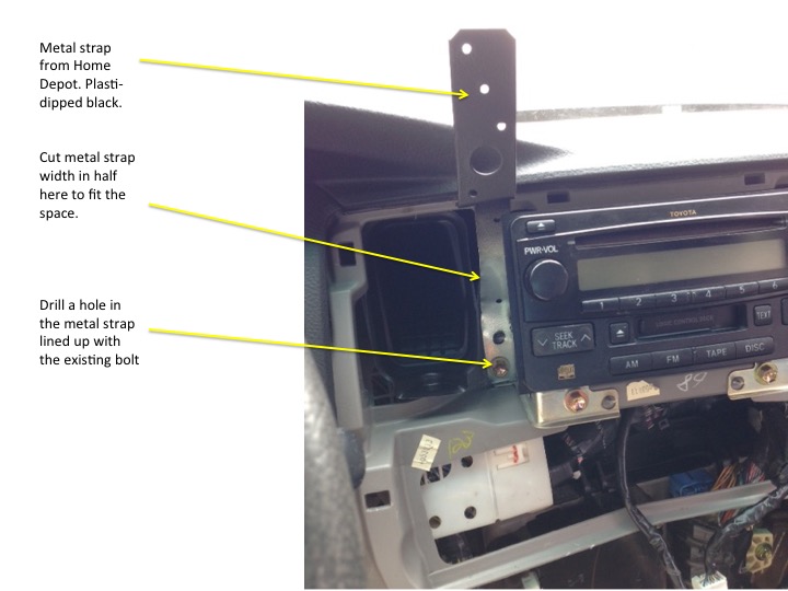

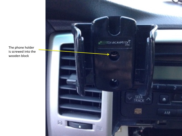

1. Cut a strip of metal (from Home Depot) to fit behind the trim. You may have to drill a hole for the bolt. I sprayed the exposed portion with plasti-dip to make it black.
2. Attach (with screws) your favorite phone holder!

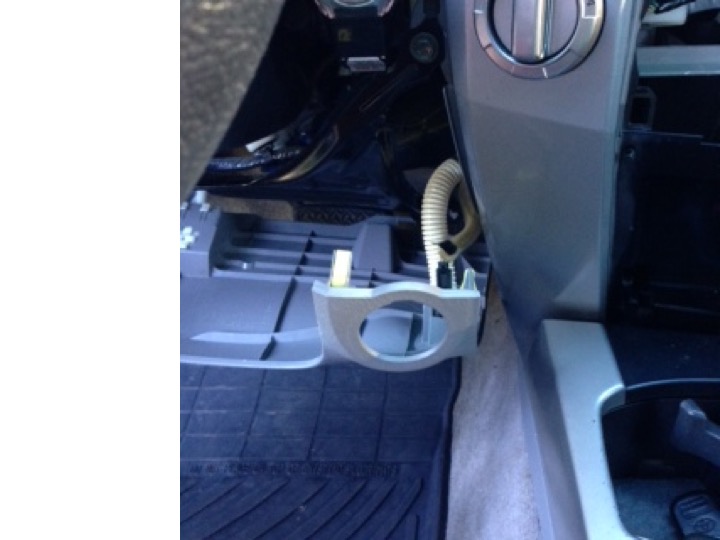

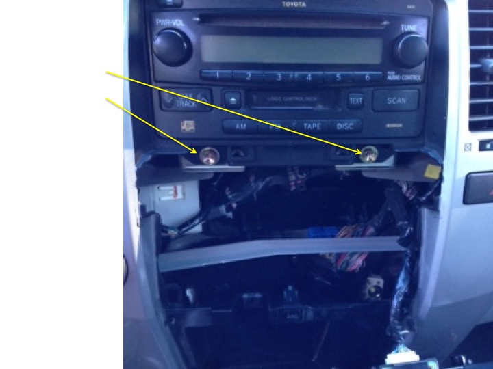

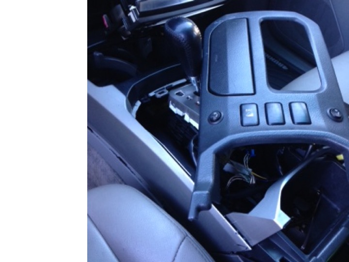

I decided to redo my holder, so here are the details along with pics.
1. pop off the console (no tools required)
2. take off the trim piece beneath the steering wheel (held in with two screws) and then take off the one screw holding the trim piece around the radio
3. remove two bolts beneath the radio and take off the trim

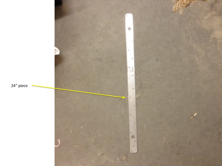

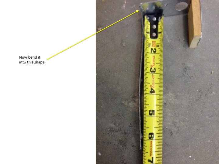

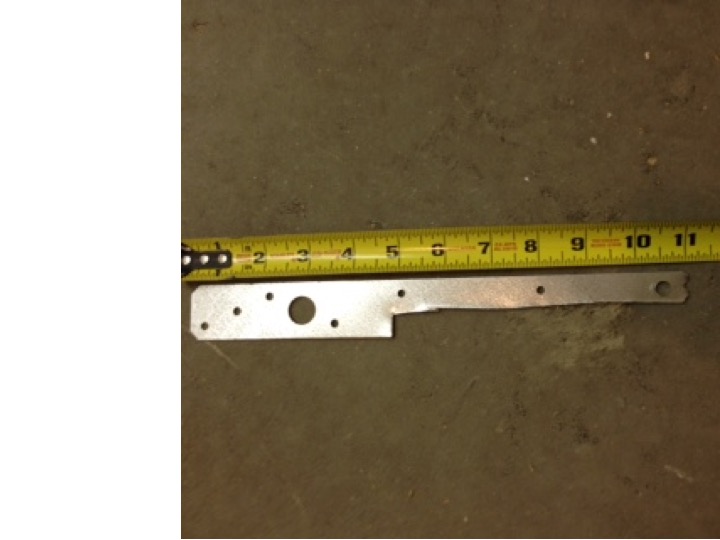

4. get one of these metal straps from home depot or similar

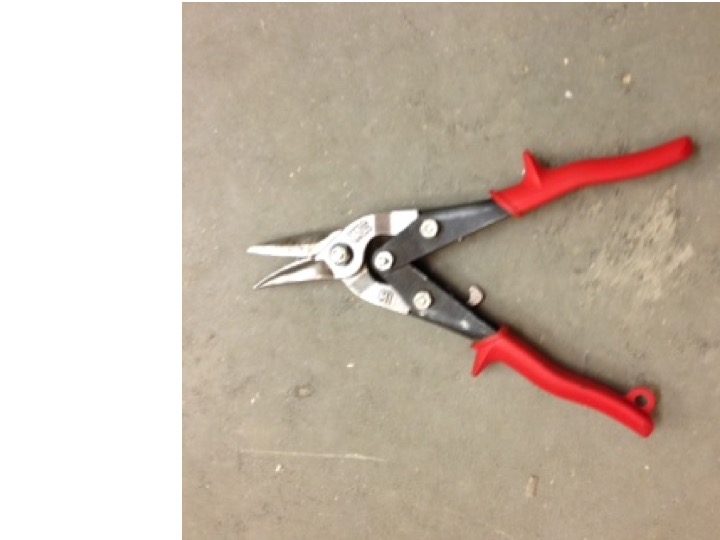

5. you'll need some sheet metal cutters
6. cut to this shape (11 inches long), drill a hole at around the 10.5" mark

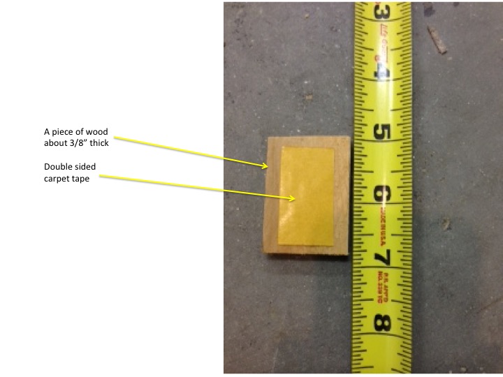

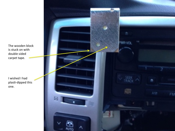

7. this wooden block will be used as a backing for the metal strap. I will stick it on to the metal strap with a piece of carpet tape
and bend into shape:

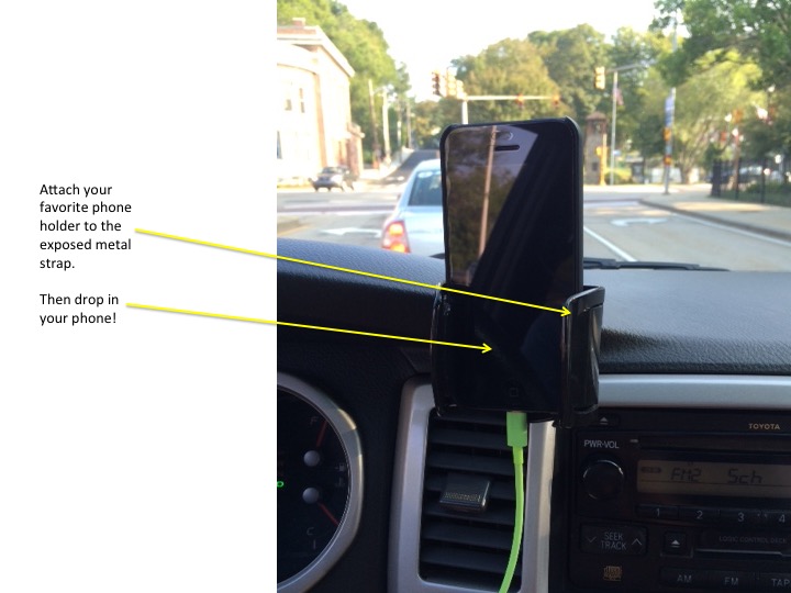

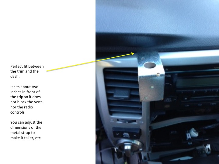

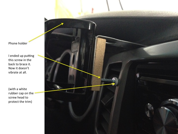

9. Here it is with all the trim replaced
10. I installed a Bracketron phone holder but you can attach your favorite.
Here it is at a different angle:
