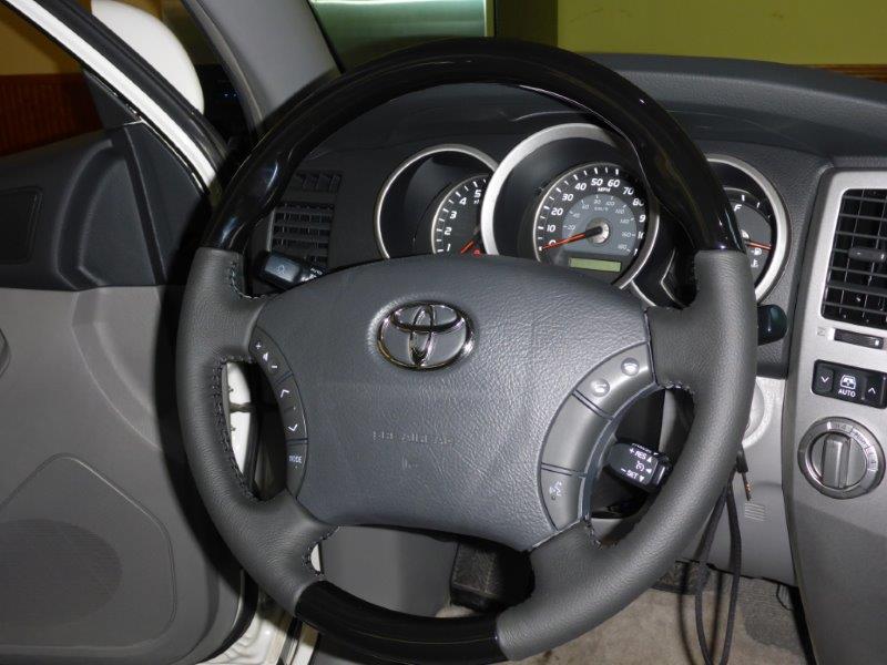

First thoughts: Very Nice! I have to say, I remember my steering wheel for my Surf felt heavier and leather SEEMED to be of higher quality. Because this is black, I can't "study" it, but I will say it's a "mirror" finish, no flaws and leather feels nice. I had my Surf (and wheel) for about 3 years and it held up very well. Some nicks eventually showed up (due to wrist watch and wedding ring constantly tapping it), but the finish was never ruined. For now, I will say this is a quality wheel, but I've seen "better". Of course, this is relative being that there really isn't much to choose from for our beloved 4Runners. Let's see how it holds up. Time will tell.

If anybody is worried about the swap, don't fret. It's very straightforward in how it comes apart and back together. If you disconnect the battery or just turn the ignition off with the key removed make sure you wait 90 seconds before disconnecting the air bag. They have a 90 second back up power source. Also, be sure you mark where the old wheel is exactly before you remove it so you know you get the new one on the correct spline.

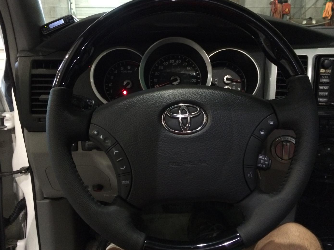

Here is a better shot of the wheel. The camera really picks up the contrast in the 2 colors but to the human eye you can't see it.
