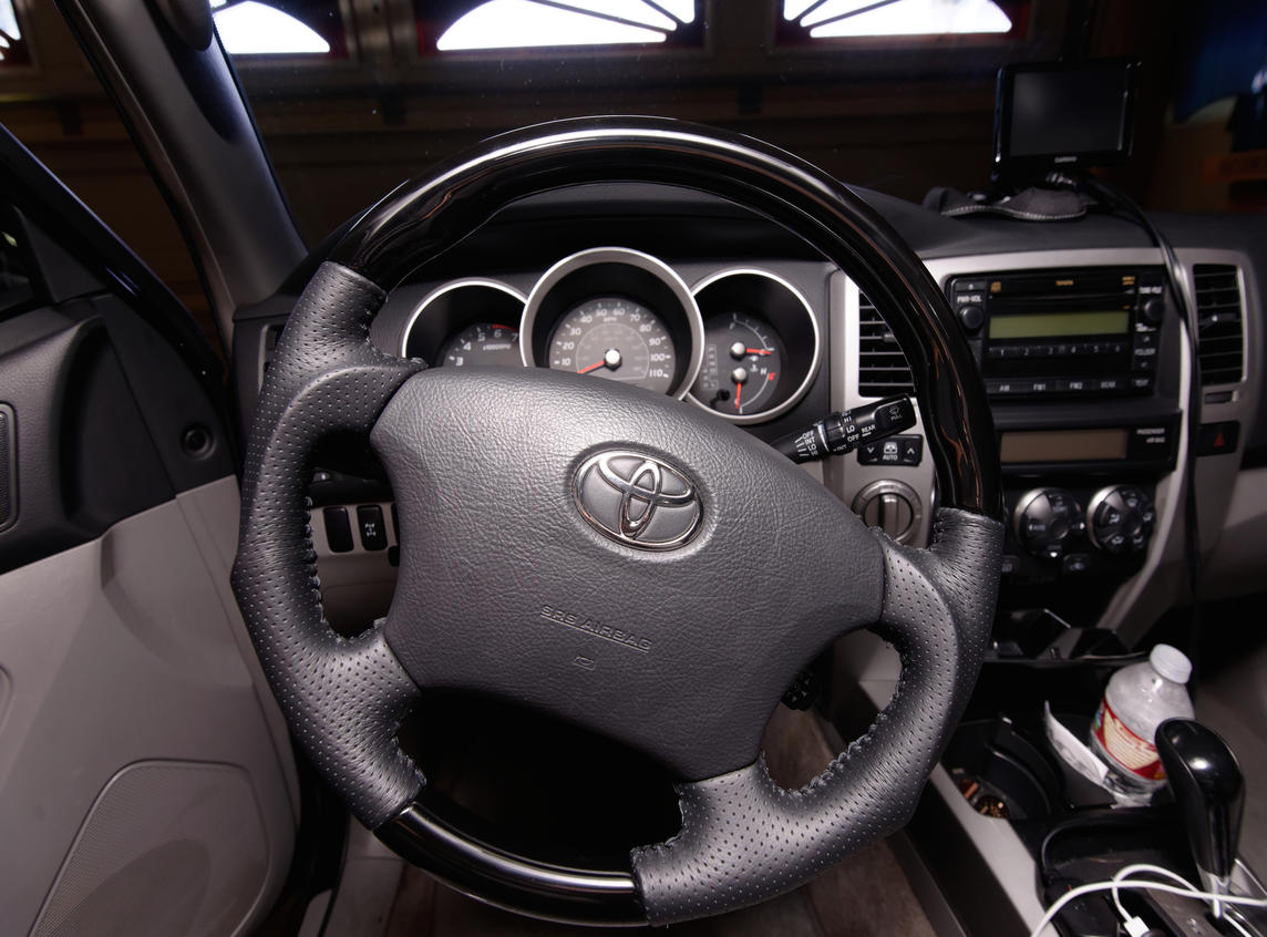

Pulled the wheel out and snapped a couple pics. This is a wheel for a Lexus GX470, I really like the wood color. It's not piano black, but it's like a black tinted burlwood depending on how the light hits it. Definitely a classy wheel and I'm gonna get the Lexus shift knob to match. I got this wheel from a seller in the states for $200 shipped. I really wanted the black perforated leather instead of the light gray with thumb notches.
Here's a few pics

Beautiful wheel!! You still have those thumb notches, just not as prevalent as ours. OEM............ can NEVER go wrong with that! I got a matching "Piano Black" shifter knob to match the wheel from a Lexus (somewhere in CA) on fleabay. Figured, "Why the hell not?"
Yeah, I like the thumb bumps, but not the crazy over-exaggerated ones on the other wheel. I'm quite happy with this wheel.

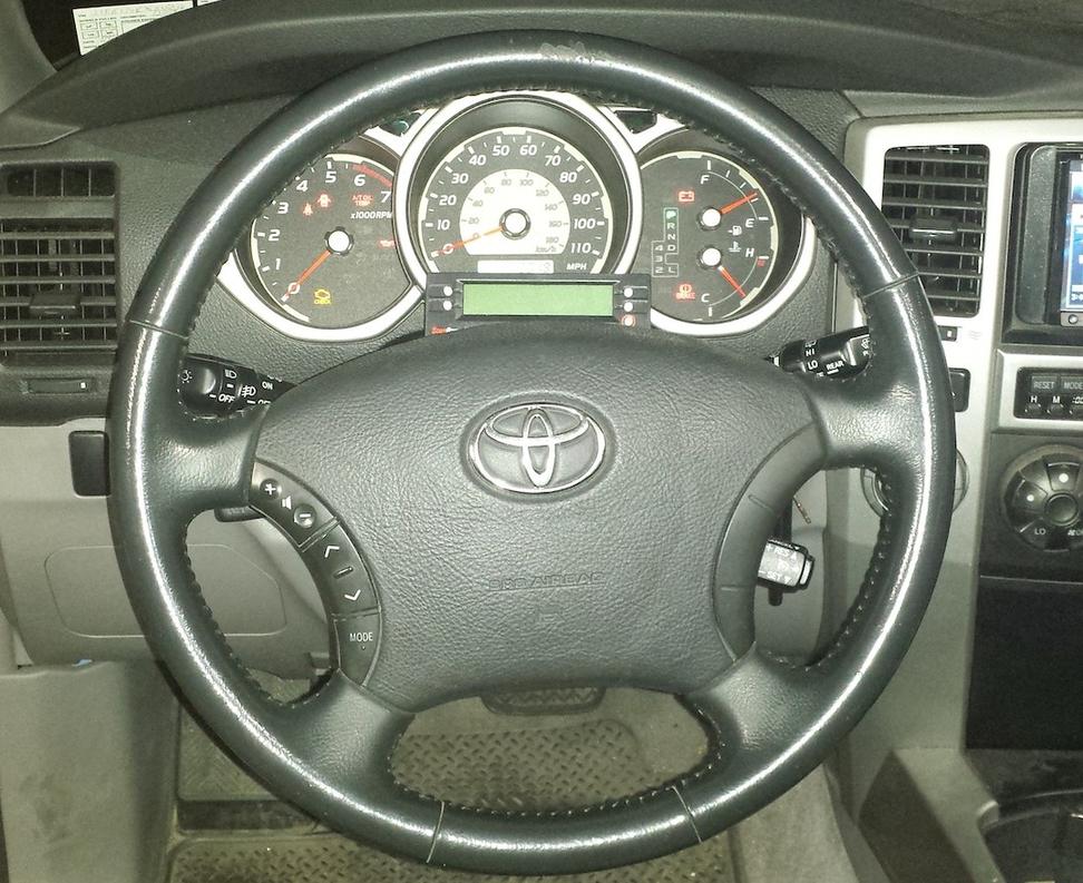

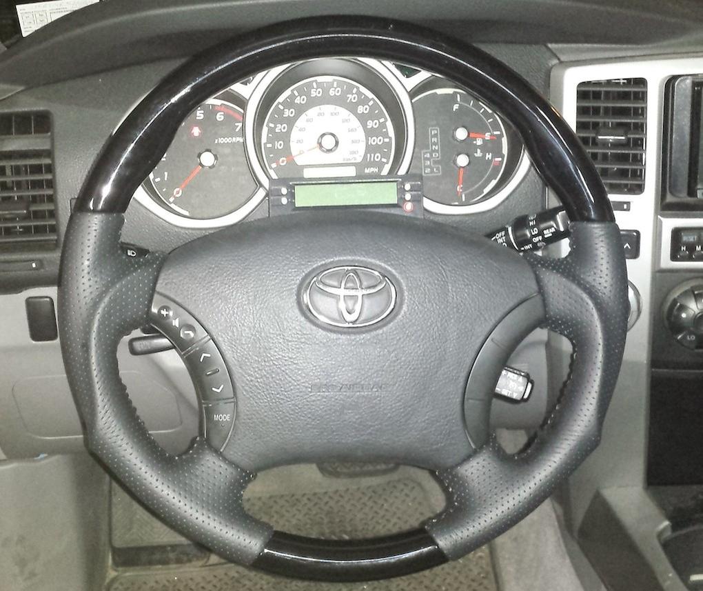

So all done here and it looks and feels great! Definitely a little nerve-wracking dealing with the airbag but it is simple enough (I also looked up the disarm/arm information within Alldata to make me feel a little more at ease).
I haven't posted photos here in a very long time to attempting it now. Attached has the original wheel to start followed by the replacement installed.
To address the rubbing that some people have noticed... the bottom of the rear shield is a HUGE pain. The original instructions stating there is a bit of trimming is an understatement :). It took me probably about 45-60 minutes to trim it well enough to get the shield to clip on enough that it didn't look like it would just pop off. If you take your time, trim it and get the clips to hold it in place you should not have any issues with rubbing at all. I had to trim the pads on the wheel itself AND the edges of the shield as the leather on the steering wheel was hitting the shield at the edges. All I can say is TAKE YOUR TIME and grab a flashlight and a very good sharp knife. Take a little off, test it, take more off, repeat. I didn't get a side shot of mine tonight but I will grab one in the morning.

Nope not noticeable at all for me. I trimmed the edges only and on an angle so the outside portion was not really modified. The leather on the wheel was what was stopping the shield from attaching so I trimmed the shields edges where it was being blocked by the leather.
