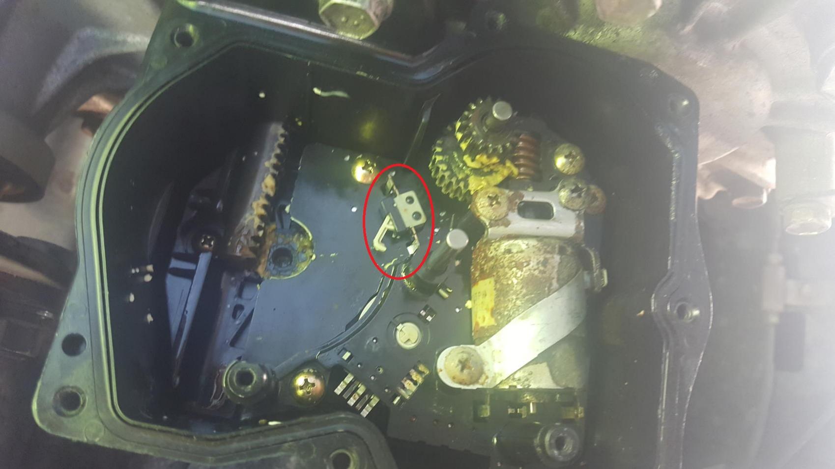

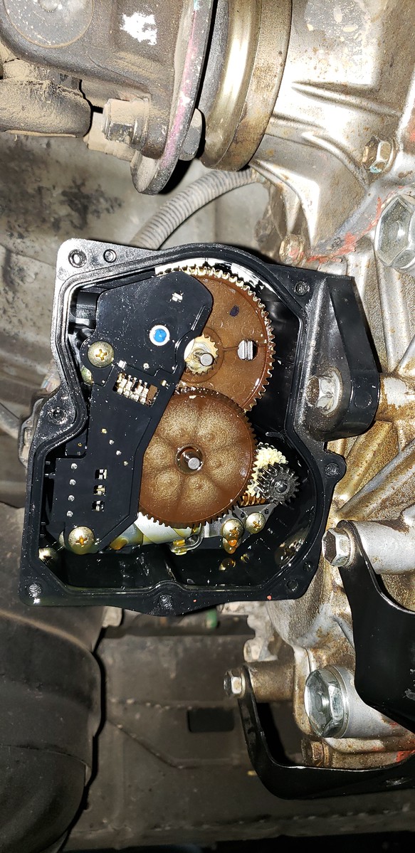

1st pic - You can still see the corrosion on the DC motor and this was after cleaning several times. Underneath is the 4Lo gears and position switch (white half moon). 4Hi shift rod in on the left.
2nd pic - "Before" As it came off the line.
3rd pic - shift rod fully in (2Hi)
4th pic - Position switch in place w/o gears
5th pic - Where the screwdriver goes to free the DC motor
6th pic - Close-up of the metal gear. The "flat" of the metal wheel is where the "floor/ white armed" position switch goes. That is for people who are stuck in 4Hi and won't have 2Hi timing marks.
7th pic - My markings on the big gear. I used the tab on the side of the case so I only had to mark the gear and it was easy to see.

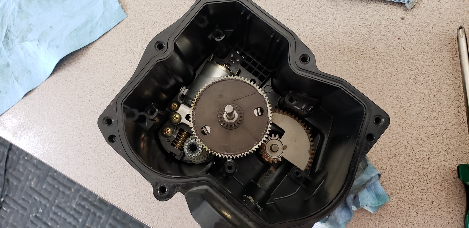

Here's my story with the actuator issues thus far.
4th of July weekend, I did an overnight camping trip up to the mountains in the 4Runner. Mine is an 03 V8 4wd, so full time 4wd with center diff lock. 4lo and center diff were working that friday and for about 5 minutes the following Saturday morning. Then they stopped and it wouldn't engage 4lo any longer. I gave up and started the trek home. Well, the 4Lo indicator light on the dash started flashing at me and wouldn't turn off. 4hi was still working fine so I was able to get home without issue.
I get home and Sunday, I popped the cover off the actuator housing and have about 1/2 quart of gear oil dump on me. So, I knew the shaft seals were shot, or at least one of them. Ordered up new seals and o-ring and received them this past Friday.

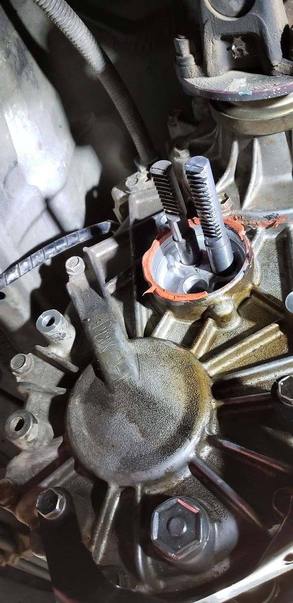

Crawled under the truck today and pulled the actuator housing off the t-case so I could clean it up and replace the shaft seals and o-ring. Come to find out, the hole for the diff lock seal is cracked in 2 places and the "cap" that holds the o-ring in place is also broken. So none of that is going to help now, I have to replace the actuator. Yay me!

This was right after pulling the cover and having gear oil dump on me.

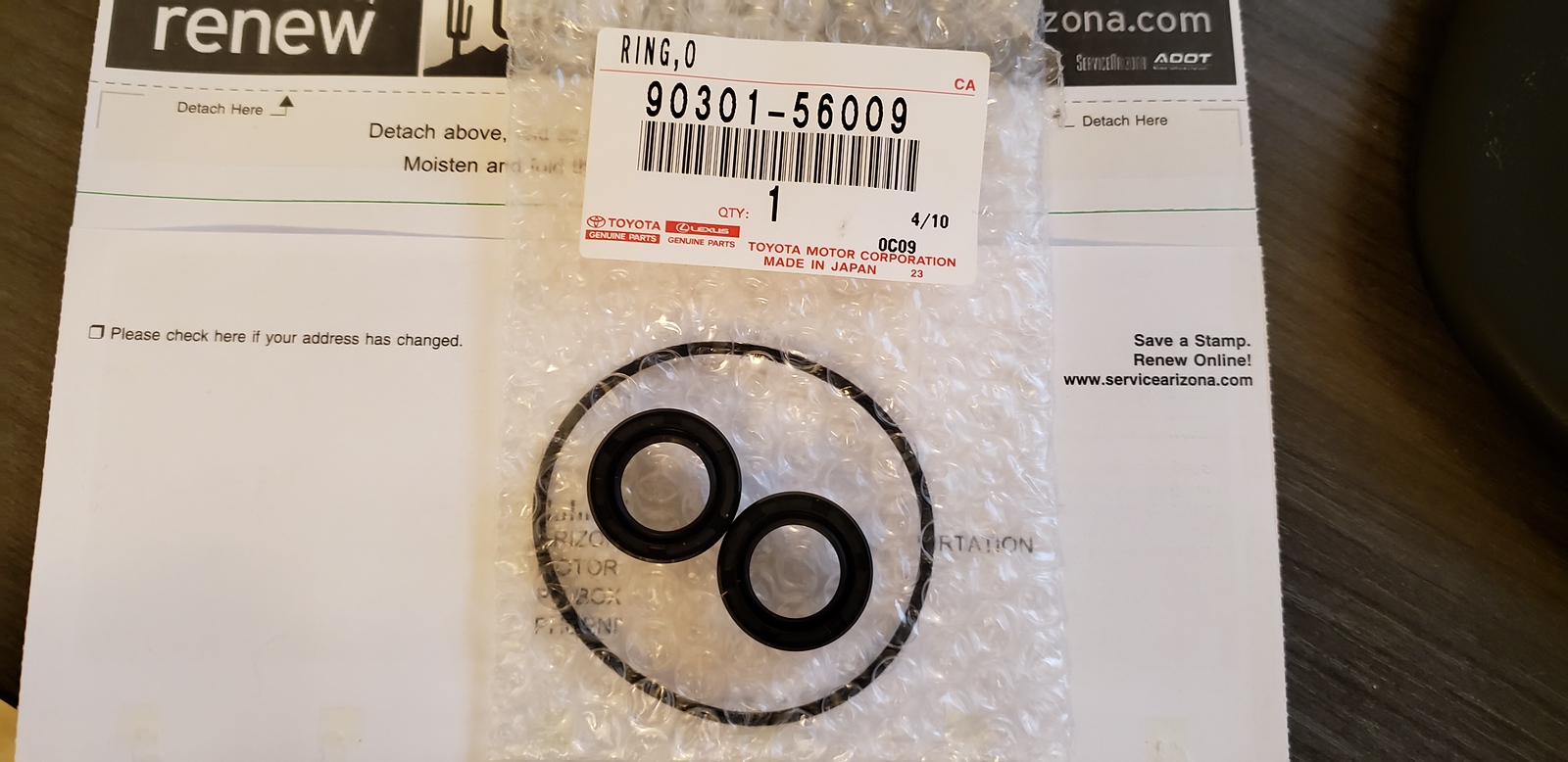

New seals and o-ring. O-ring is a Toyota part and the shaft seals are these - Shaft Oil Seals TC15x23x7

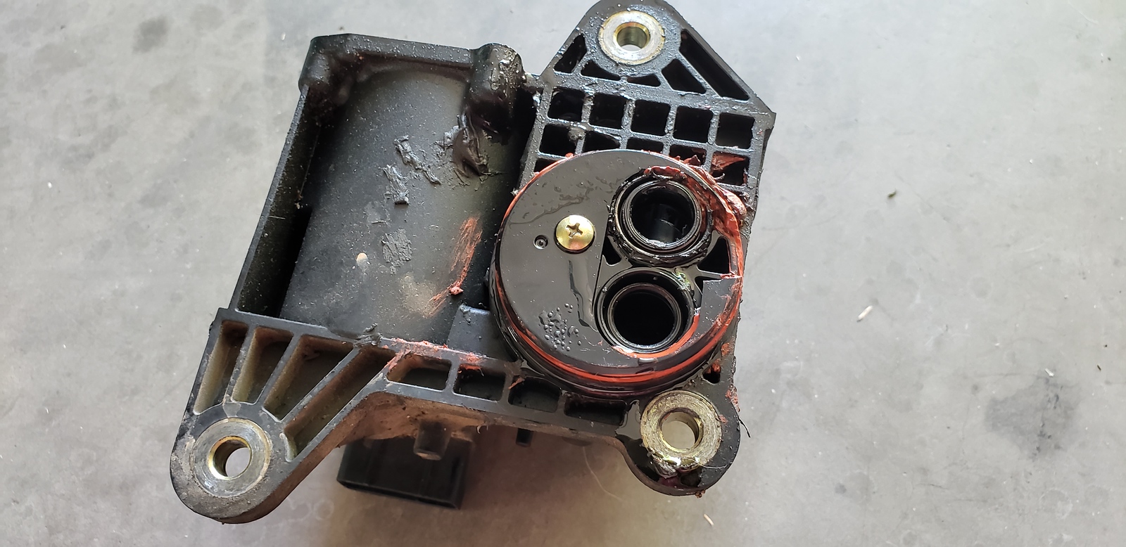

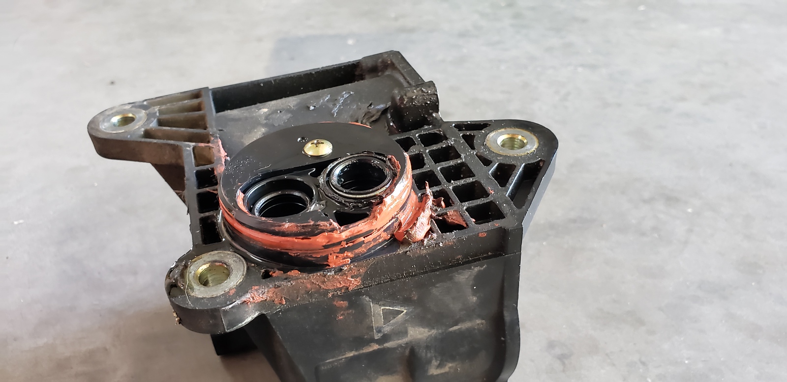

Actuator housing removed. The orange RTV is from a previous bandaid fix by the PO.
And the actuator where the shafts go into it and seal to the t-case.

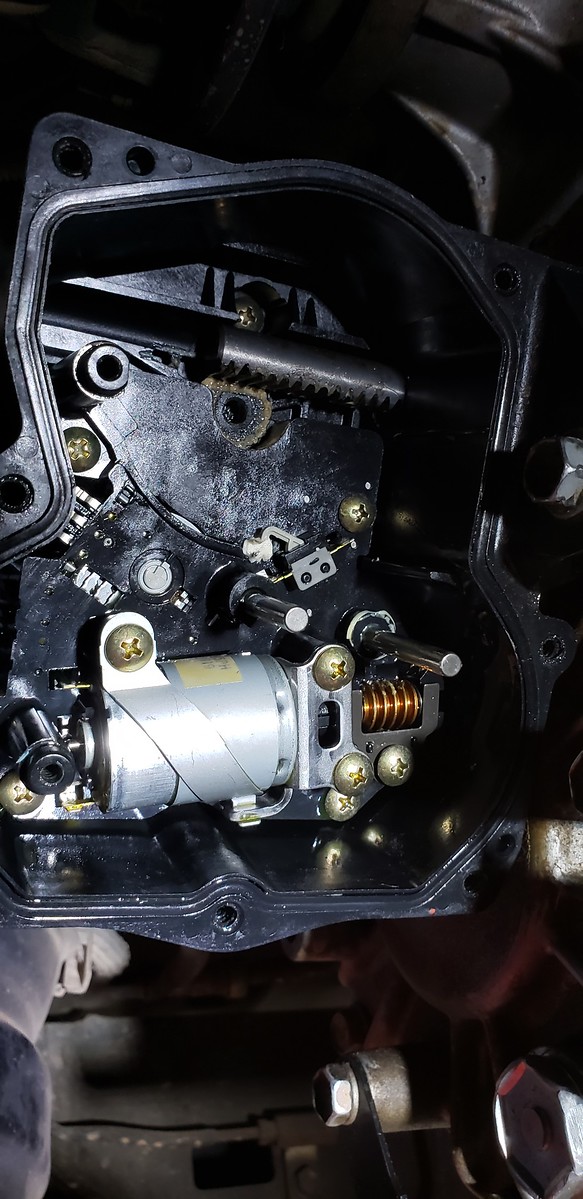

4Lo gears and motor. These were still dry since the diff lock gears and motor actually sit lower when on the t-case. The metal gear is what engages the shift shaft for 4Lo and is in the "park" position from pulling the actuator off the t-case.

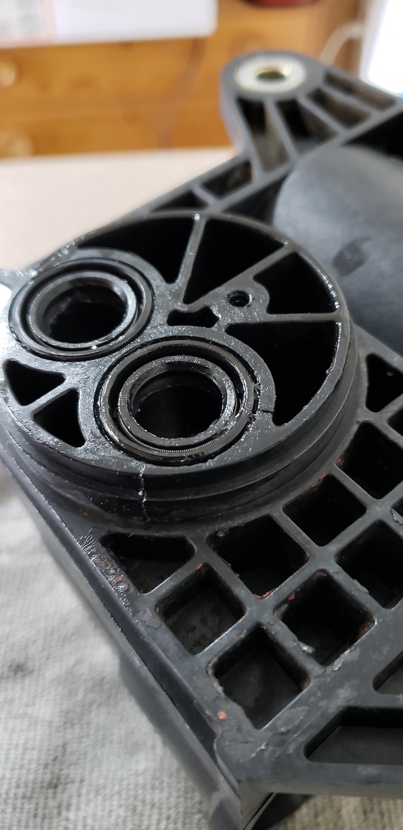

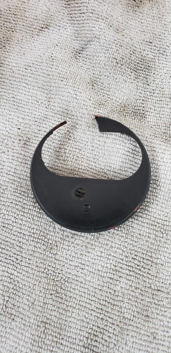

This is the broken shift shaft seal retainer/o-ring retainer.
I didn't notice the cracked housing until I had cleaned up the empty housing and put the new seals in place. New seals and o-ring still won't fix this leak and explains all the orange RTV that was used.
