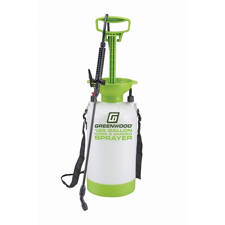

You guys going to laugh at me, but this is what I used and it only took 3 mins. Change ATF every 15-20k and yes, it does shift crisper every time its change. Keep the reddish pinkish color is key.
1st - Do a drain and fill. New ATF in the pan.
2nd - Remove spray nozzle and replace with 1/4" shutoff valve to return line.
3rd - Send line drain into 2 gallon bucket.
4th - Fill up sprayer bottle with 1 gallon ATF. Start pumping to add pressure.
5th - Start engine, open valve to return line, keep on pumping until clean ATF.
6th - Turn off engine. reattach hoses, check dipstick. Usually about 1/2 qt shy. Add and you're good to go.
