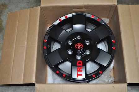

what do you think about doing this?

^^ to much flash in my opinion, but to each his own. if you like it, rock it!
thats what i was thinking after looking at it... i like the red toyota and trd though, i drew it out and looks better witht he real trd logo. but not doing the dots
