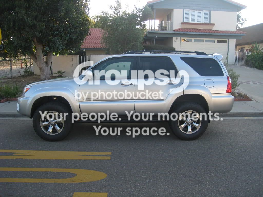

I have an 07 with the Cornfed 3/2. Mine ended up with the rear still slightly higher than the front - 3/4 inch to be exact.
Cornfed 3/2 Lift. Spidertrax wheel spacers, Michelin LTX A/T2 275/65/18 with XREAS preserved. Note this tire size required some front trimming work (http://www.top4runners.com/ja/2007/wheelspacers.html) as well as an alignment with positive caster adjustment so the rear of the front tires would not rub the frame. I like it.
Cornfed 3/2 Lift. Spidertrax wheel spacers, Michelin LTX A/T2 275/65/18 with XREAS preserved. Note this tire size required some front trimming work (Toyota 4Runner Wheel Spacers) as well as an alignment with positive caster adjustment so the rear of the front tires would not rub the frame. I like it.
