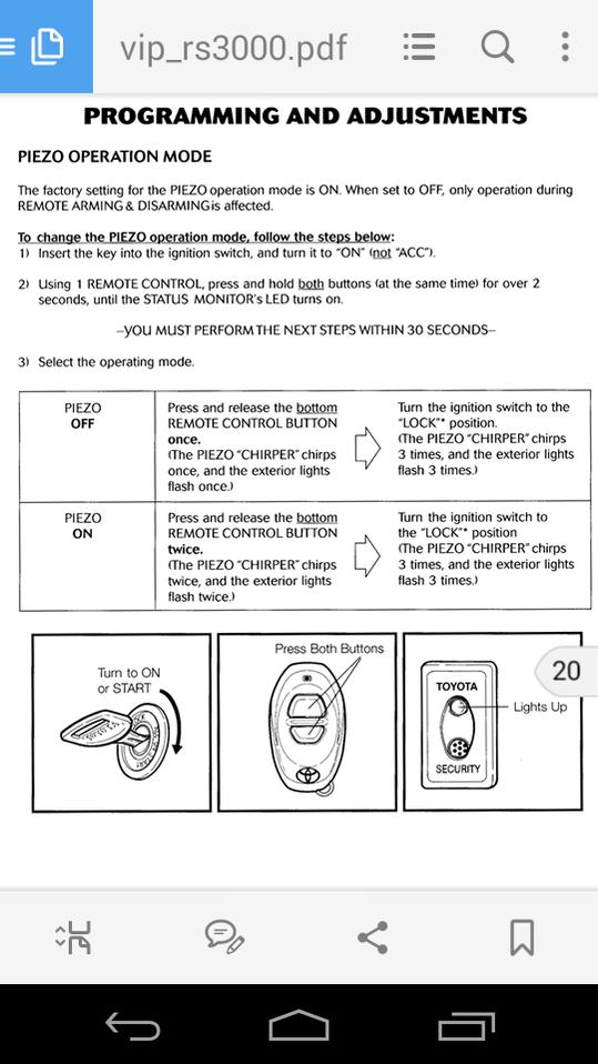

If you look at the document I posted upthread all is made clear.
Prior to '99, there was no standalone keyless entry; it only came as part of the dealer add-on RS3000 alarm system.
1998 takes a grey fob. 1997 earlier takes a black fob. They are not compatible.

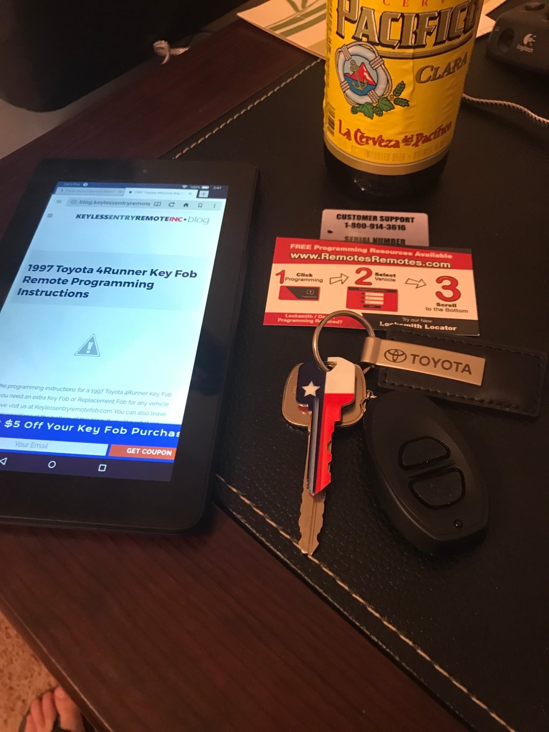

Well it works! [MENTION=19524]XJeepguy[/MENTION] [MENTION=154296]nchacon1984[/MENTION]
So I followed the procedures as outlined on "KeylessEntryRemoteInc.blog"
My first attempt did not work. So I went to the second step and erased all prior FOB memory and then restarted with Step 1. After that it worked, well kind of.
I don't have a chirp and I'm not sure how to even get one, but it's not that big of deal. Additionally, the two button FOB only works with 1 button. Same button locks and unlocks. Press once to lock and press again to unlock. There is not an audible tone and I was so excited that it even worked, I didn't even check to see if the lights flash. Bottom line, is for $30 I can now lock/unlock my vehicle from a distance and that's all I wanted.
The chirp would be helpful and it would also make sense to have the lower button work, but whatever. Maybe someone can "chime" in and help me out. (no pun intended)
Your second button is for if you own a second 4 runner with the same system. Weird I know but that's what it's for. The piezio chirper is a setting that you can program on or off with the rs3000.
Have you checked your peizio chirper? If I remember correctly it's located in the engine bay on the passenger firewall or close by that corner.

I'm pretty sure the piezio module it's a separate little Gizmo under the hood. It has wires running to it. It's possible that the wires are cut or damaged or the piezio itself is damaged.
Correction...'99 and up the piezo is on the pass. side fender, '96-'98 is on the drivers side hidden near the fuse box. Look for a small red cylinder wrapped with grey foam.
