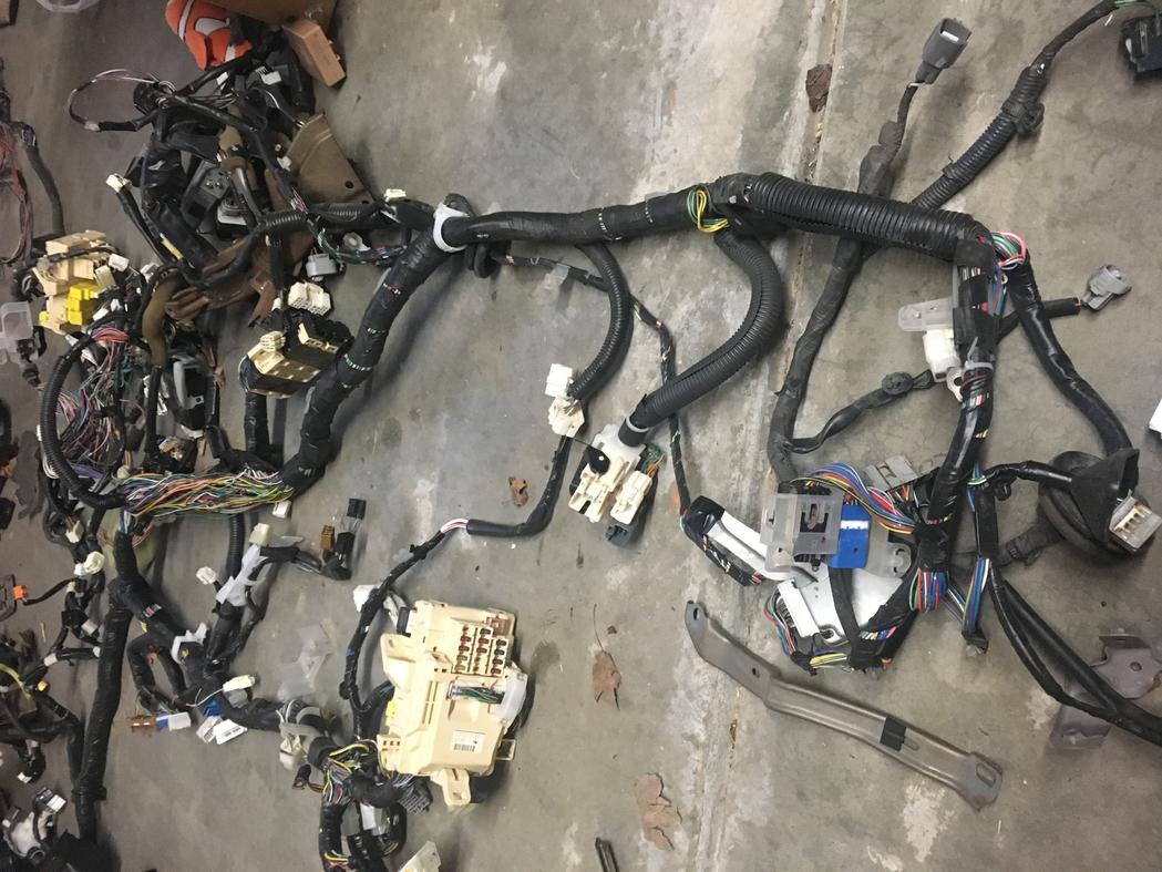

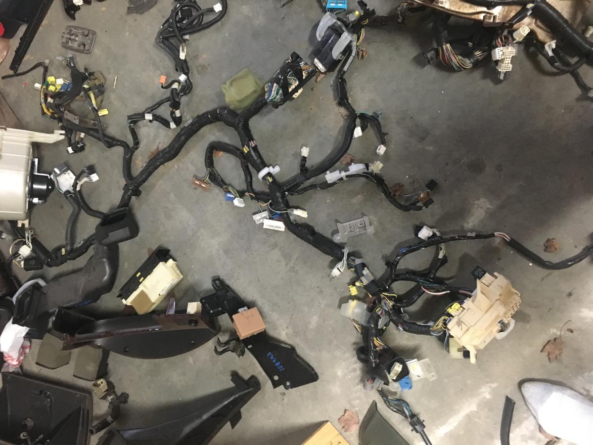

I have a 1996 4Runner that came with the RS3000. The alarm was screwy to begin with coupled by the fact that I am not an RS3000 fan so I 86ed it and repaired (resheathed) the factory harness. I would like to add a factory installed keyless entry system from a 1999 - 2002 and I question what parts I'd need from the salvage yard.

The '99+ system is completely integrated into the harness. It requires much more than you might be thinking... (all the stuff in the rear hatch, main body harness, the dash harness, fuse box(es), etc.)
I would suggest aftermarket...

Too easy drill sergeant;):

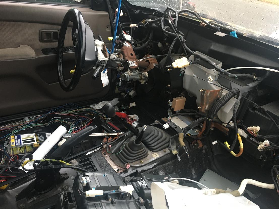

I am actually in the process of doing the auto AC and diff locker conversion (down time while on leave). I have two wiring harness already. One from a 1997 and one from a 1999. I am just thinking before I button it up, that I may have the necessary harness wire - I would just need the appropriate modules.
