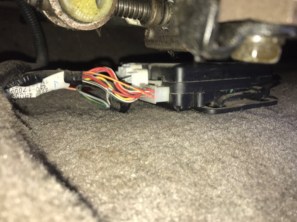

No point in making a new thread. I got my truck used with one metal key. Is this the dealer installed keyless entry on my 97 Limited? So I can just purchase a replacement FOB and then recode it?
Photo taken under driver seat.

As these were dealer or port add-ons in '97, they can't get that from the VIN. All were built without in '97.
That is where the keyless was on the early trucks... Along with a bunch of wires tapped under the dash. I believe it uses a different fob than the later ones, so make sure you get the right one! And hopefully it is programmable to the new fob.

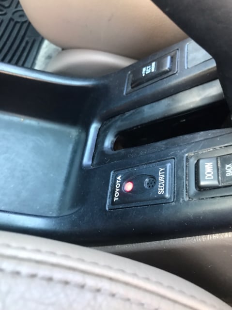

The instructions for the RS3000 dealer installed keyless entry seem to be on par with what I'm seeing. Additionally, when I press the green reset button, the Toyota Security light activates near the E-Break.

Hi . Do you have a picture of the security light that's by your E Brake ? That sounds like where they placed mine originally .

Yes. Here's the box which is under the drivers seat.
When you press the green button this occurs on the security light near the e-break
According the the link I posted before, I've got the dealer installed RS3000 and I just completed the "reset" procedures. All that I'm missing is the key fob.

Yeah that looks like a 3000 for sure . My light is mounted in the same spot but totally different . My FOB disintegrated and there was no brand name or FCC number on it which makes it a task to replace. I have yet to find my box :puke:
I just want the door locks and windows to operate through the FOB again . Don't care about the alarm .

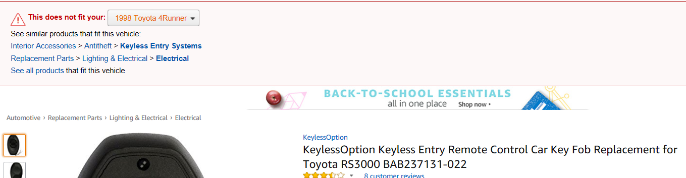

for some reason that FOB isn't compatible to a 98 4Runner, just 97 4Runners.
going to take a look at the box when I get home. hopefully the information is incorrect and it is compatible. Also, will this work with lowering the windows and unlocking the doors cause that would be awesome if it does or just unlocking the doors.
