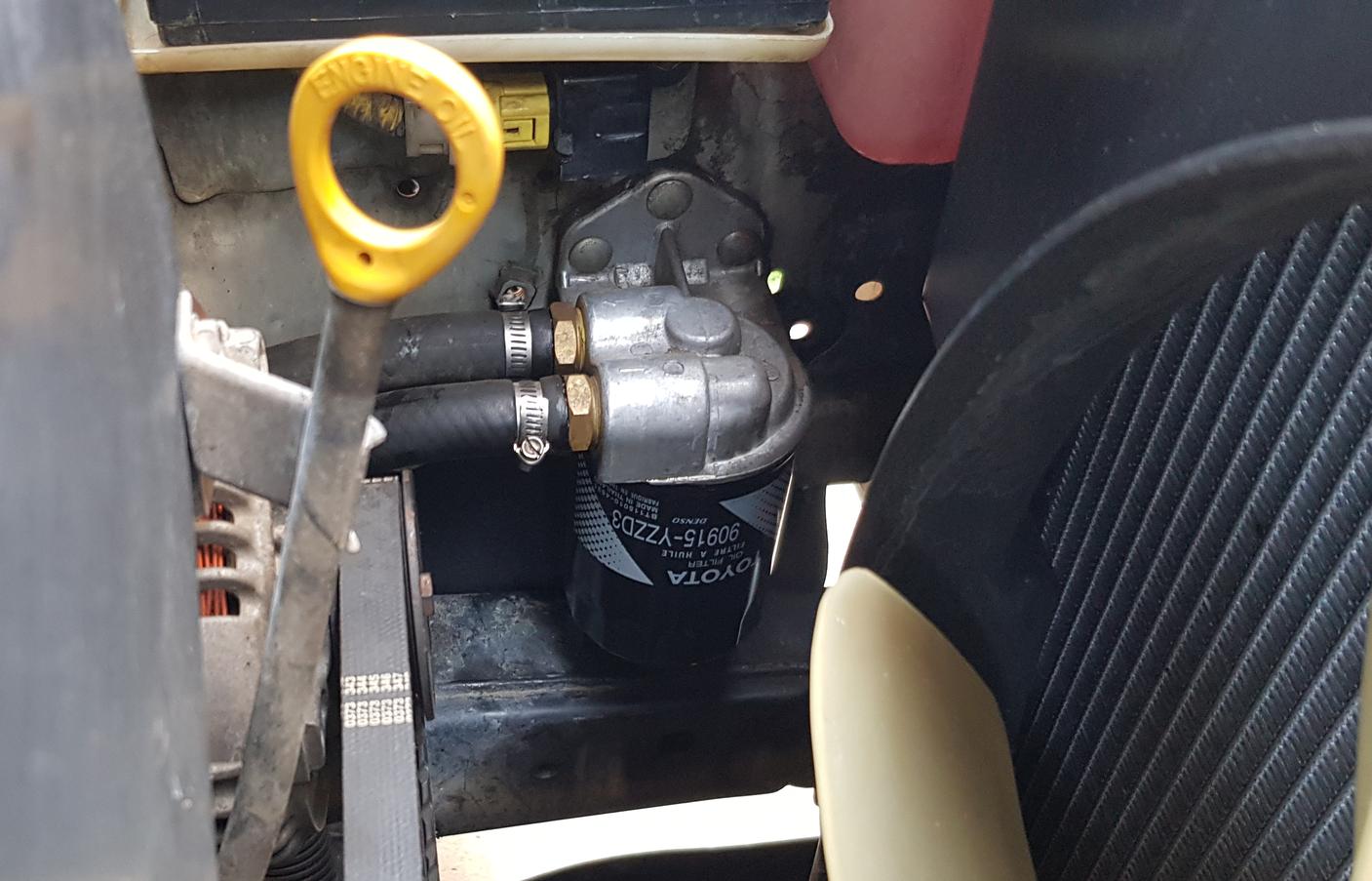

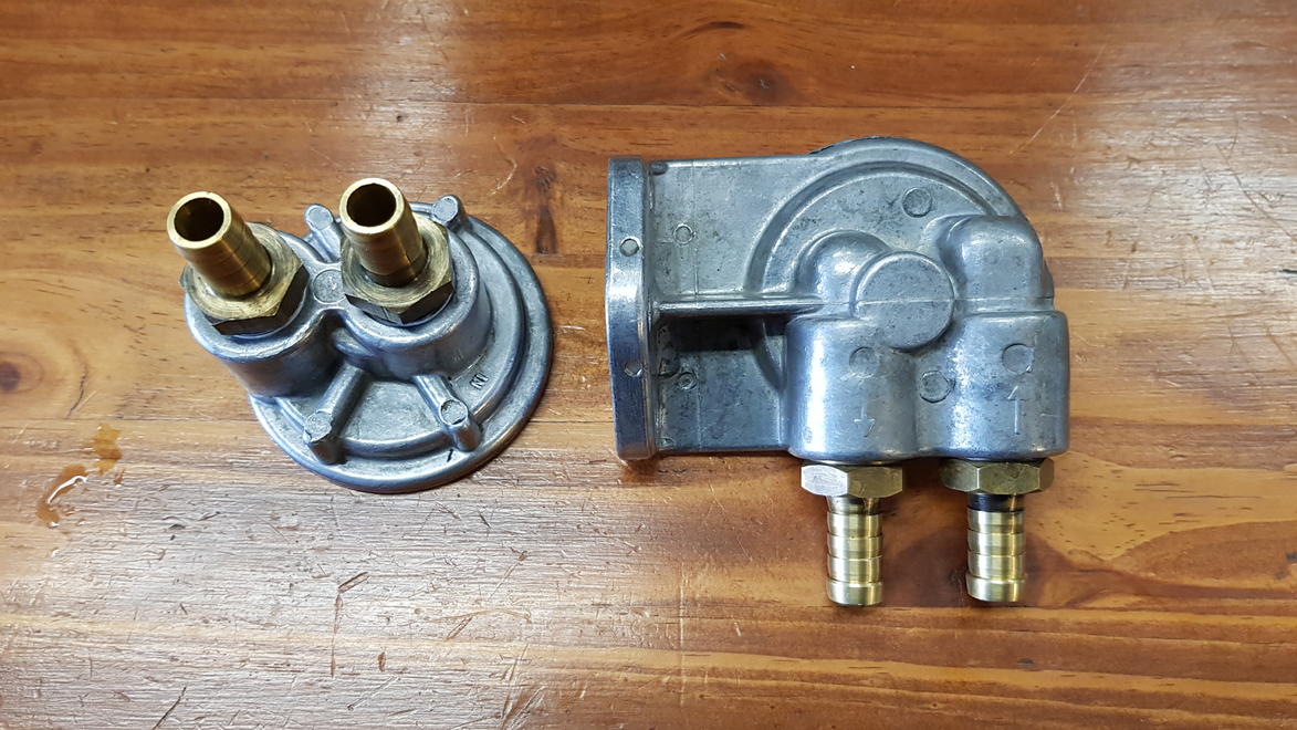

I'm spoiled, I have a oil filter relocator. :)
Really easy to install & for the cost well worth the convenience.
I have a 1st gen Tacoma but basically the same.

Hey where u get that kit from?

Where did you get the kit from, please.

Do you have a link to the kit? Been meaning to do this for awhile.
They make kits but I didn't use one. There's even fancy expensive CNC machined mounts but my truck is not a race truck. :)
I bought the filter adapter & remote mount individually cause I wanted a certain configuration for the remote mount. Mine is made by Permacool. It's been a long time but IIRC I purchased from Summit. Bought the NPT fittings at Lowes & 1/2" oil hose at Summit also. Be sure not to use heater hose.
I used PC#111 & PC#1701
You can see the other configurations on Permacool's website. Derale also makes similar adapters & mounts, I believe all the usual performance shops like Summit, Jegs, etc sells them too. Looks like Amazon carries it too now if you got Prime.
Edit: Oh forgot to mention, it'll add a bit of oil capacity too. I use 6.5qts for oil change. I just recently got Total Chaos shock bucket gussets installed so I had to reroute my oil lines. So if you are considering installing this & get the TC gussets too, probably best to get the gussets installed first. It was time to replace my lines anyway. I like to replaced them every 4-5 yrs or so.

cool thanks, yea I have seen tons of them all over I was just curios since you had been running yours for a while. Right now I'm running 2 oil filters, 1 in the normal spot and 1 where the oil cooler would be. I have oil pressure for days, the oil cooler seems to add about 5psi of resistance.
I installed an older salvage engine so for a while I will run 2 filters and change oil a bit more often in hopes to get any crud out.
thanks for the info
